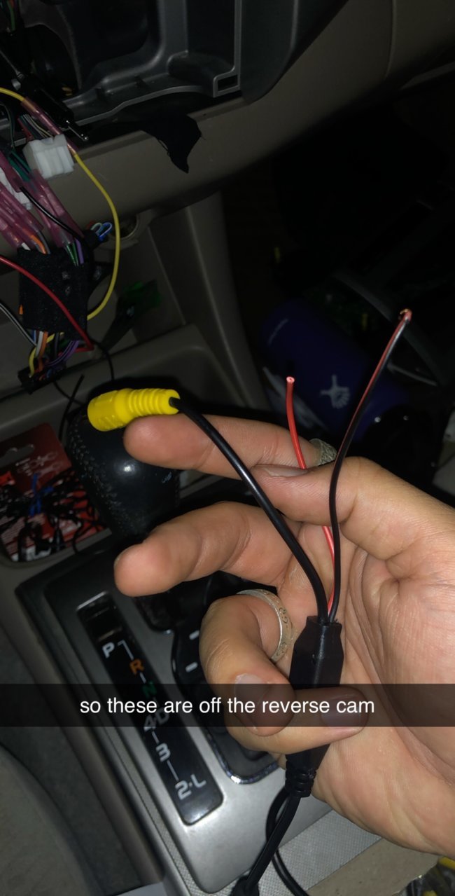

    Update: Installed the stereo no problem and it worked perfectly. When we tried to install the backup camera things got ugly. At first we crimped the wires and got it working when I pressed the camera button on the stereo, however when we put the truck into reverse the camera did not turn on automatically so we tried to redo it. Now, we seem to have broken the entire stereo as it will not turn on at all, even if we take the reverse camera out of the picture and wire it the way it was when it was working fine. Getting it checked out by a friends dad who happens to be an electrician and if he can't fix it, I will be exchanging it for a new one under the Crutchfield warranty and get it professionally done.

    I’m going to guess you were wiring stuff with the battery connected and you popped a fuse.
    Sounds like you just needed to figure out the reverse detection wiring but you had the cam wired fine.

    1st one I would check is the one on the stereo . Located were you plug in the main connector . Then Radio fuse and the rest if not the one on the stereo . Hopefully the one on the stereo is the one that blew . The camera pos. should be hooked up to rev lite pos. Also stereo rev detect wire should also be hooked up to rev lite pos.

    Pic of fuse if you dont see it .Yours should be same

    Just got done checking it out today. So we checked all the fuse on the stereo and it was still good and checked all the fuses in both fuse boxes in the truck. We also double checked all wiring for the stereo and everything is still good. The only thing we can think of is we must have shorted something inside the stereo when we messed up.
    We couldn't figure out how to get the camera to turn on automatically when the truck was put into reverse and we thought the purple reverse wire on the stereo had to be spliced to something. We spliced that purple wire onto the red wire coming out of the reverse cam in hopes that would solve the problem (previously we had doubled the blacks and reds onto the stereo) but instead it glitched out and stopped working.
    I hope to get a new one from Crutchfield but I'm not sure if they'll honor the warranty since it was my fault. In the case that I do get a replacement, how would I go about wiring it so that the reverse cam works properly?

    Did you verify this stuff using a multimeter, or eyeball method? Do you still have +12VDC on the yellow wire? When ACC is on, do you have +12VDC on the red wire? I'm referring to the power going into the stereo. I wouldn't jump to any conclusions unless you have these voltages.

    Yea check to make sure you have battery voltage at yellow and red wire first. Also make sure you have a good ground .Put neg probe on stereo ground wire terminal. The purple wire is for rev detection so hooking it up to camera rev pos wire shouldn't have shorted it out . Talk with crutchfield .They will help you out .I plan on putting camera in front since I already have rear view camera in my mirror . Plan on just hooking it up to a switch
    Good luck .
    Notice you using heat shrink connectors .Heat it up so shrinks on wire . Will make it less likely wires can pull out .

    Used a multimeter. I'll double check to see if I have +12VDC on both wires.

    Yea make sure you got good ground also . I looked at my camera today ( boyo vtl17irt ) and the back were you plug into camera got a red and a black wire .Red is positive reverse light lead and black ground . Up front with yellow rca plug I only got a red .That red gets bat voltage from the red rear wire thats hooked up to reverse light .Mine doesn't have that other black red stripe wire . I assume it is a ground? Better to call crutchfield to make sure .Also my unit is the ddx396 . The camera is programable .Can have it working when shifting into reverse or off .I thing yours should be programable too.
