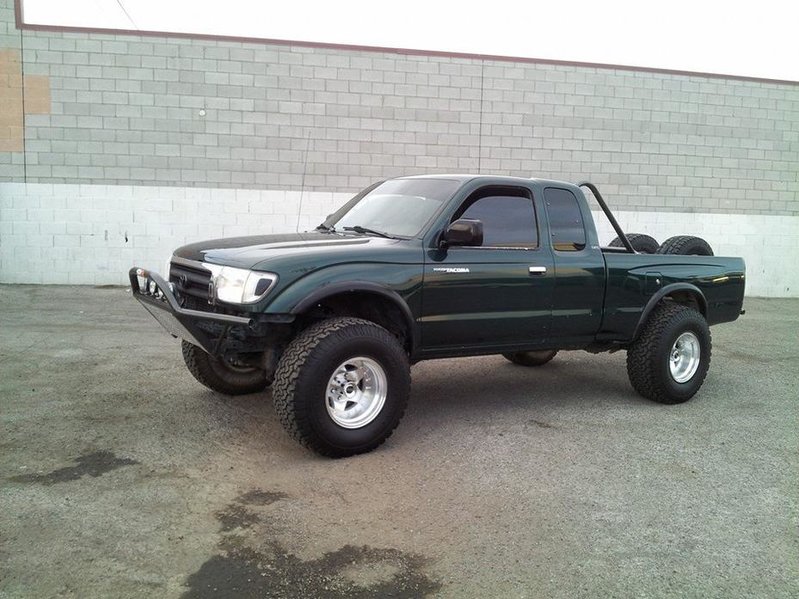

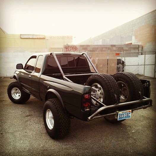

    2000 tacoma 4x4 5speed caged FOX shocks
    2.5" bypass remote resevoir FOX shocks(front), caged(almost done) stage 3 clutch, cold air intake, flowmaster dump, 33x12.5 BFG A/T tires, 15x10" american racing rims, touchscreen dvd player with gps, 2 12" subs with 1000 watt amp n capacitor
    sorry about your pops, but welcome to TW.

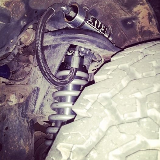

    from my experience, the first, most effective, best upgrade for your truck is suspension. FOX has an application that will bolt right up to your stock set up for $1500 (if you shop it right). They are 2.5" bypass remote resevoir coilovers and come set for a 2" above factory preload(lift). I bought these for my truck and had them installed in under 2 hours. the difference in performance was unbelievable. i used to be cautious and slow when entering a trail here in vegas, now i just pull off into the dirt and floor it. so i definetly wouldnt waste my money on knock off brands or lift kits like rough country or sky jacker blah blah blah. by fox, the quality and performance is seriously worth the investment.
    p.s. replace sway bar bushings and grease everything while you got our wheels off. theyre gona need it to keep up with these shocks when your rompin
