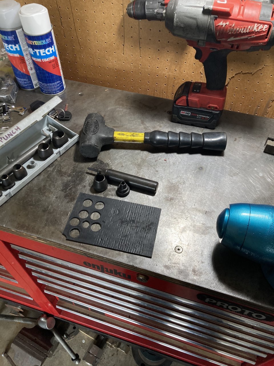

    Not sure if this has been covered before, but I came up with sort of a fix, well not so much a fix but more of an improvement to remedy some of the awful sounds that the 6MT makes. For anyone not aware, the 6MT makes some noise when driving over bumps in neutral or with the clutch in; kinda sounds like banging two frying pans together. The dealer will tell you it's a "normal" noise along with some people on this forum who will say "it's a truck, It drives and sounds like a truck" Which is crazy talk to me, I think these "trucks" drive like Cadillac's compared to most pickups.
    "Normal" is fine and all, but I still hate it.... Just my opinion but this brand new truck shouldn't make more noise than my '86 F350 did.

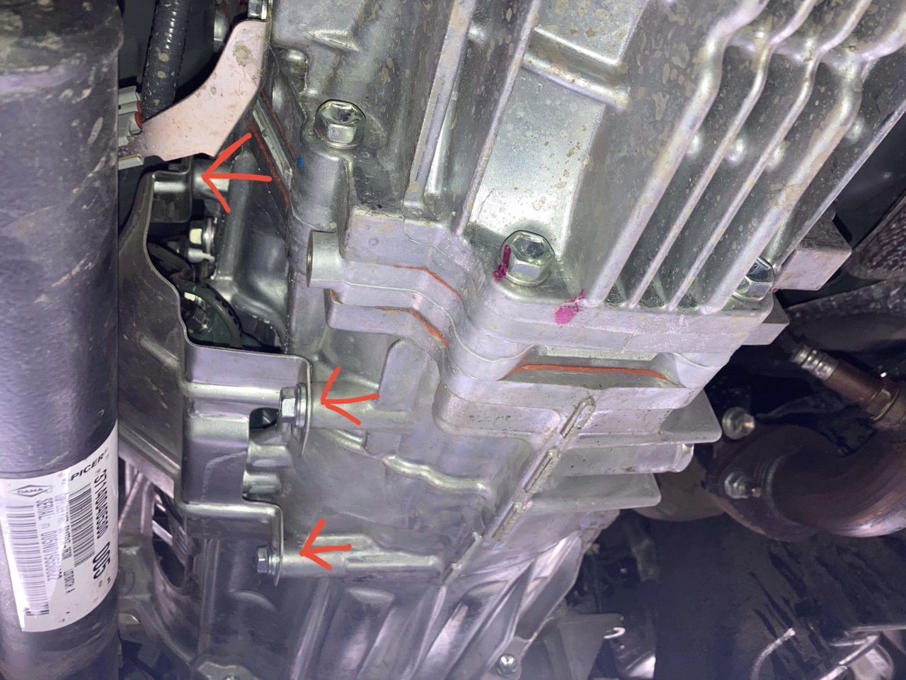

    Anyway, I found that the heat shield for the accumulator and slave cylinder causes some resonance with the transmission resulting in that sound of banging pans together. Obviously Toyota put the shield there for a reason so we can't just eliminate it all together. The fix is simple though; isolate and dampen the connection between the shield and the trans.

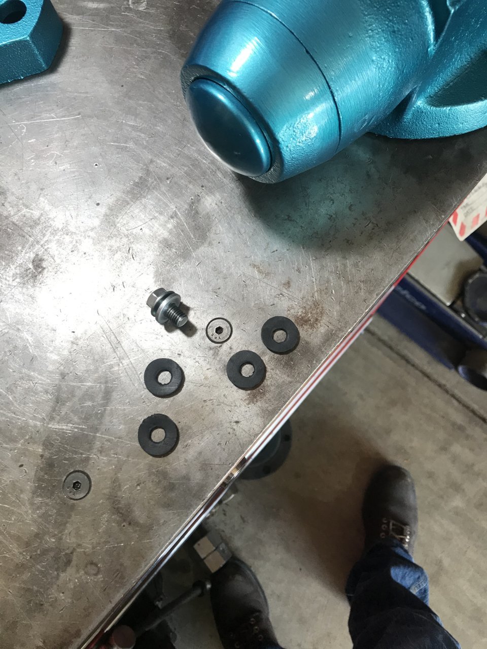

    I used some BUNA-N gasket material I had and a gasket punch to make some rubber washers. Any medium-hard durometer rubber would be fine, the stuff I used is 60A on the hardness scale. Or buy some 1/8" thick 5/16"ish ID 3/4"ish OD rubber washers.

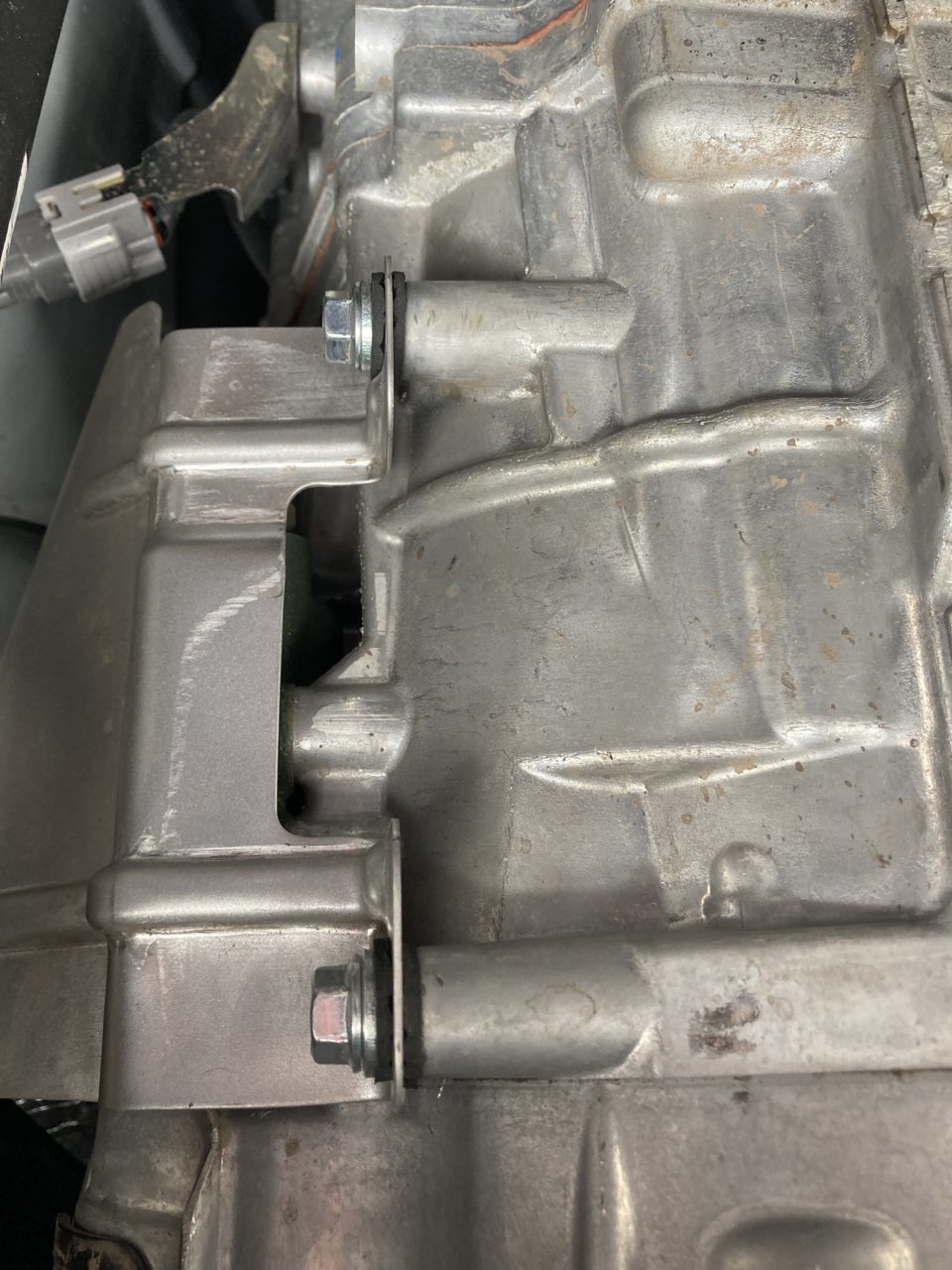

    Basically all I did was sandwich a rubber washer between the bolt head and the heat shield and then another one between the heat shield and the tranny. I then put some purple locktite on the bolts and snugged them up, blue loctite is fine too. Don't go too tight, we want the rubber to do most of the work holding the heat shield tight. I only did three of the four mounting points and it seemed to do the trick for me. This won't get rid of all the noises from the trans, just the metallic pots and pans noises. Enjoy your somewhat quieter Tacoma.
