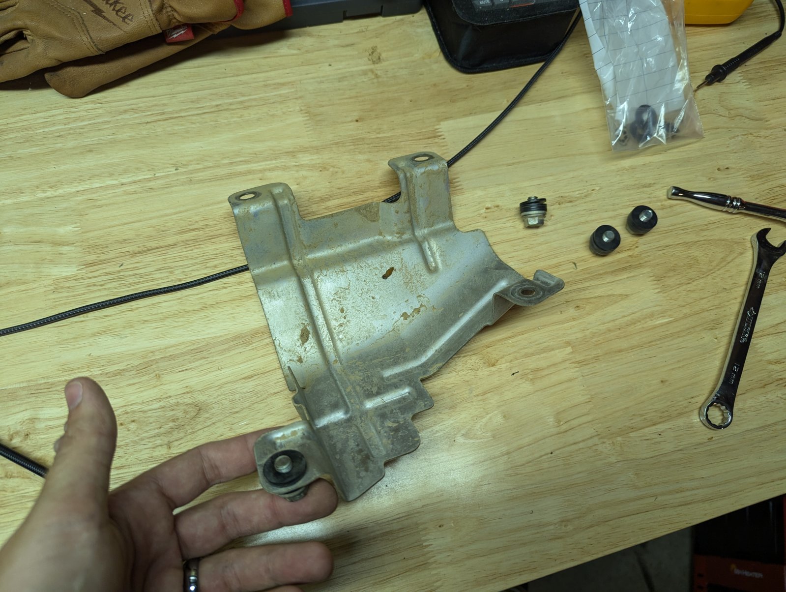

    Oh you removed it when you did the accumulator bypass? No ill-effects you've seen from removing it?

    Nope. And I do drive some rocky roads and such. The hose is not really that close to the shaft.

    Well the results are promising. Took the heat shield off and it still makes some noise but it seems to be much less. Gonna leave it off to do the clutch accumulator delete early next week, so I'll get a feel for whether or not it truly went away driving it between now and then with the shield off.
    Went to Ace and got some 1/16" thick, 5/16" ID, 3/4" OD neoprene washers. Stacking them to what should be 1/8" (but it felt more like 1/4") seemed a little thick - might just go with one 1/16" washer on either side of the fastener instead of two.

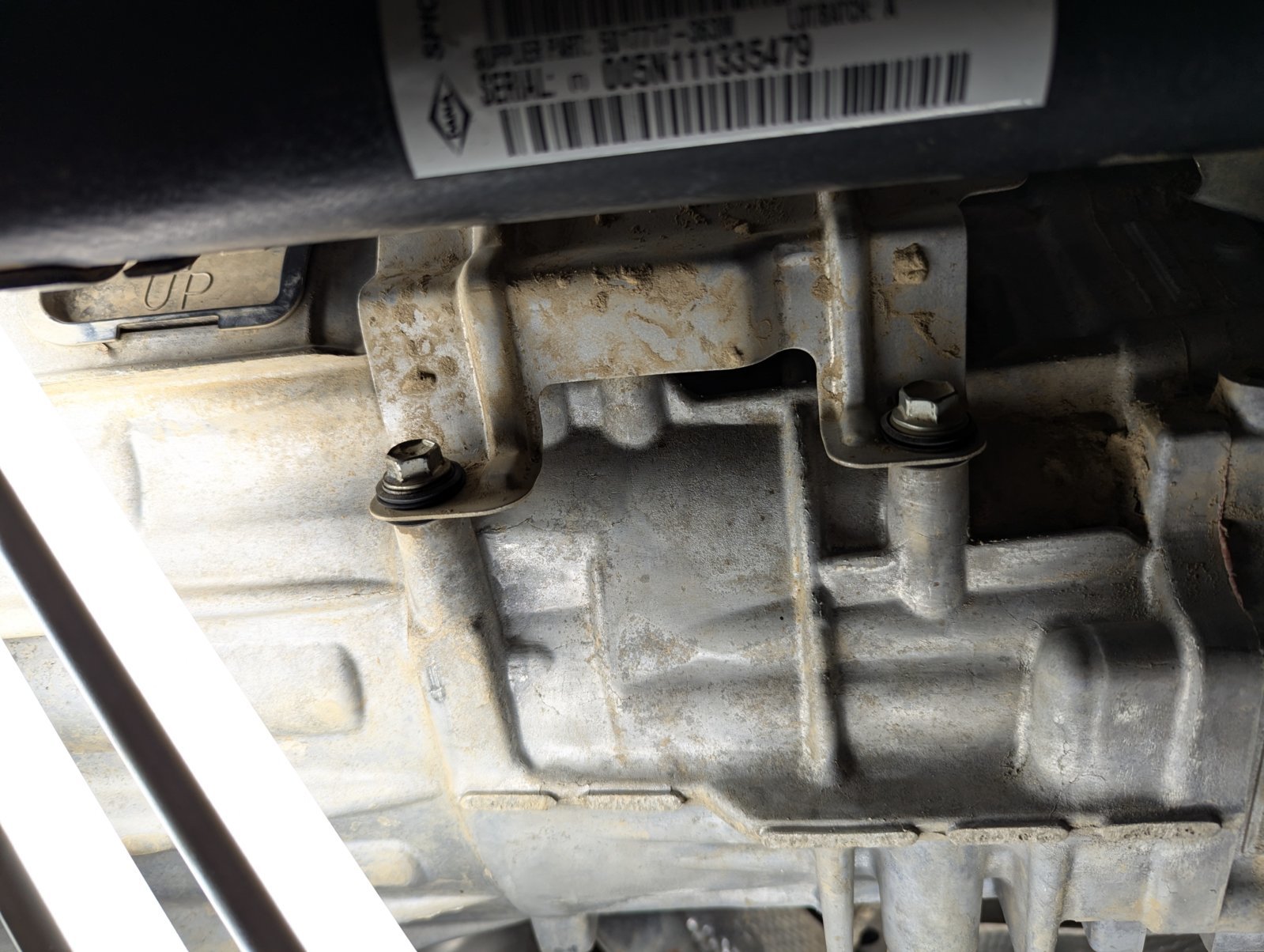

    Got it back on with the neoprene washers. Forgot to put threadlock on it but I don't see it coming off.

    Typically, there is no need for thread lock here, but your previous image showed only about one full thread. Tightened, I am not sure if you have enough engaged to not be using some thread lock. Just my opinion.

    The washers squish, there's a decent amount of thread engagement. I was just concerned about the vibration

    I understand and noted that. Just sayin' that a few threads engaged would cause me to think about thread lock.
    Your Taco, your situation.

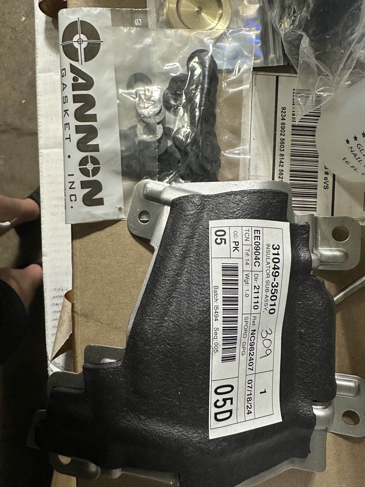

    Ordered the insulated heat shield (31049-35010) and Abrasion-Resistant Cushioning Washers for 5/16" Screw Size (90131A629) from McMaster-Carr. Should be overkill on getting rid of (most) of the noise.

    Wow, that's a lot of money for a heat shield.

    Yeah, pretty ridiculous. Imagine due to the low demand. If it doesn't help, at least I can report back and no one else will try it lol.

    Ordered one as well a few days back. I lined mine with the foil butyl stuff when I did the accumulator delete and it was okay but the sticky butyl attracts dirt and I couldn’t really tell if it made much difference. A TSB part might make a better difference. I did buy the same washers as you got, just now, so thanks for mentioning those.
    Redoing my delete with the Firn disk as well instead of the dremel, just because.
