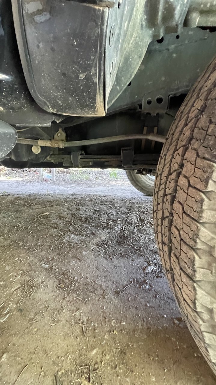

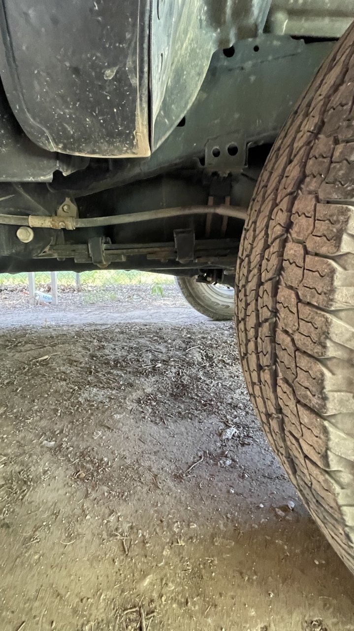

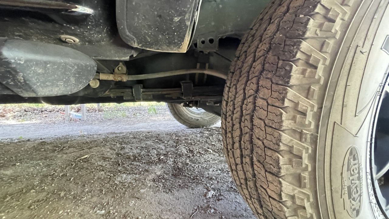

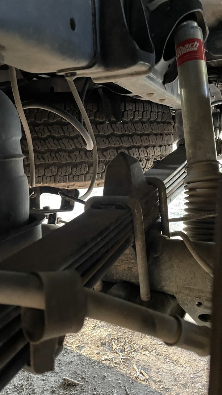

    Hey guys, was trying to find the issue of my rough ride. I thought it was the Eibach Stage 1 kit I have on since it has a higher spring rate, but others report that it rides fine. I notice the bumps are super harsh but it's even more so in the seats. I have a 1.5" single add a leaf in the rear but I was looking to get a new leaf pack because I think they look worn. Before I buy a new pack to see if it helps, I just wanted some opinions on if it looks normal or worn to anyone else. Here's some pictures:

    The pictures make the leaves look almost totally flat...

    My 18 offroad springs look exactly the same and ride is fine, actually it has a good off/on rode ride.

    Yeah that's how they look in person as well. That's why I thought they may be worn out. I also wasn't sure if the front shackle is so low on all Tacoma's or is it just because they are so flat.

    i've had a 2020 and now a 2021 tacoma and the leaf springs look pretty flat straight from the factory. yours look good.

    - springs don’t really wear out; at least not in a few years of daily driving
    - an add-a-leaf increases your spring rate which will lead to a harsher ride quality
    - the stock leaf springs are fairly flat a ride height and it’s nothing to worry about
