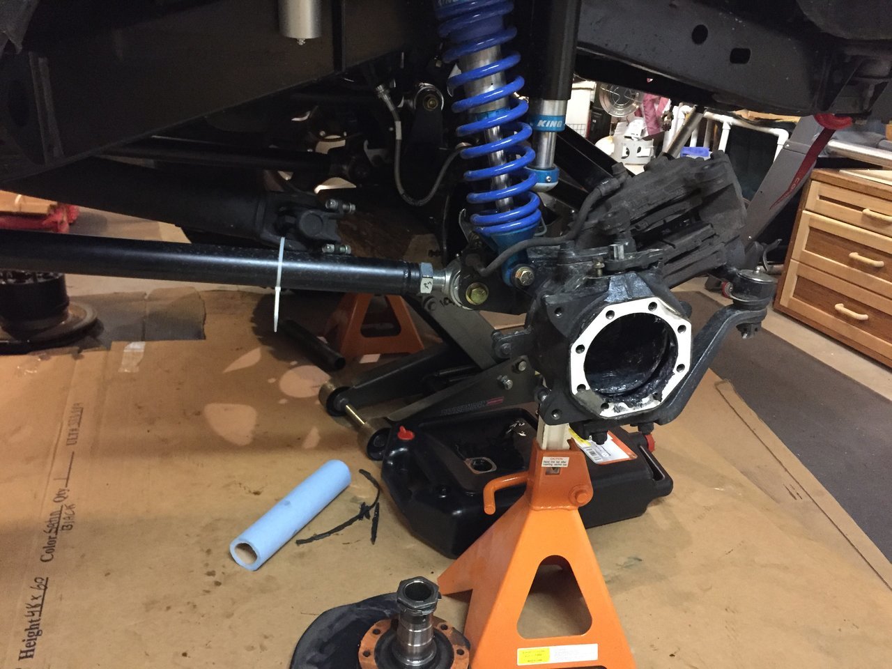

    Fighting quite an annoying issue..
    Ever since I got the truck back theres a grinding noise up front over 25mph except when the engine is under load, also a slight take off vibe. I can feel it in the floorboard too.
    Originally thought it was the front diff set up wrong or wheel bearings so tore the whole axle apart to find its nothing. Third member is at Olympic 4x4 for them to run some compound on it to make sure.
    Going to put the axle back together tomorrow night, if it magically isn't fixed then it must be the driveshaft. Problem is im not sure what part of it. Could be bad u joints, u joint angles, length or splines. So its sitting on jack stands for now :(

    going to sound dumb, but does the front diff have enough oil in it? the clowns who re-built and re-geared my front "forgot" to fill my diff before calling it a day initially :rolleyes:

    Haha yeah there was. A good amount of metal on my plug for only 50 miles but Mark Bowers (just left the manager position at Nitro) said it isn't abnormal. I knew there was going to be some but not this much.

    ah yeah initially there usually is a good amount. that's normal. hmmmmm hard to say without hearing a clip of it and doing the initial diagnosis. try posting in the SAS thread too...
