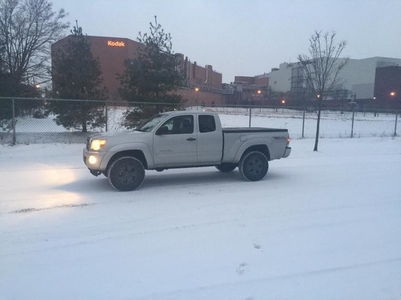

    Here is my truck with 5100's set at 1.75 in the front, 3 leaf pack in the rear. I do have the ride Rite air bags installed but not inflated at the moment.
