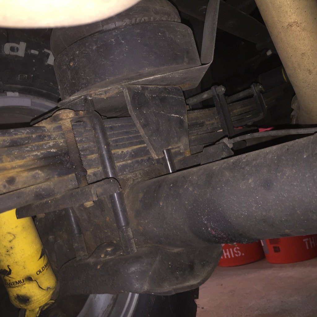

    We have a guy who's a great welder at work. he's going to weld my sliders on for me when they arrive as a matter of fact.
    We also have access to a BIG shearing machine and whole puncher there. I think I'll see if he wants to help me with this at the same time...
    I just looked. As you can see, I have the same problem.
    9FD2AB21-87D4-4821-B0C2-9E9E56B0E18A_zps_524a784a486c4bbe96d1f59b7b5e2faf5c915fd6.jpg
    Yours came out great, but, I'm thinking the corresponding curve isn't necessary. I might just notch it so it hits like the original bracket? Save a lot of work.
    Actually, I'd probably just shorten the bracket at the flat end, and just use the curve that it comes with. Even if it's not a perfect match, it'd still be better than the original. Just cut the upper bolt holes off and drill new ones. Either that, or just weld them on like you mentioned above.

    New holes is a good idea instead of messing with a new radius. I got the 2" extensions, so new holes would have been weird. Get the 6" extensions so you'll have plenty of meat to locate the new holes. And remember, if you weld instead of bolting them, you'll surely want a different spring pac next year.... so?
    EDI*T: And yes, a notch would be just as good. I just got anal with mine. The radius is the same as comes on the extension, I just transferred the radius.

    No, yours looks great for sure.
    The more I look at it, I don't think I'll have to cut at all. Since I'm actually lifted, I can probably just use the 2" as its meant to be used. I just didn't know they existed until I saw your post.
    Just another project for the list...

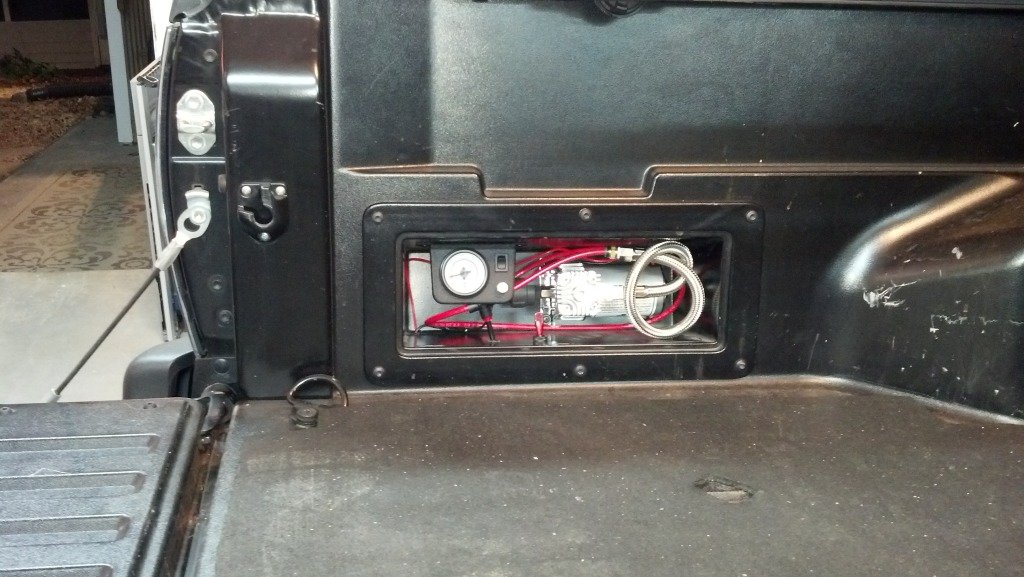

    OK, I have a question on a product. Anyone have any info pro or con?
    I have my ride Rite airbags installed, and will be airing up or down depending on the load. I have a good compressor in the garage, but want a small portable for the truck. I expect ai'll also `air up a tire on occasion. The unit below has a duty cycle of 10 minutes, so a tire would likely require a cool off period or it would freeze up the compressor.

    Can you share some details about this set-up? What brand/part number compressor do you have in there. Was this a kit or did you have to purchase all the parts separately? Looks really clean.

    I bought it as a kit when I got the bags. Here's the link:
    http://www.autoanything.com/suspension-systems/74A5181A0A0.aspx
    BUT, the compressor looks different now. I did this almost three years ago. The filter looks bigger.
