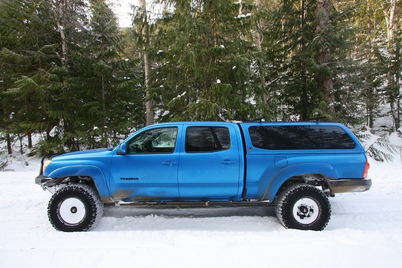

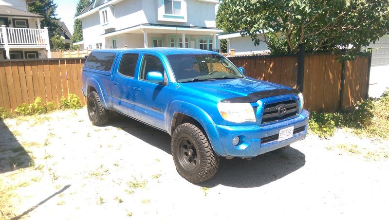

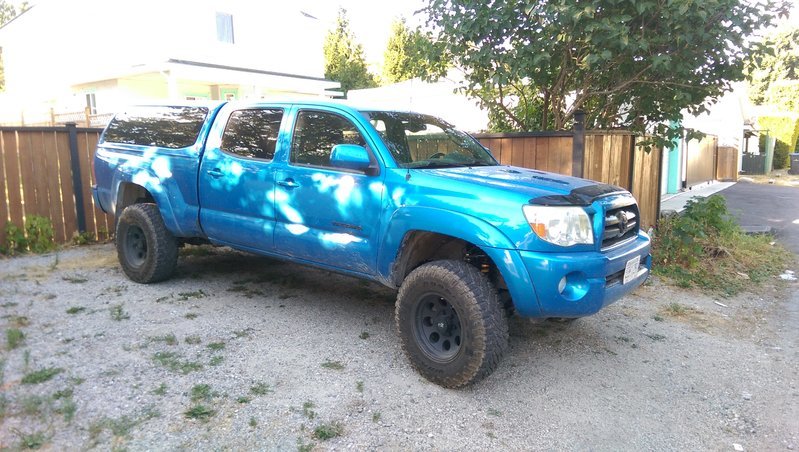

    So the first real mod that was actually aesthetically noticeable was wheels and tires, then shortly after, the lift!
    I went with 265/75r16 because I really wanted to put them on asap, and not wait until I could get a lift on. Glad I did though because I later found out that my LCA cam bushings are seized and any bigger would have rubbed baaaaad. Once I get around to fixing that, I'll likely go up to 255/85r16!
    The lift is your standard ome setup with Dakar's out back and 887x springs up front. I'm not sure if I would go 886 in retrospect or not to be honest! Would be nice to keep a bit more lift, but the ride is good as it is. I also put on spc lr uca's while I was at it. And with the seized cams, they were what enabled me to get aligned in spec, so that saved a lot of headache!
    This is prelift
    And this is post lift
    Unfortunately I've definitely lost some lift since then after it broke in, then adding bumpers etc.
    No rubbing on the passenger side, but my cam issue on the driver's side gives me a bit of rub when turned and compressed.
    Squirt and tacoma16 like this.

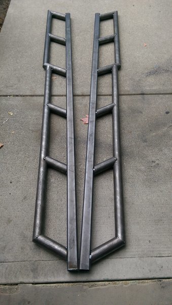

    I think next up came my sliders. My friend and I designed and welded these up from scratch.
    We didn't have access to a tube bender, so decided to make these a little more vicious looking than you may be used to! We went overkill with 2" DOM tubing. Dclb needs all the support she can get!
    From there we fabbed up some brackets and gussets to bolt these to the frame. Welded some nutss to plate as a giant washer. Used existing holes on the frame, and just drilled through the bottom. I will have to get some better pictures of that when I get home!
    I used my hilift to test it, and I can lift both side wheels off the ground with minimal deflection!
    Here's a pic painted and mounted. I will try to get some better ones of that too when I'm home! This project took a while to complete due to our schedules, so I actually got my bumpers on before we finished them haha

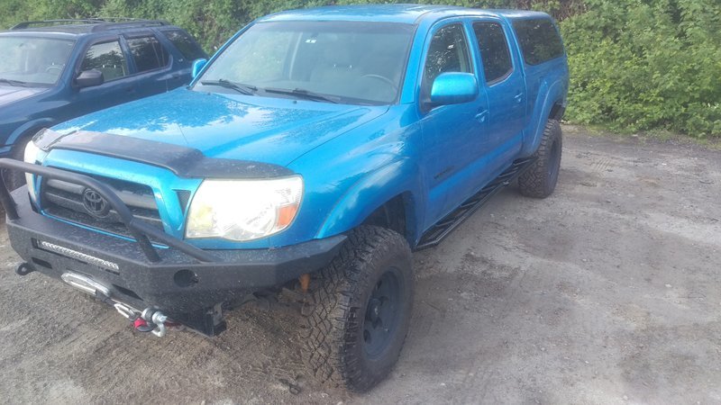

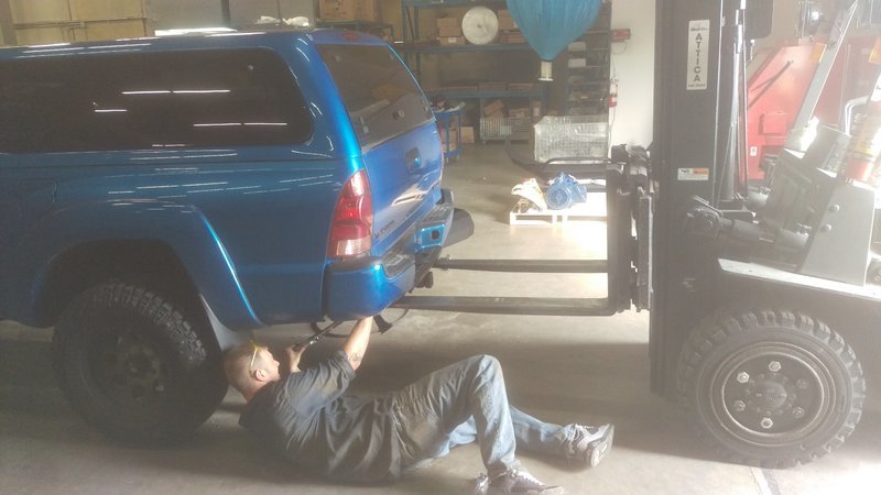

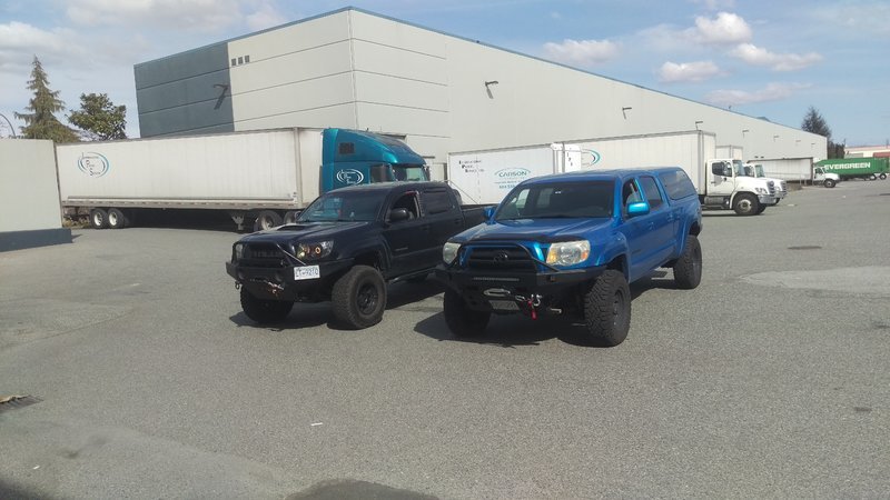

    I might as well post a few pics of the bumper install while I'm at it! @Pelfreybilt did great getting these to me despite an insane winter for them both in business and personally.
    I got the aluminum front because I'm not trying g to pretend I'm a rock crawler. The weight savings and better approach angle and winch mount ability is enough. And obviously aluminum or not, it's better than plastic!
    I have a Smittybilt xrc 9.5 winch, rigid sr20 and amber duallies in the front
    Mounted up very easily with the help of a couple friends!
    The rear hc was a little scarier to do! Threw the rigid srq lights in there
    If you have a forklift....
    All installed and next to my friends extra sick taco

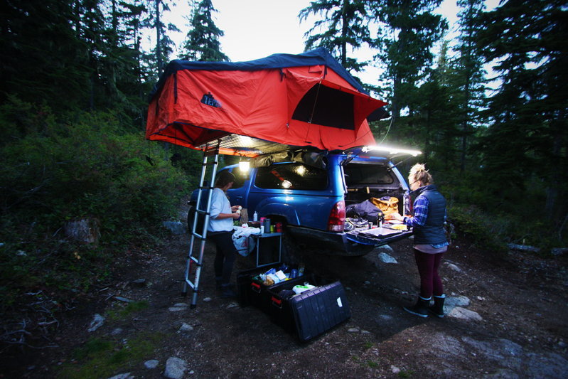

    So this is a bit out of order, but I just recently built some bed mounts using the method found in the excellent DIY thread HERE
    you can also see that I decided to tackle putting lights into the bed. I decided to do two strips velcroed to the carpet lining, as well as one strip along the bottom edge of the rear glass, to light up the tailgate when cooking etc. works great! I put them on two separate switches which I installed in the hinge part of the canopy. I looked a long time for a good spot, and this seems the best (though not necessarily the cleanest, wiring wise) because they are easily accessible from either outside or inside the bed and with the hatch open or closed.

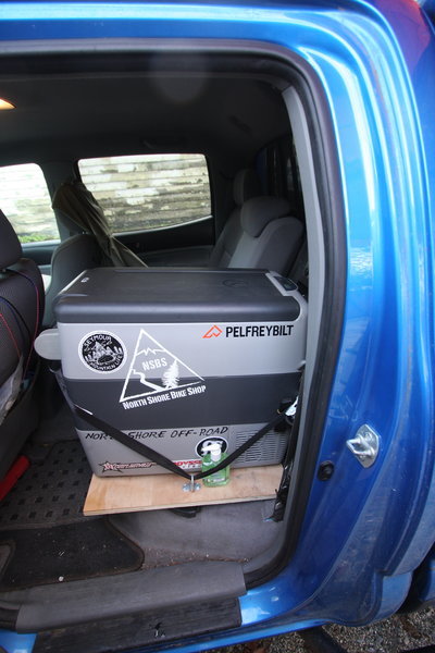

    I also figured I'd throw in a pic of my current fridge set up with the Indel-B 50L model. I took out the 40 split rear seat, wired a 12v socket into the storage area that is behind the seat to plug the fridge into, and made a very very simple platform to mount it on. I lack carpentry skills... But it has served us well in this spot, and leaves sort of 2 seats in the back, which can come in handy! The only problem with this spot is that the door doesn't quite open all the way, so you have to hold it open while looking inside, which can get annoying. I'm trying to devise a way to either hold the door open, or add a strut that would hold it up.

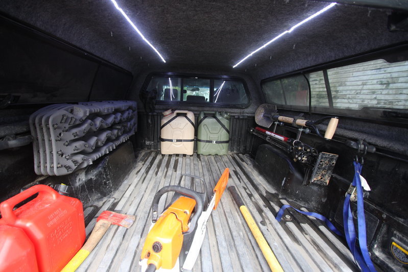

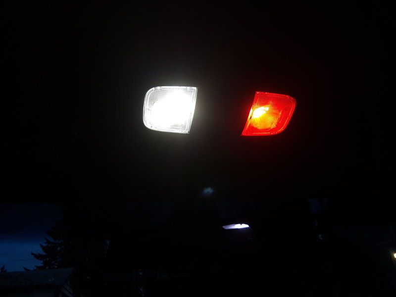

    Okay, very lame mod, but it works awesome;
    Interior LED's!!!
    I went with a regular white driver map light, a red passenger map light, and I got an adapter to make the dome light have a tonne of LED's in it, and it is super bright! I'm really pleased with it!
    I decided to go with a red passenger map light because I found that when my wife is using the map for navigating, I really hate having her light on driving back roads at night. I'm hoping the red makes a big difference for that! I figured that if I ever need the driver map light, I'll be stopped, so white would be better. I'm not sure if I should have gone red for both or not though... it's cheap and easy though, so i can always switch it later. There is a local guy who I get all of my LEDs from and he sells them for the best price I can find anywhere (even online).
    I know these are shot in the day, which isn't super helpful, but it really shows how bright these are. I do want to get some night shots, but didn't have time today.

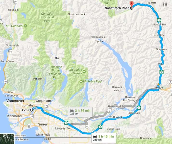

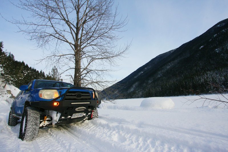

    I wanted to share some pics of a recent trip my friend and I took for just 1 night in the snow and cold. Turned out this would likely be the last real snow trip of the winter (unless we get another crazy snow storm out of nowhere!), as well as the first camping trip of 2017!
    It was just the two of us, my Tacoma, and his stock 100 series Land Cruiser. We only had the weekend, so we decided to stay closer to home. Nahatlatch seemed like a perfect destination within a 4 hour drive from us, so we set off late saturday morning, after taking some time to do a few last minute things on our vehicles.
    We both had just bought our new HAM handheld radios, and were so stoked to be able to actually communicate. It makes such a difference! suddenly you're not just driving by yourself, but actually feel like a team. We had an uneventful drive up to Boston bar, thought it was my friend's first time heading north that way, and the Fraser Canyon is an extraordinary piece of highway. We turned off before some of the best bits, but he still really enjoyed it.
    Crossing the Fraser River at Boston Bar, we started driving down the backroads. Here is where the snow started! We aired down where the snow stopped being hard pack, and was more tracked from sleds than vehicles.
    We met a couple guys on sleds who said that there had been no vehicles other than sleds past a point just about a kilometer up the road. They said that the snow got pretty deep past there, and we probably wouldn't make it very far. We decided to just press on as far as we could before setting up camp for the night.
    it wasn't long before we hit... UNLIMITED.... POOOWDEEEEER!!! (that is a StarWars reference if you're confused...)
    We passed where there were a few vehicles parked, and hit the road where it was obvious only sleds had been. I was expecting to get stuck right away, but the super crisp cold snap we had been having for the last couple weeks had turned the snow to a really light, fine champagne powder. We were able to mash through it with relative ease, and it made for some really really fun driving! I took the lead to blast some tracks from my friend's stocker.
    We made it as far as about halfway up the third lake before I was starting to struggle moving uphill. reversing to get momentum to plow trail every five feet got old pretty quick. We decided to turn around and head back to a beautiful spot we had seen a little ways back. We set up camp, lit up a fire, and got to staying warm! I had my chainsaw, so found some deadfall that was in decent shape under the snow and bucked it up. once the sun fell, we watched the temperature drop from about -7C to -18C before we stopped caring. Not arctic cold, but cold enough to make your boogers freeze!
    Before going to sleep we decided to warm ourselves and our sleeping bags up in my friend's LC100 and watched some of the LOTR return of the king in the dash touch-screen... for a 2001 the 100 had some crazy tech!!
    I decided not to bring my RTT just because I was sleeping solo and didn't feel like putting it on just for such a short trip. mattress in the back was just fine for the (frigid) night.
    I walked out onto the ice a ways and got a shot of the sun setting on a beautiful untouched frozen lake.
    IMG_1027.jpg IMG_1032.jpg some animal tracks on the lake
    Next day we ate some yogurt and granola, packed up, and drove home! blasting through the snow was so much fun getting wild! We explored a few more turn offs etc before getting back to the main road and airing up. Got to use my new compressor (write up coming) for the first time which was very exciting!
    It was a quick trip with just the two of us, but was just incredible to get out in such awesome snow and freeze our butts off. It's always good to escape the city, even if it's just for one night.
    I'll just leave a few more pics here! =]

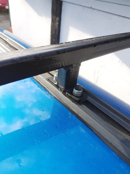

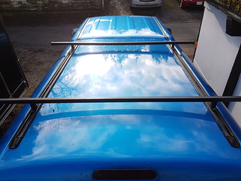

    Original Thread: https://www.tacomaworld.com/threads/cheap-diy-shell-roof-rack.476955/
    A while ago, I needed to put a roof rack on my rack-less Leer 100xq canopy. I wanted a system that used tracks, and a rack that slides in them, rather than hard mounted towers. I checked out all the usual suspects, Thule, Yakima, etc. and found that just the tracks cost around $250 (CAD) and then the towers, cross bars, and locks were an additional $600 or so. There's no way I could spend that kind of money, so I decided to go a different direction.
    I headed over to the Pick n Pull, and searched around looking for anything that might work. What I found was a very large number of Ford Windstar minivans with stock roof racks on them! The crossbars themselves are basically useless for anything more than maybe 1 ski, but the tracks they slide in are absolutely perfect. Five bolts each to remove them, $10, and I was out the door!
    Cleaned them up, and they were the exact right length for my Long Bed.
    To install, I measured them to be about equal front to back. I discovered that the canopy isn't straight, but sort of tapered towards the back, so I measured across to make sure the tracks would remain parallel to each other, so I could slide my rack up and down as needed. I drilled through the canopy and used 1/4" bolts, fender washers, nylock nuts and silicone to bolt them on and make sure there were no leaks.
    BONUS: As a little side note, I used longer bolts than I would need for mounting the tracks to the cap, so that I would have extra threads on the inside of the canopy. These I used to bolt up some cheap stretchy netting on the inside so I could throw blankets or sleeping mats or whatever light thing you can think of up on the top out of the way. Netting: https://www.amazon.ca/gp/product/B011ARI7TC/ref=oh_aui_detailpage_o00_s00?ie=UTF8&psc=1 I just used fender washers and wingnuts to attach it!
    From here, you can just buy regular Thule or Yakima towers and crossbars, and call it a day knowing you saved yourself about $240. I decided to carry on and build my own rack as well. The reason was I wanted the rack to be as low profile as possible for my roof top tent. The bought racks generally end up being about 5-6" high, and that wasn't going to work for me. That and I didn't really want to spend $600 bucks.
    So, with the tracks complete, I moved on to the rack itself. I bought 10' of 1" square tubing, and had some 1" flat bar lying around. All in all I think I spent about $80 on steel and bolts etc. For this part, I'm sorry I don't have many good pictures.
    I cut 8 sections of flat bar 3" long. I did have to grind them down just slightly narrower to slide easily in the tracks.
    Taking 8 - 5/16x1" bolts, I cut the heads off. I then drilled 2 - 5/16" holes through all of the pieces of flat bar, about 1/4" in from each end. Taking 4 of these pieces, I welded my studs into the holes so I had 4 pieces with 2 studs each, something like this: _||____||_ . These would be what slide in to the tracks.
    I then built the rack part using the 1" square tubing. These you can make as wide or narrow as you want. I ended up going with 56" wide so I would have some more mounting options even with the RTT on. You can also go as high or low as you want. I went with towers 1.5" tall (2.5" from the track to the top of the crossbar, or 3" from the canopy to the top of the crossbar). I decided on this height to accommodate for the cab of the truck. I don't know if AC are the same, but my DC raises up a bit towards the front. I wanted to be able to put long things on my rack, with out it hitting the roof. However, I also wanted the rack to be as low as possible. This is the height I settled on, but your mileage may vary. This 1" steel square tubing is quite strong. I propped it up on either end and stood my 180lbs in the middle, and we couldn't see any deflection at all.
    From here, the rack was a simple matter of welding the tubing together with 2 supports per cross bar, and the remaining 4 pieces of flat bar with holes in them as feet on each upright. Paint or powder coat or whatever you want to do (I spray painted), then finish off the rack with 4 end caps from Home Depot to give it a nice clean look.
    Now you can slide the four pieces with the studs into the tracks. Take your crossbars and line up the feet with the slides, and use 8 nuts to bolt them down, squeezing the tracks in between the 2 pieces of flat bar.
    And for a grand total of $100, and a few hours of time, you're done! I've now been using this set up for about 8 months, and have done hundreds and hundreds of km's of nasty dirt roads with my RTT on, and had no problems what-so-ever. Also, I will admit that I once forgot that I had the RTT on, and drove into an underground parking. That is A) a mistake I will never make again B) really super embarrassing, and C) a testament to the strength of the rack and canopy set up!
    If you have any other questions, let me know and I can grab more measurements or pictures!
    (I'm not sure why my third brake light looks blacked out, but it's not...
