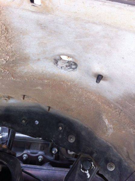

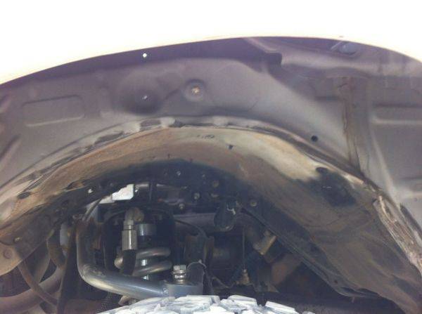

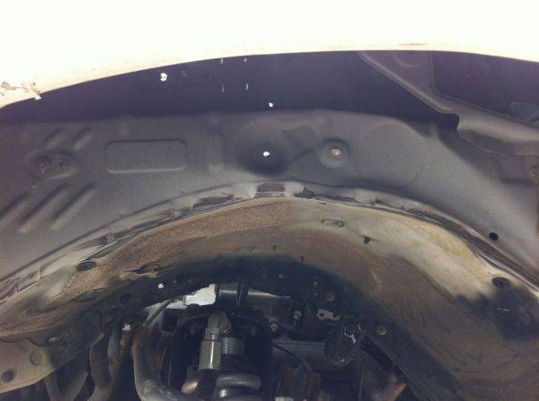

    When I landed my driver side tire smashed the whole wheel well up...as if I didn't have bump stops and that's why the shroud is rubbing. The truck is not totaled.

    Damn that sucks. got any pics of the damage?

    the inner core support is possibly damaged...sounds like a good excuse for an engine cage:D

    I demand footage please. Sorry about the truck. I doubt its totaled. Even if the motor mounts got tweaked, those can be fixed. The shitty part is finding the new airbags and such.

    my thoughts exactly..the pics are slowly coming through TW live but ill post them here too

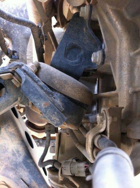

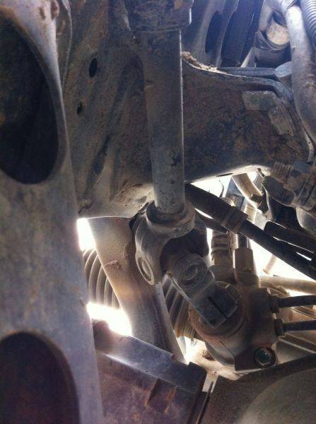

    hey monkey proof I saw your message in the live thread. I agree. the front diff mount bolt is what made the crack in the engine..and here are the rest of the pics. I cant really get one of the drive side motor mount

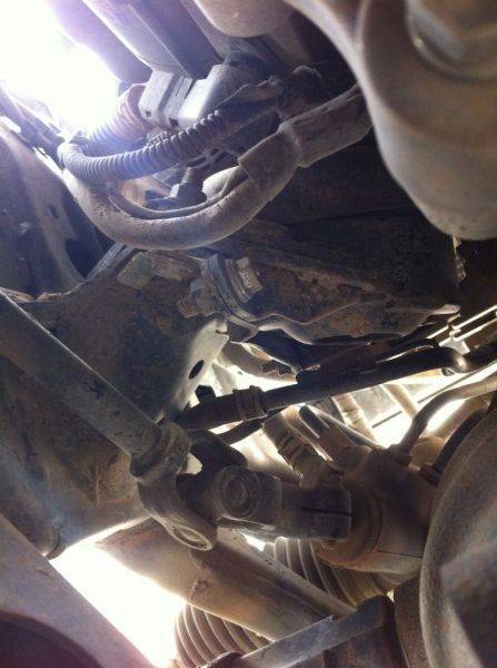

    driver side motor mounts..best i can get...they look ok

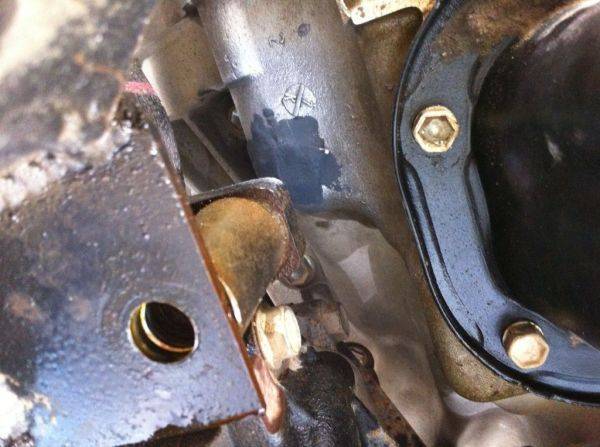

    this is where the small leak was...I'm retarded and should have taken a before pic..anyway that putty is that quicksteel..its pretty hard. I made a little extra into a ball and its been almost an hour and I cant even break it with a hammer. I'm going to have the cut that bolt down a bit that hit it. It has a good half inch of threads sticking past the nut

    i think you'll be fine, your motor mounts look fine, they arent sunken into the frame and the frame isnt torn at the motor mounts. which it would look like if something catastrophic happened. also looks like you have the updated motor mounts and not the older ones. good luck with getting everything fixed
