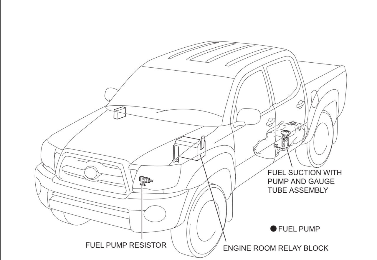

    Is the fuel pump resistor in the fuel tank or under the hood. Thanks for the info everyone
  8. Aug 18, 2020 at 8:11 PM
    TnShooter
    TnShooter The TacomaWorld Stray
    Sep 2, 2010
    #42625
    21,148
    Deogee
    07' TRD Off-Road, Auto
    STOCK
    Under the hood
    Marc70, CurtB and TRDSport10 like this.
  9. Aug 18, 2020 at 8:16 PM
    ToyotaMinnKota
    ToyotaMinnKota [OP] Active Member
    Aug 18, 2020
    #338050
    27
    Thanks for the diagram sir
    TnShooter likes this.
