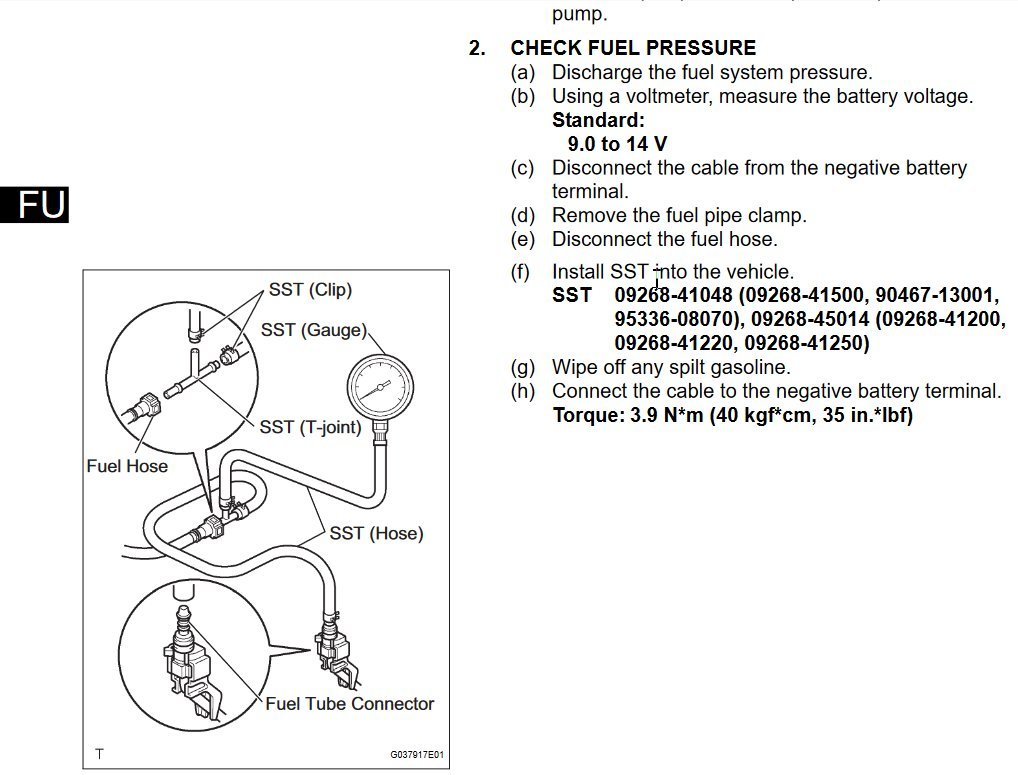

    Going to rent a fuel pressure kit from Autozone now...... fuel pressure before cranking is 44 psi, what About the running idle psi is?

    I seem to recall having read somewhere that it's tricky getting a fuel pressure tester hooked up to the 4.0L engine. Maybe I'm all wet.
    At any rate, it would be interesting to see what brand/model AZ rents you and if there were challenges getting it hooked up.

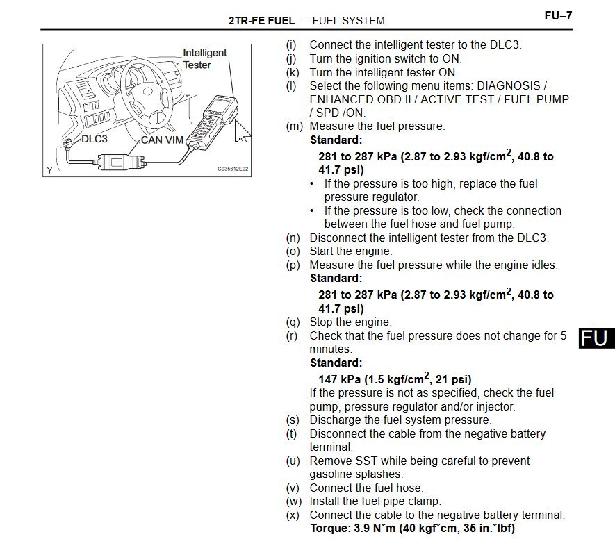

    They said it comes with A gauge, along with various sized hoses and hose clamps. I assumed there is an easy access point under the hood... running/idle psi anyone?

    There shouldn't be a change in PSI between running and idling that is what the fuel pressure regulator is for maintain consistent pressure.

    Ok wasnt sure thanks

    So, did Autozone have a fuel pressure gauge with all the proper fittings?

    So I'm about to attempt to do a fuel pressure test and was just curious to know how to discharge the fuel system?
