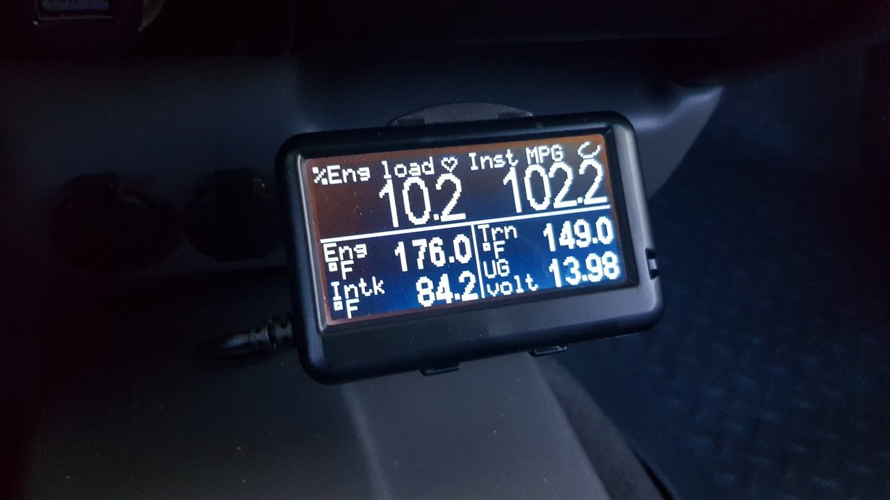

    Here's my truck this morning when I left the house, not up to temp yet (loop indicator at the top RH corner for the UG).

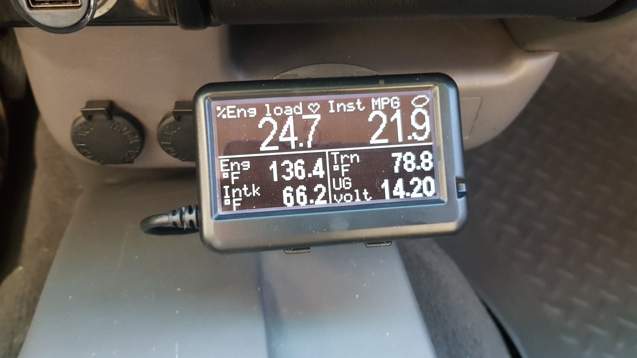

    Open loop off the throttle exiting the fwy.

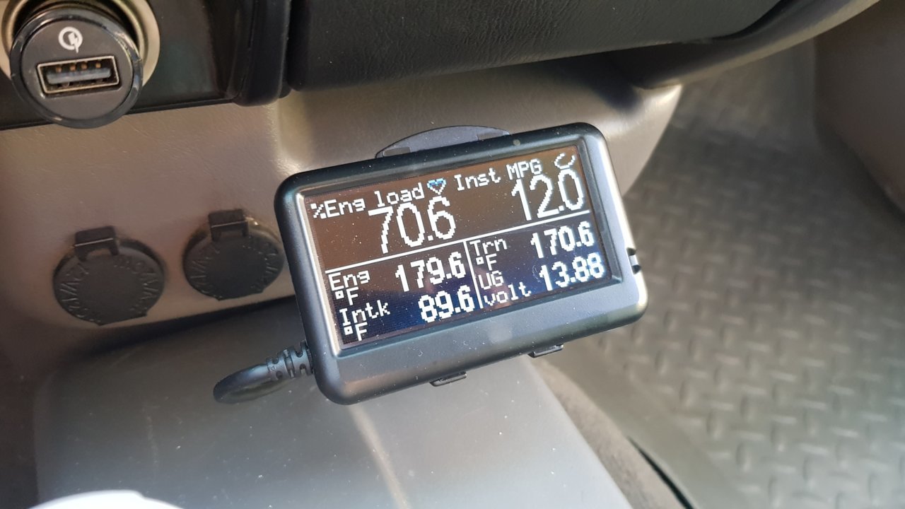

    Open loop going up a hill on the fwy.

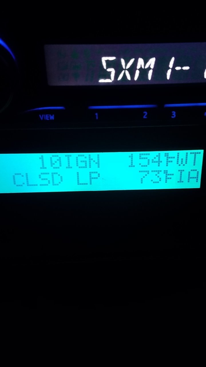

    My truck is similar to yours,
    My open loop changes at 154 degrees to close loop.
    My ECU goes into open look when ever I take my foot off the pedal and when I’m on full throttle.
    Otherwise dam ECU keeps the truck in closed loop
