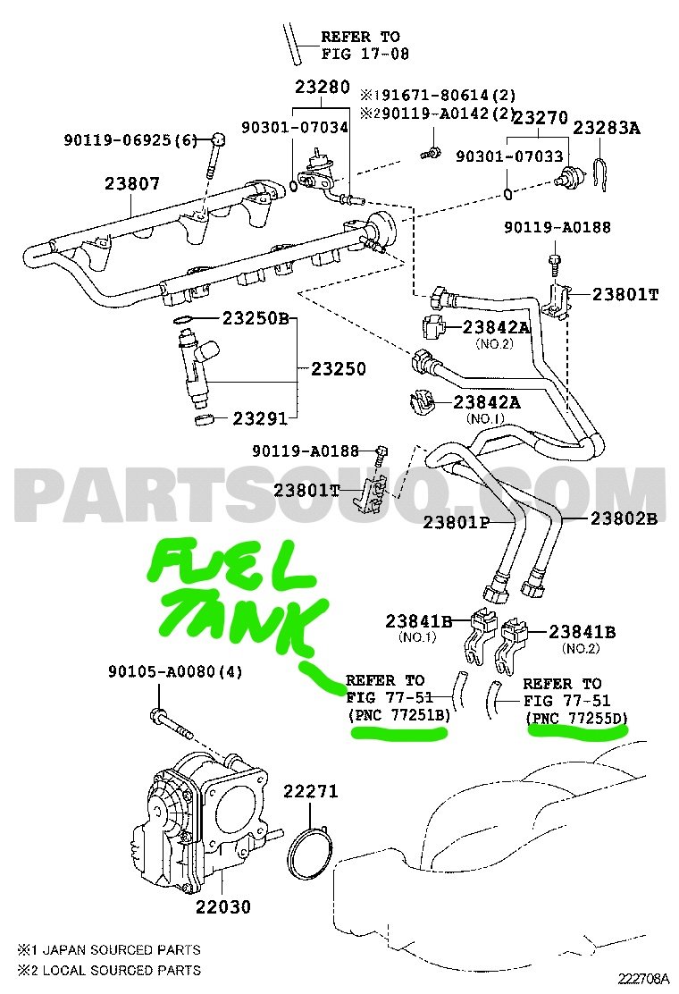

    That connector doesn't have anything to do with fuel pressure... That is part of the evaporative emissions control system along with the canister in that same line ( it isn't a filter ) it is an accumulator.
    Go with the other posters and check fuel pressure. Or see this:
    http://www.customtacos.com/tech.old.../06toyrm/06toypdf/06rmsrc/rm2006ta/009000.pdf

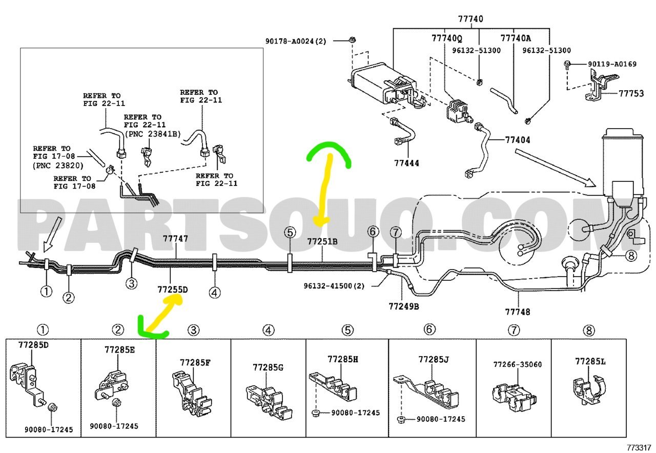

    Fuel System Diagrams

    Politely, this is incorrect.

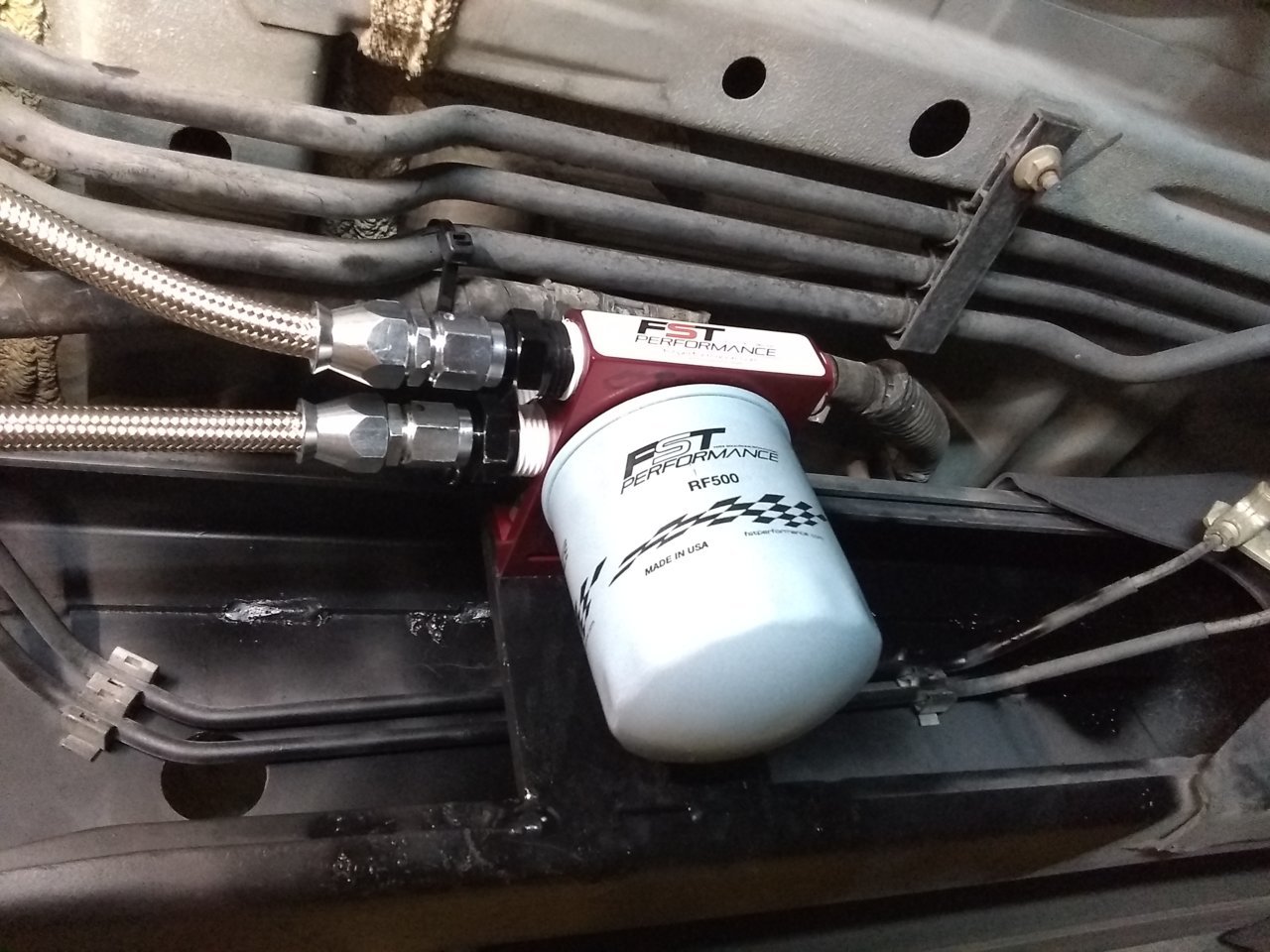

    Pump fits in the middle. Just recently upgraded the pump on Lucario Runner's truck. As well as installed PTFE hose, and a 3 micron oil filter like fuel filter. 30 second fuel filter swap now.
