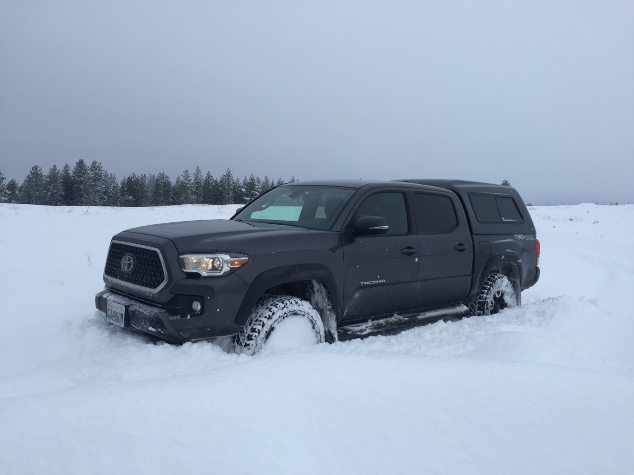

    Looking for any information on how to bypass completely the the anti-slip TRAC feature. Not just the option shown below. Comparing our 2001 Tacoma to our 2017 the 01 gets around better in the snow and its probably due to all the computer overrides. We just want straight up 4X4 not all these other item.
    When should I use the VSC Off button in my vehicle?
    If both front wheels get stuck in fresh snow or mud, you may need to turn off both Traction Control (also know as TRAC) and Vehicle Stability Control (VSC) so you can rock the vehicle to free it.
    To turn TRAC off, simply push and release the VSC OFF button. The "TRAC OFF" indicator light should come on. Push the button again to turn TRAC back on.
    Push and hold the button for three seconds to turn off both TRAC and VSC. The TRAC OFF and VSC OFF indicators will appear.
    Push the switch again to turn the systems back on. You can also turn the engine off and TRAC and VSC will come back on when you restart the engine.
    Please click here to view a video.

    Welcome.
    You can't permanently turn that function off unless you want a lot of lights lit up.

    Hold it down for about 3 seconds and it should turn everything or at least most of it off. Got to be still....i think

    I was hoping someone knew a way to disable it without having to push the button all the time some override. We have done the temp override when needed, 4-wheeling just got all computer geeked up in these new trucks!

    i had zero issues in my truck. put it in 4hi - hold tc button for about 3-4 seconds - only lights are vsc and tc off - then engage ect. felt completely confident and the system never intervened

    The terrain is not a flat pasture with 1 foot of snow. They do not do great in steep snowed in logging roads with any of the computer features. Just because something changes doesn't mean its for the better. I simply want to do my own driving not a computer for me. As of now the 2017 had to be left at the bottom of the hill of a well traveled road as 4wheel drive isn't engaging at all. She will go in for warranty repairs tomorrow and more than likely find a new home. I don't have time to learn military launch sequence so I program my truck to handle the snow.

    I'm not sure if it's still a thing on the 3rd Gen Tacoma, but on the 3rd Gen 4Runner (which has the same brake booster setup) you could permanently disable the traction control by unplugging one of the wire harnesses from the brake booster. I had to do it to get both rear wheels to spin while the truck was on a lift for diagnostic purposes.
    Expect lights on the dash though.

    THANK you, I will look into that!
