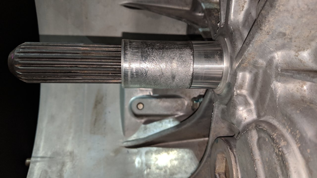

    Let me preface this by saying I have spend probably 40 hours researching this within the last month, pouring over threads here, many other forums, TSBs FSMs, conversing with my mechanical engineering buddies and my 40+ years ASE master tech with Toyota friend as I have spent the last two weeks doing my clutch job on my 2010.
    First of:
    DO NOT GREASE THE LIP OF THE TOB/RB YOU WILL CONTAMINATE THE CLUTCH DISC.
    As other members have said 1st gen Tacoma's with the R150/F and early 2nd gens (before the slave cylinder spring length/rate TSB) the throw out / release bearing DID NOT contact the pressure plate fingers.
    Toyota updated the design with the RA60/F changed the support fork post and replaced the slave cylinder spring to make the TOB/RB contact the pressure plate 100% of the time.
    Now if you have the 4 Cyl/5speed the TOB should NOT contact the pressure plate as it still uses the older style fork/bearing set-up.

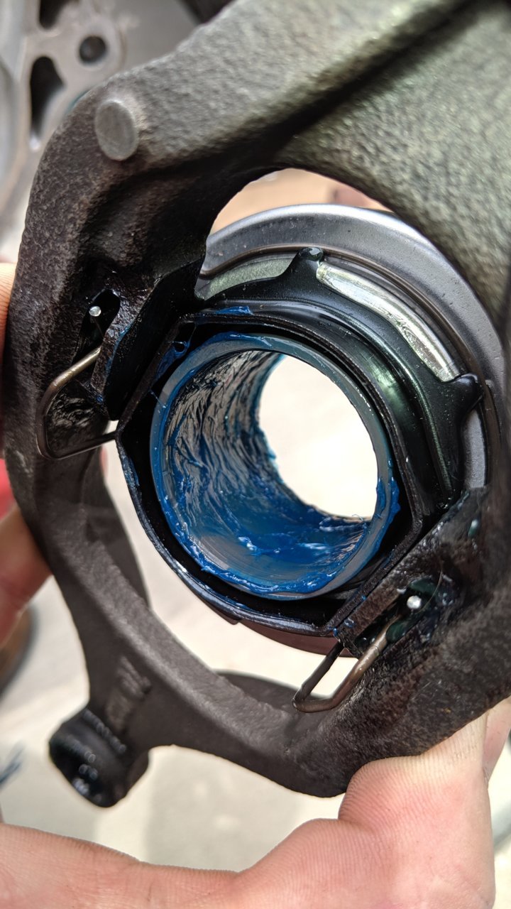

    DO NOT force grease down into the recess of the TOB! The throw out bearing is double sealed and lifetime lubricated putting grease in there will only become a potential issue of contamination for the clutch disc.
    DO! (Lightly) grease the INSIDE of the TOB where it slides on the quill and grease the quill itself.

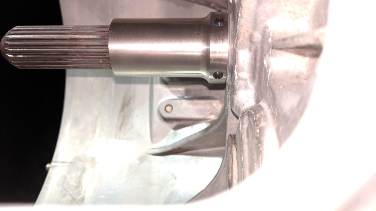

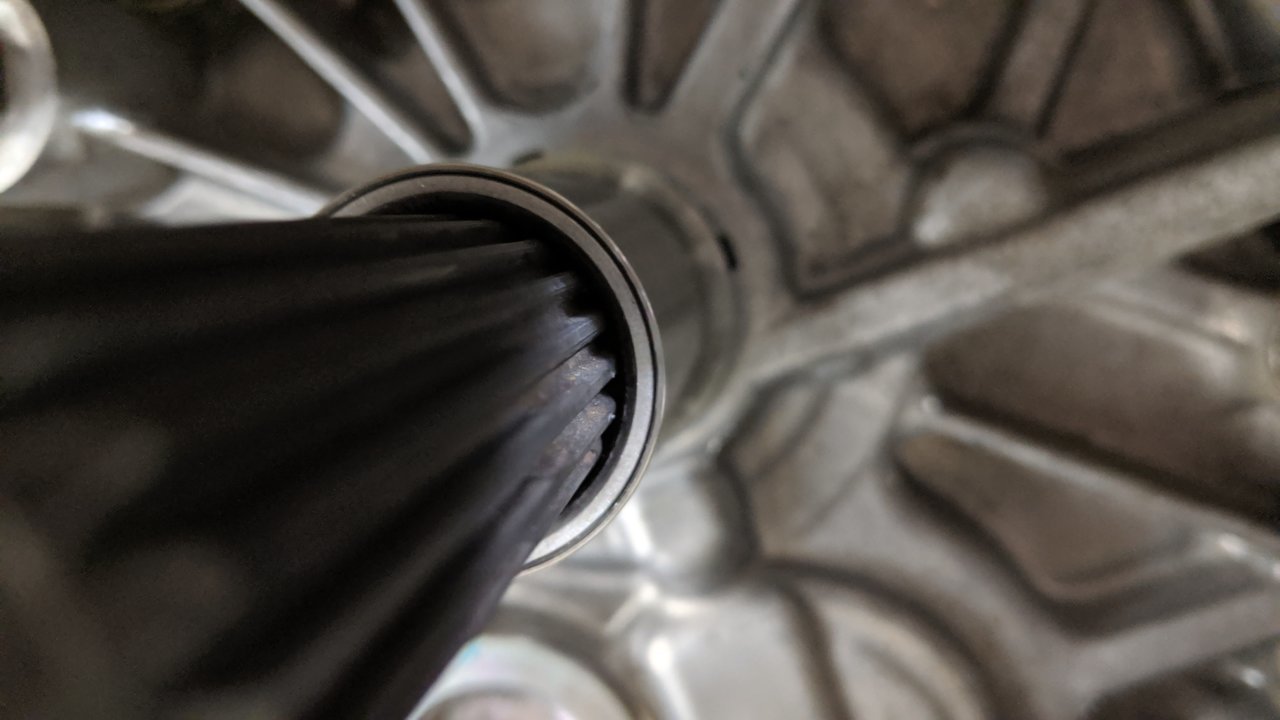

    NOTE! If you get the URD stainless sleave to fix the aluminum quill scoring then you should FILL the recesses inside the slide barrel as THAT is the "grease reservoir" the instructions reference.
    Properly greased new URD modify TOB:
    Where NOT to grease is down in those holes:
    Quill scoring/scarring:
    URD sleave installed:

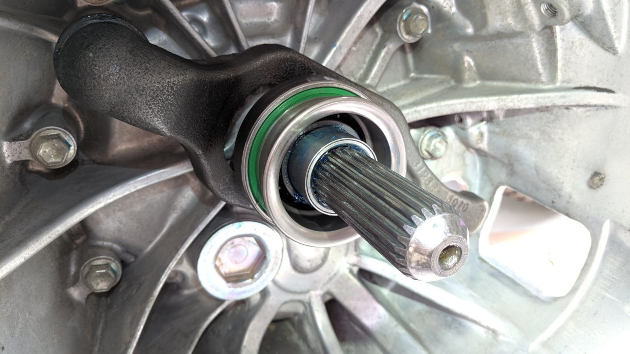

    TOB/RB on fork in bell housing:

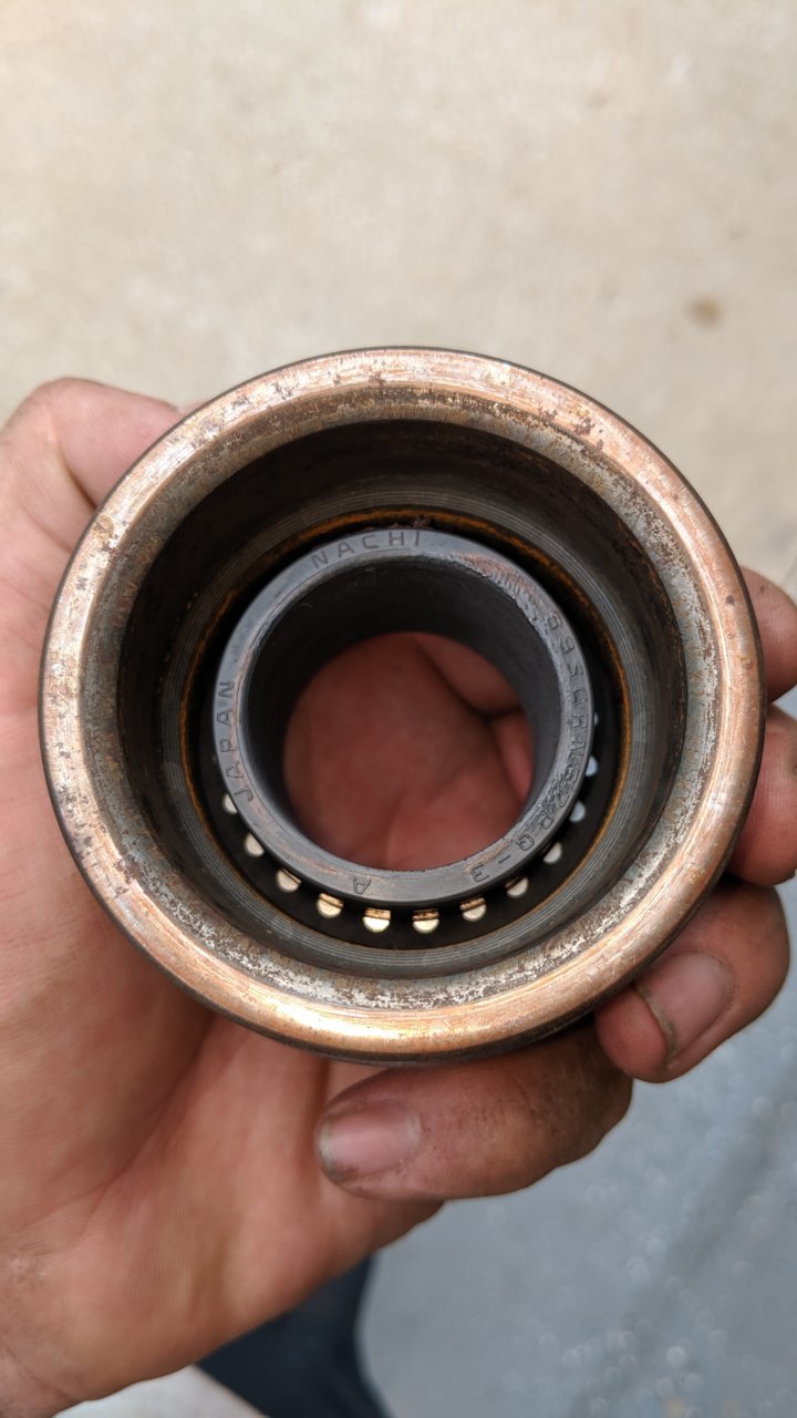

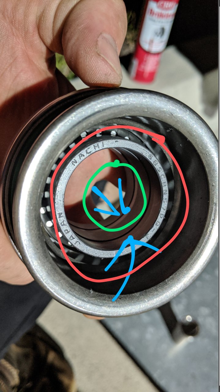

    Yeap I have that sheet too and it confused me which lead to so many hours talking to the experienced and the research.
    Here is what I found:
    Blue arrows those are the grease reserve grooves that need filled.
    Green ring bearing "inside"
    Red ring:
    Retainer snap ring for the TOB's actually bearing inner seal.
    BassAckwards[QUOTED] likes this.
  13. Jun 6, 2019 at 8:13 AM
    Key-Rei
    Key-Rei Well-Known Member
    Jun 20, 2017
    #221942
    7,863
    Key
    Florida
    2010 TRD Off-Road 6Spd 4x4 209BSM
    Locker anytime Fog Lights anytime Full LED light conversion TRD cat back Rear cat delete Exaust Y reroute away from actuator Alloy Clutch master 2000 4Runner "Dog Leg" shift leaver Marlin shift seats and bushing Rear seat delete Rear diff breather extension Chrome grille swap Debadge Rear seat delete Honda blower motor beefy plug and wire mod Anytime 12v and USB with volt gauge in bed Blue Sea fuse box Hella AND 70's Caddy horns Low profile recessed hex drain plug swaps Alluminum battery strap 7pin relocated Backup cam on anytime Various other creature comfort and personal taste mods.
    The URD bearing is the same exact bearing as the OEM stock bearing says "NACHI JAPAN" and identical part numbers.
    URD simply send the bearings out to ha e the inner sliding on sleave to be machined large enough to fit over their stainless quill.
    The also put the grease reserve grooves in so more grease can be in there as one of the sources of "clutch squeak" is the light film of grease you can put on the stock bearing/quill dries up or gets dirty/contaminated and no longer lubricates.
