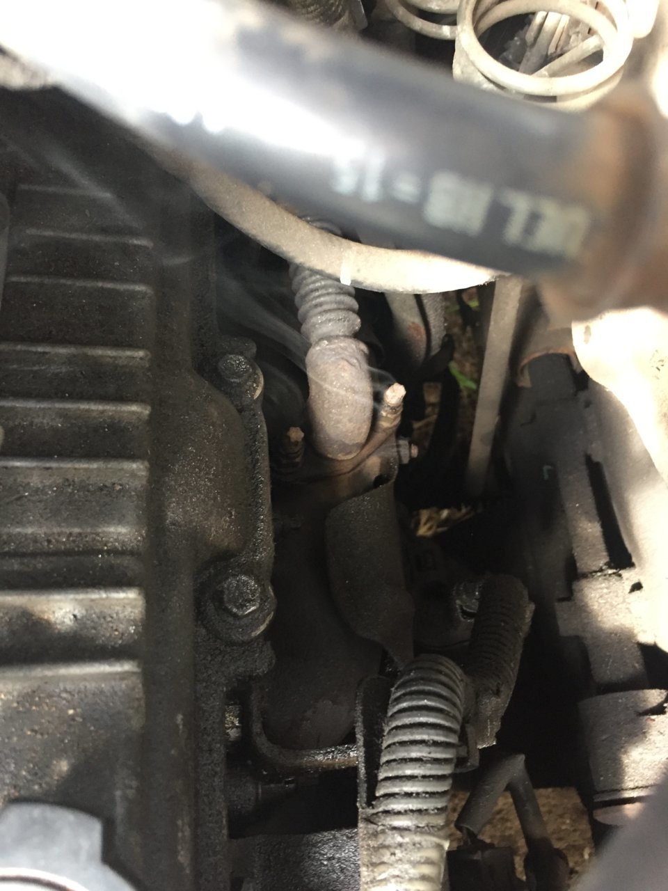

    Well, I went out looking for leaky injectors first, I had someone else start it and keep it running by pumping the gas pedal. As the eng warmed up, smoke started billowing out of this region and the exhaust smelled awful! This pic was taken immediately after shutdown and yes that is smoke coming off of those two fasteners attaching that hose to the exhaust manifold. It appears the valve cover gasket needs replacing? Maybe it is squirting stuff out? Or with that smell, the head gasket is blown on that side? Oil and coolant still look fine(no milky residue). This is driver's side. I haven't done a compression test but suppose that would be a good place to start?

    look like a bad valve cover gasket leaking oil to your exhaust manifold / egr valve pipe. smoke is probably from oil burn off due to heat
