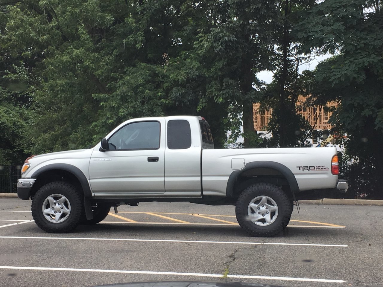

    Honestly it doesn’t look that bad in that photo. I have the exact same issue with my 2003 ext cab. 881/5100’s didn’t give me enough lift to look right with the single AAL. Have you tried to load the rear and putting some miles on it to break in your AAL’s? I’m hoping a topper will help me, if I ever find one.
    Sorry for your frustrations, but I’m glad to see I’m not the only one who finds the 881’s to be squishy/too floaty. People think I’m crazy when I say mine are too soft, even with no weight. My last 2003 had the same, but with the RCD branded 5100’s and it was great. It’s weird to me. Maybe I missed it, but which shocks did you use?

    Sorry for the extra post, couldn’t figure out how to edit and add from my phone. Here’s how bad my rake was within the first 500 miles. I think it’s slighty better now, but not much.
