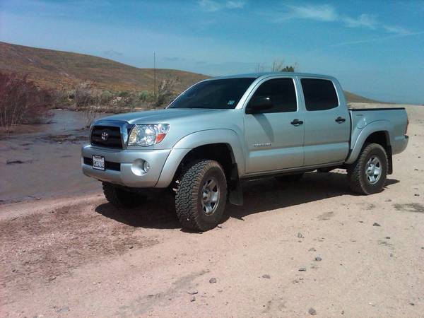

    Currently I have Bilstein 5100's in the front set at 2.5 and bilsteins in the back with a block to level it out. I also have a set of BFG 265/75R16's that I got about 5 months ago. I'm definitely ordering some UCA's this week in order to correct my annoying alignment issues. I don't wheel hard but I occasionally haul my dirt bikes out to the desert. My suspension is a little stiff so I was thinking about getting some the Toytec adjustable front coil over kit for the bilstein shocks. Not sure if it will be worth it to get the coil kit. I really wanna get some new wheels for my truck too. I cant afford all three mods right now so I was trying to get some opinions on what I should do next. Feel free to post some pics of your wheels, preferably 16x8 since I just bought my tires. help me out! :confused:

    Adding an AAL to the rear will more likely make the ride worse. Just adding the coils will improve your ride greatly. I originally wanted to go the Billies route but opted for the Toytec CO's and couldn't been happier. I left it factory set at 2.5" with 1.5 rear blocks. Very smooth..My next upgrade is bigger tires. I would consider buying some spring helpers for the few times I do any heavy towing/hauling.

    Since you're running 265s, drop the billies in front to 1.75. That'll make it so you can align your truck and eliminate the need for UCAs, as well as softening up the ride a bit. At the same time, swap out the block to add-a-leaf as mentioned above, so you can carry your dirt bikes without bottoming out the suspension. Immediately after making both those changes, get an alignment.
    Then when you can afford it, put on wheels you think look cool.
