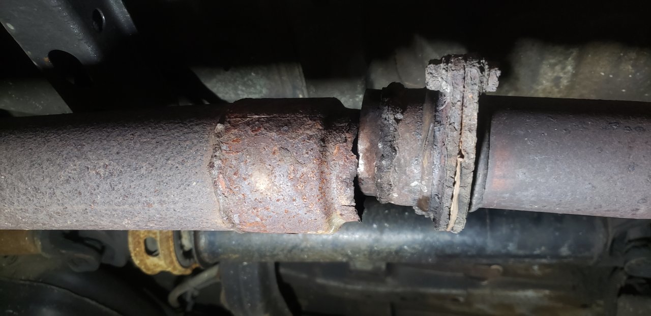

    Correct, BIG puddle at the bedford range, No stream / water crossings here, as per provincial regulations ( so I've been told )
    All joking aside. it was the bedford range. Fun day!
    All those puddles thermal shocked my exhaust enough times to cause it to seperate as badly as it did.XLnRnALTTOeFkcdP38M6PWME_ET40_inU5BE2e1g_45fab1478c17af9c2b87bbeeec1d4ee8afc2f6dd.jpg
    it was sooooo loud on the way home!:rofl:
