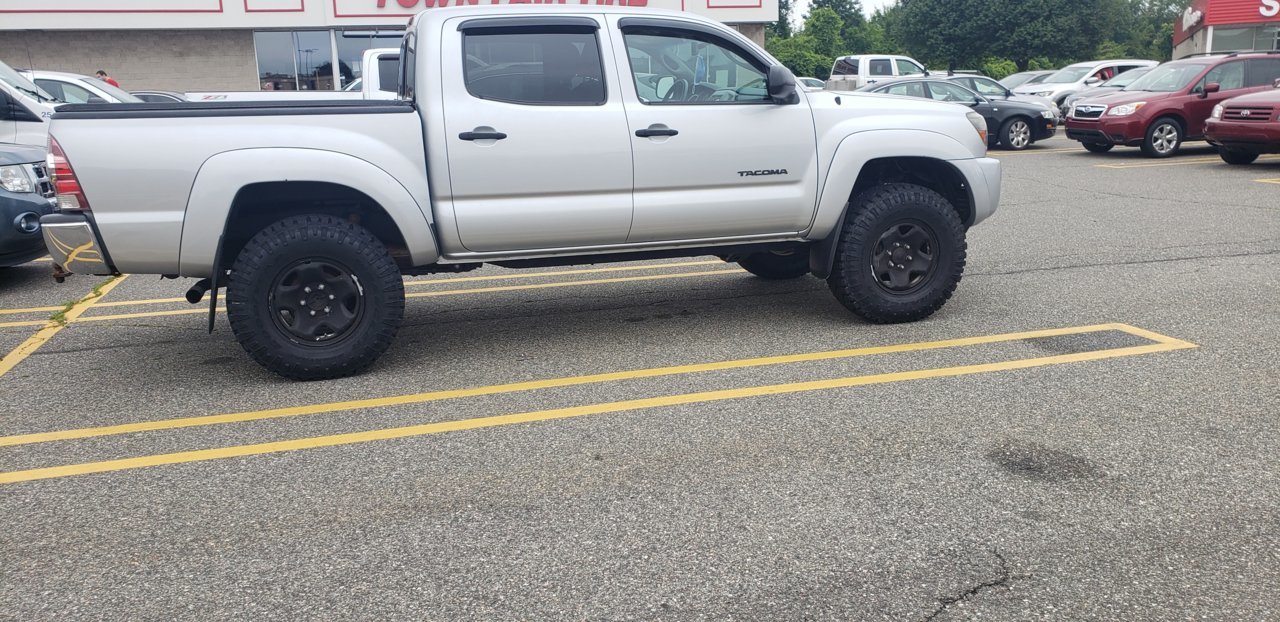

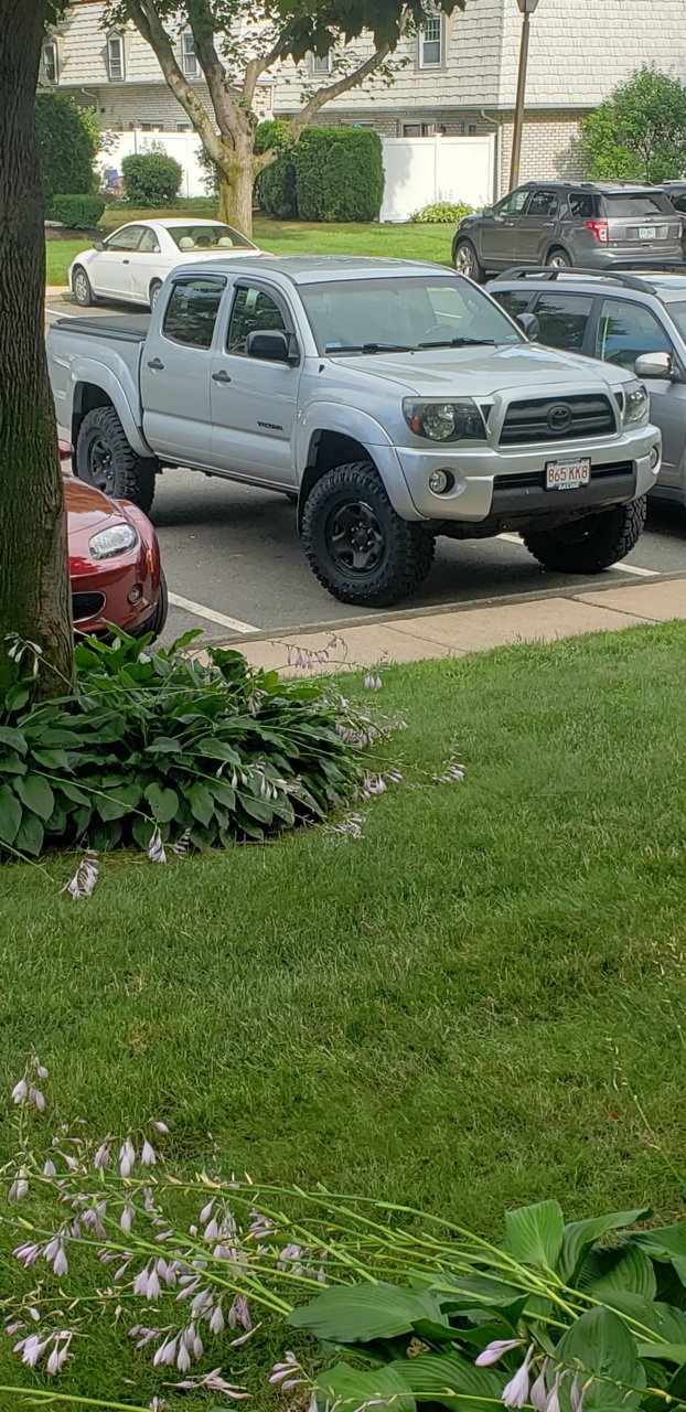

    3 inch old man emu lift
    885 coils
    Specialty products upper control arms w/ removable ball joints w/ grease zerks
    Ome front shocks
    Drivers side spacer under coil on drivers side shock avoid the driver side taco lean
    No diff drop kit not needed read up on it
    Sway bar relocate kit
    Driveshaft spacer to keep 2 piece shaft in line (no vibes)
    ome rear shocks
    Tacoma tsb rear leaf pack with toytec helper spring to raise to 3 inches
    Tires Goodyear duratrac's 285/75/16 on stock plasti dipped alloys
    Husky front mud flaps no tire rubbing on full tilt
    $1014 for tires at town fair tire
    $1200ish 6 years ago for ome suspenion package (from 4 wheel parts I believe)
    $650 upper control arms from specialty products co.
    Not getting stuck in snow circa my stock tacoma 1st winter Fing priceless

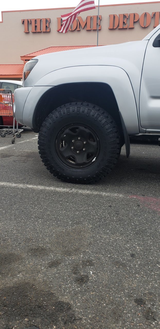

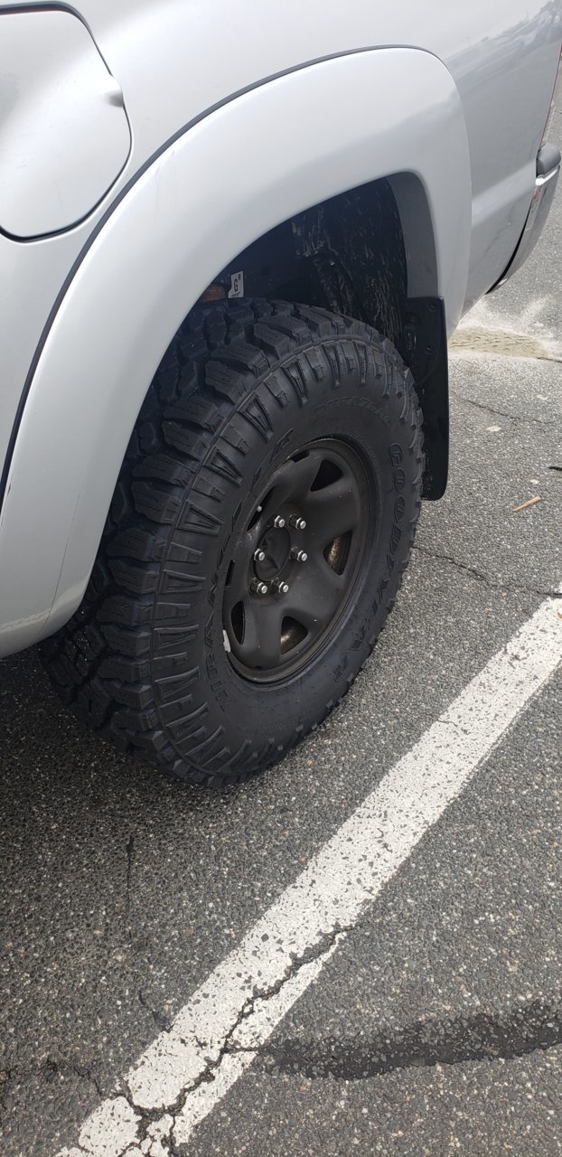

    Day of tire install.
