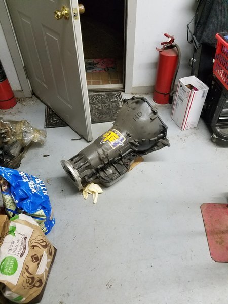

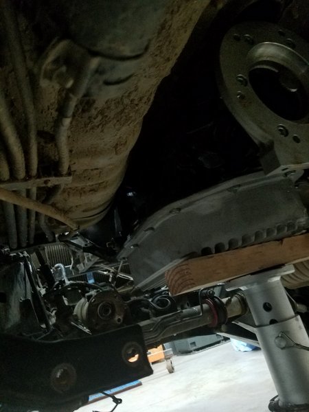

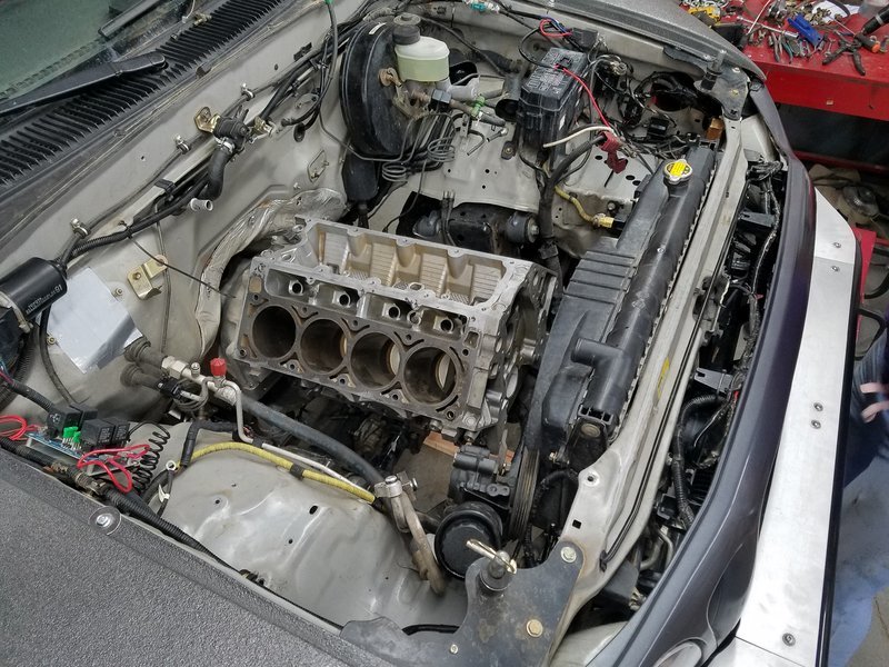

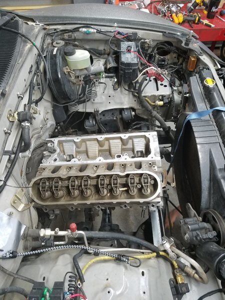

    Got a dummy block just resting in the truck to check for fitment. I also discovered the advanced adapter i got is for the "older" style 5 speed the 1st gen tacos came with 80's-95 models according to them. So they also said they do not make an adapter for the 5 speed in the newer trucks so using the current transmission is out the window. Gonna solve this with a fully built turbo 400 and atlas t-case. So my entire drivetrain will be for sale soon, engine, tranny, t-case20170123_182811.jpg20170123_201800.jpg

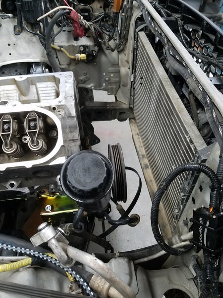

    Got the turbo 400 mounted up checking for fitment and clearence. Not the greatest pictures ever but whatever, fits great!

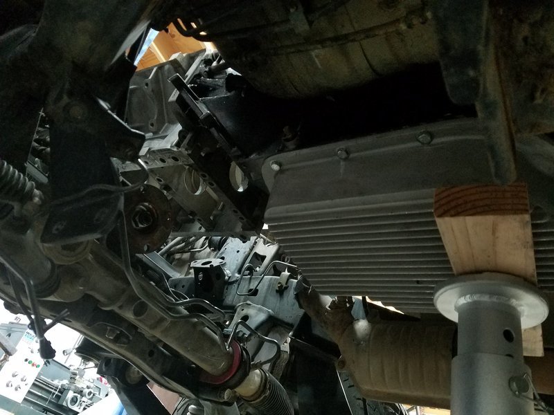

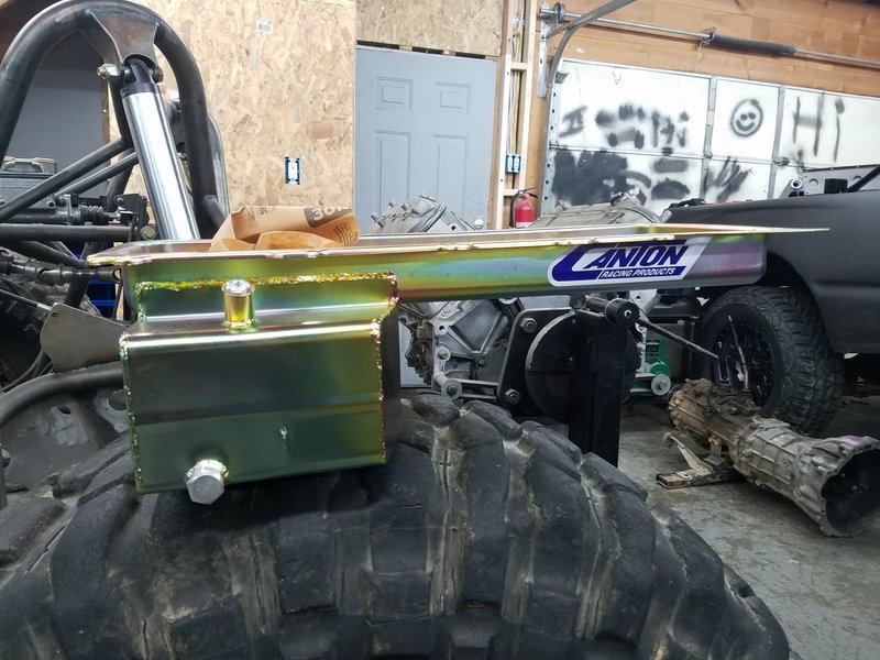

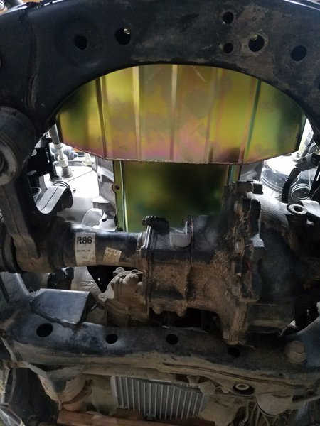

    Oil pan finally came in today, got it mounted up and it fits perfectly! Cant do much more until the motor mounts get here which was supposed to be today but of course now put off till next week . 20170127_173302.jpg

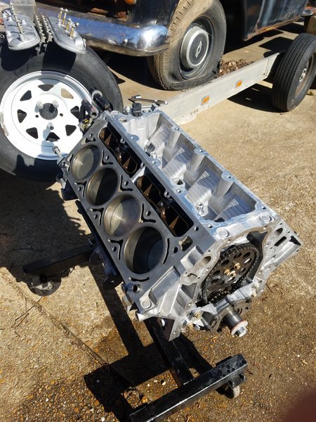

    Maybe new tires... hmmmm dirty 9's

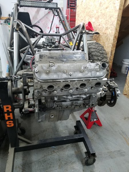

    And here is the motor thats going in the truck. Have new gaskets and everything, going to clean it up real good this weekend

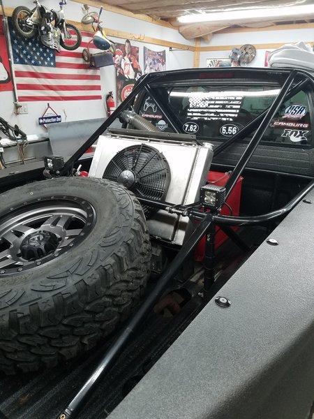

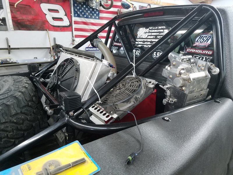

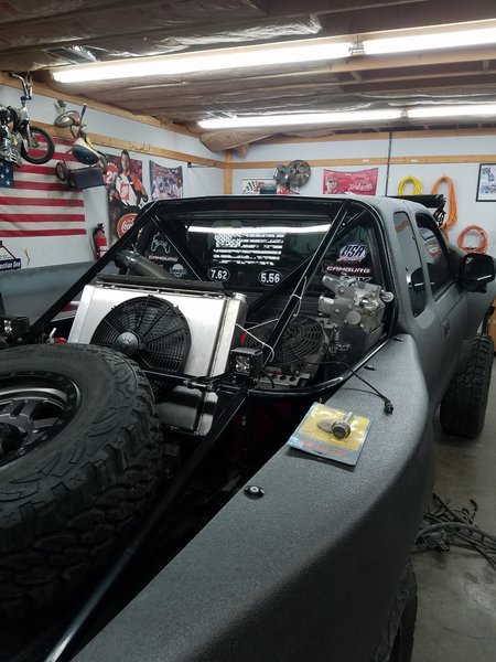

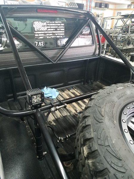

    Got the stock radiator removed today. Got the new one setup along with the trans cooler in the bed. Everything is just resting in the bed for mockup. Relocating the jack aswell to make is easier to get to. And also ordered the new jazz 32 gallon fuel cell :bananadance:

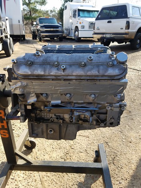

    #179105
    572
    ivan
    memphis
    2002 tacoma LSA swap prerunner
    built supercharged LS, T56, Linked, caged.

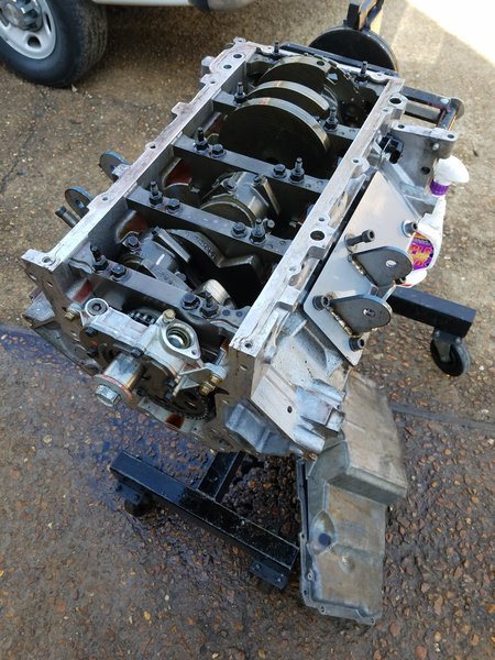

    Spent the day cleaning the 5.7 thats going in the truck, got most of the new gaskets on, should be able to drop in the motor very soon. Got the transmission mount made and started on making the mounts for the radiator in the back
