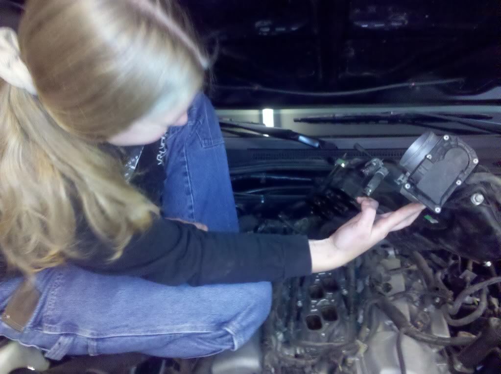

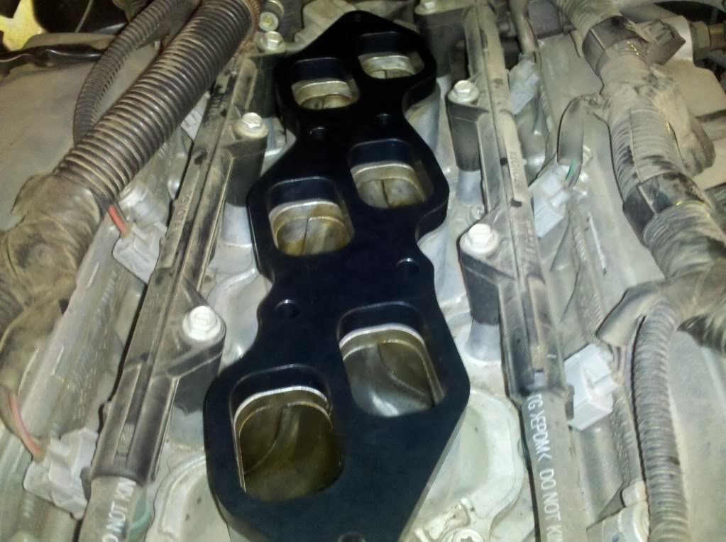

    I like mine got my X-Mas gift early, lenie and i installed one on my truck today seems to have alot more low end, and from 3rd gear doin 60 to 4th i was at 95 like right now :D, ill check my mileage to see if theres any increase
    Yeah i know i need to clean the engine bay

    Is your spacer billet or some sort of thermo-plastic?
    *edit: just spoke to NST, these are hard-anodized

    Interesting to see Round ports on the review set and these have rectangle ports, I see you need to port the runners as well, tons of flash.
