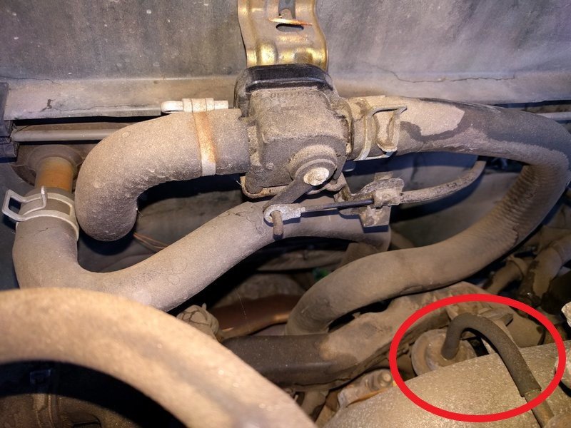

    My 2000 Tacoma that I bought a few months ago doesn't have an air intake resonator and the hole for the connectioon to a resonator is just plugged. After doing some research I noticed that there's a hose that normally comes into a resonator that I have tracked down to be the hose highlighted in red in the attached photo. My 5VZFE doesn't seem to have this connection point for a hose where it mounts to the engine either, but I'm wondering what it's for and if I need to figure out how to replace it/reinstall it.

  2. Apr 24, 2020 at 6:25 PM
    eon_blue
    Mar 4, 2016
    #180213
    69,700
    Azusa, CA
    Maybe it's just an 01-04 Tacoma thing and that's why yours is plugged?
    I'm not sure it's a necessary part but maybe @Empty_Lord can chime in

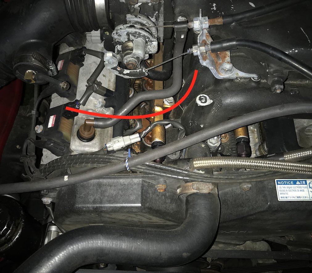

    To be clear, this picture is not my engine. I don't even have this hose on mine. Here's what I'm looking at. I put a red line where that hose would normally go over to the resonator from what I've gathered.
    Thanks for any tips or info

    Does it run fine? No codes?
    If so, I wouldnt worry about it. You'll find capped off vacuum ports all over the 5vz and 3rz motors due to year to year changes/area emmissons regulations etc.

    look up on your hood. there should be a "vacuum line routing" sticker showing the hose.
    I believe it could be air assist for the injectors, being as low on the manifold as it is? otherwise maybe just air bypass if needed

    goes to "pressure regulator" via the hard line under the intake manifold

    looks to be here on the back side of the engine

    Uh. You don’t have factory fuel rails. That line would of been for the fuel pressure regulator

    Thanks for all the info everyone! I think I’m set now. Just trying to take care of this truck and wanted to make sure I’m not messing it up accidentally. The feule injector system was installed by a previous owner so I wasn’t sure whether it was done correctly, but it seems to be good to go. Many thanks to you guys!!
