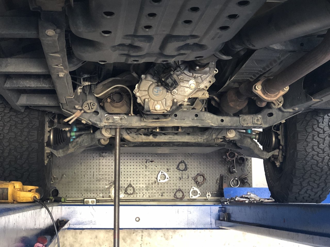

    Tons of prep left before we headed out to Utah.

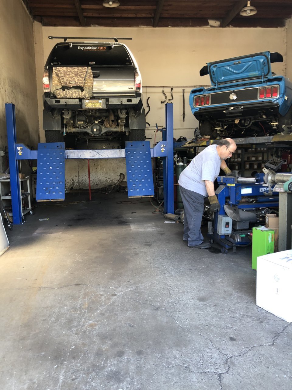

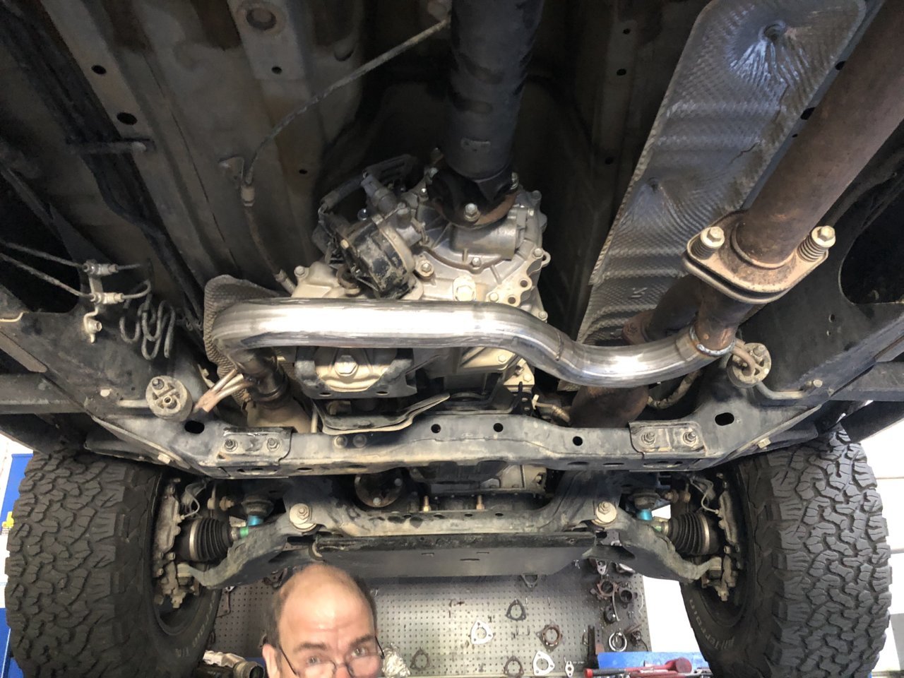

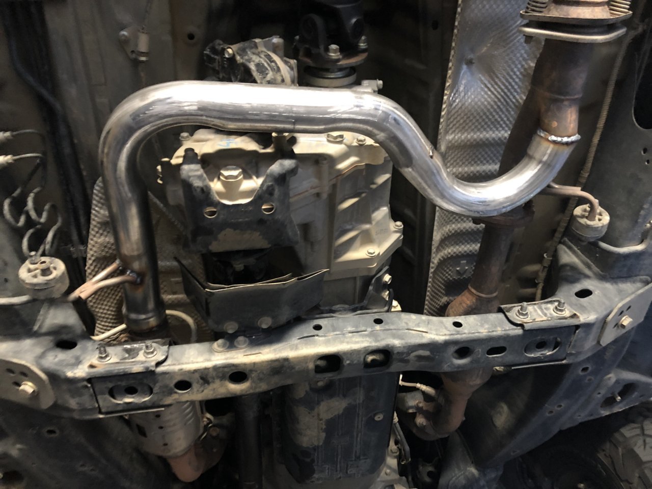

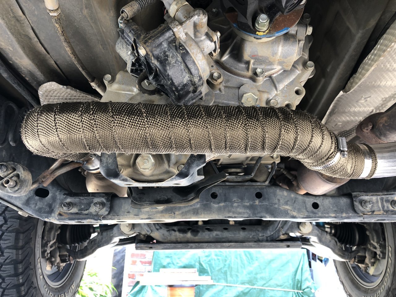

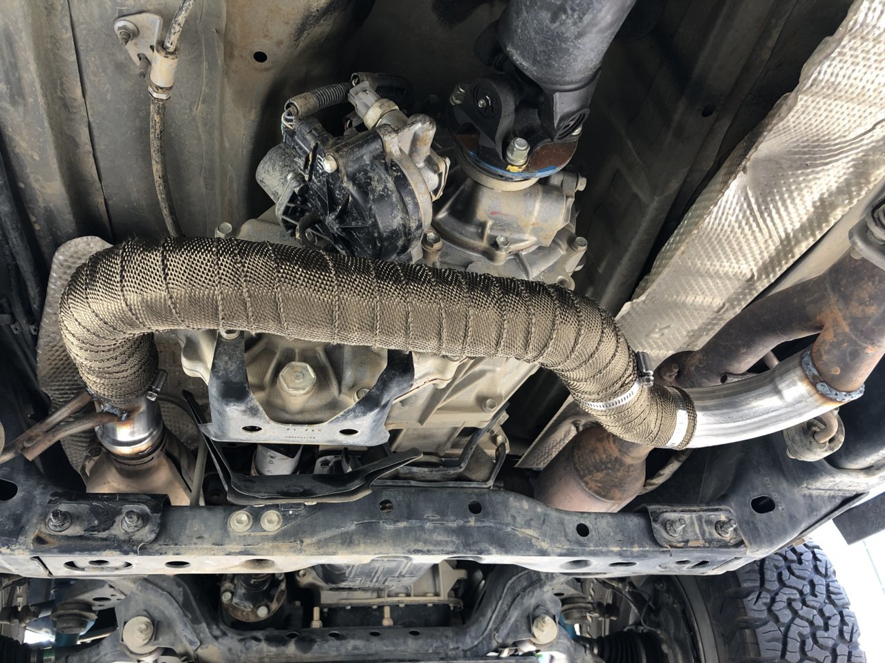

    Finally got around to getting the reroute done. Thanks to Exhaust Works in Belmont, CA.
    He tossed me a roll of Nomex to keep things cool and wrapped it up back home. Looking clean!

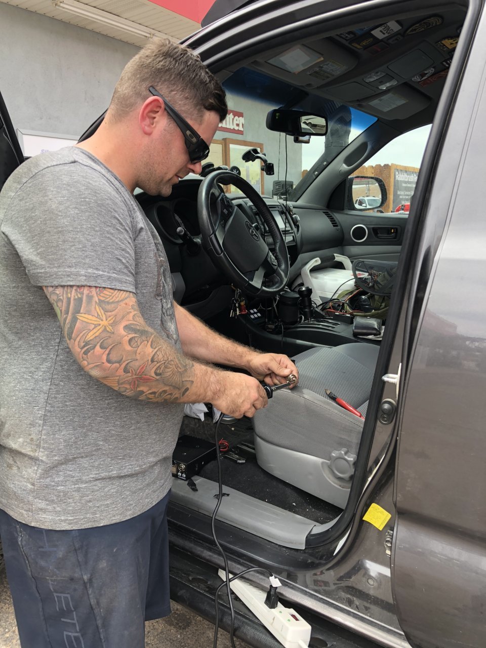

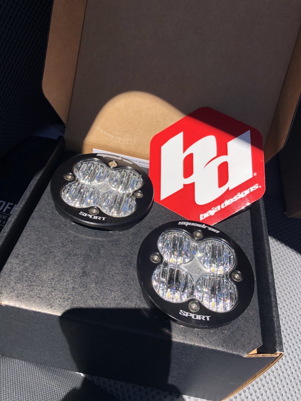

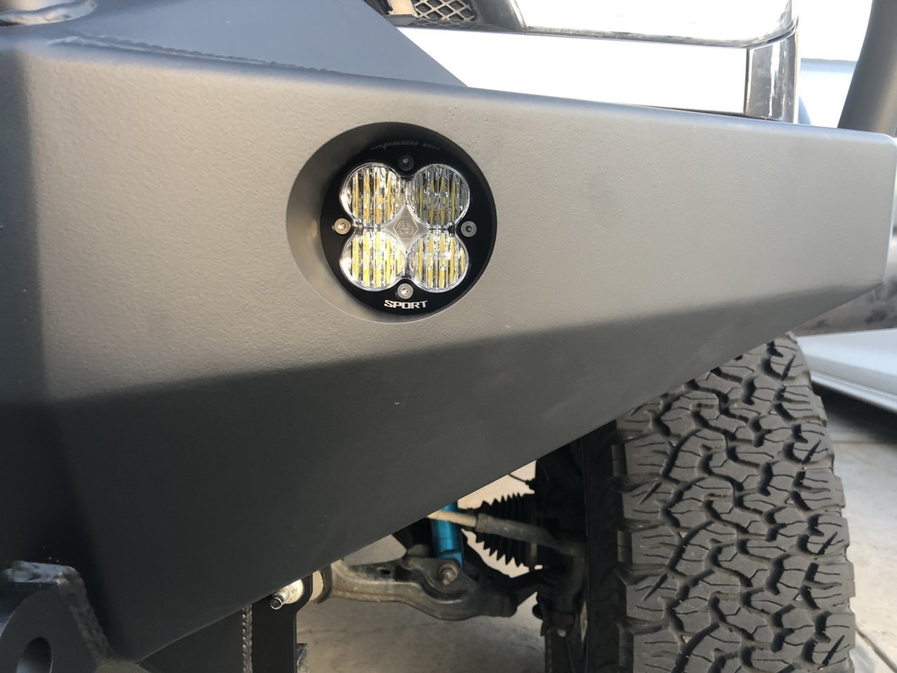

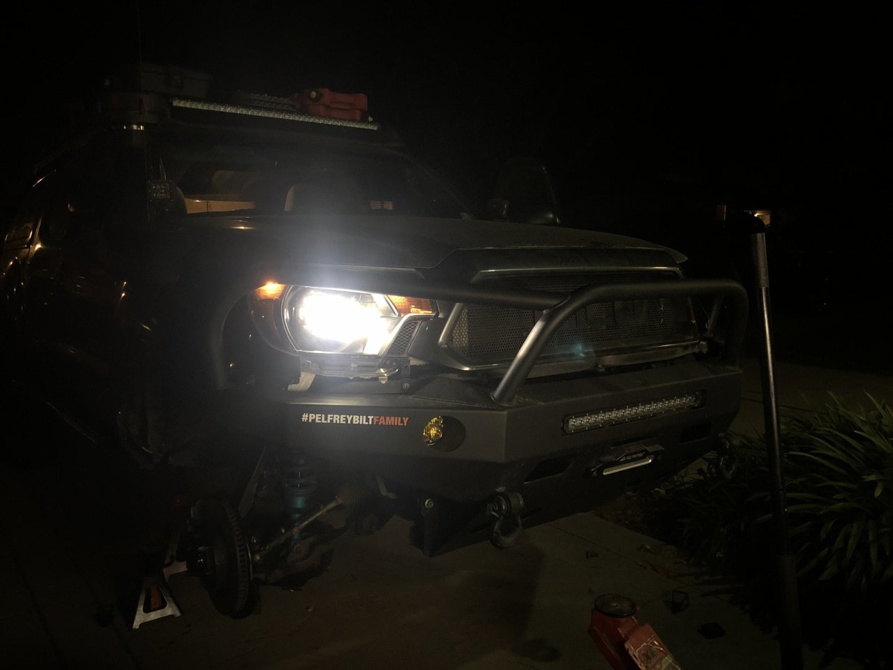

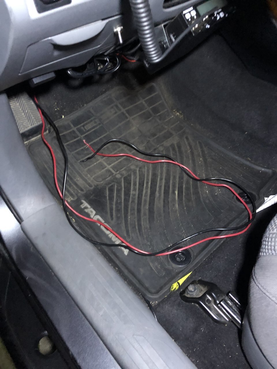

    Had to do a dirty install at first. Wired up the Baja Design in the fog location. Grabbed a couple eBay specials for the bumper and prinsu rack. One day I’ll get to switching them out but it does the trick and for under $100 for both I can live with it if they break.
    Originally picked up custom switches for an Iggy plate to mount below the HVAC bit scratched that and went big with a switch pro 9100 setup. I didn’t take a photo but ended up 3M taping it for the Utah trip.
    E3BFB472-6D57-4105-B57B-51C13F0B3E97.jpg E10A0A1D-00B5-4009-A8C5-A74F9FCBF875.jpg A6F22829-4DDE-4385-8779-1B85078D7962.jpg 3E8E0AB2-6748-4878-BCF6-53D68CDB0989.jpg
    This is Post Utah after my Powertray arrived (the day after I left). Worked out well and super clean. Plan to tidy it up some more bit it will do for now. Set it up with an extra BlueSea 6 fuse for additional accessories and separate power blocks (positive/negative). Makes it super easy to add or connect whenever I have additional accessories.

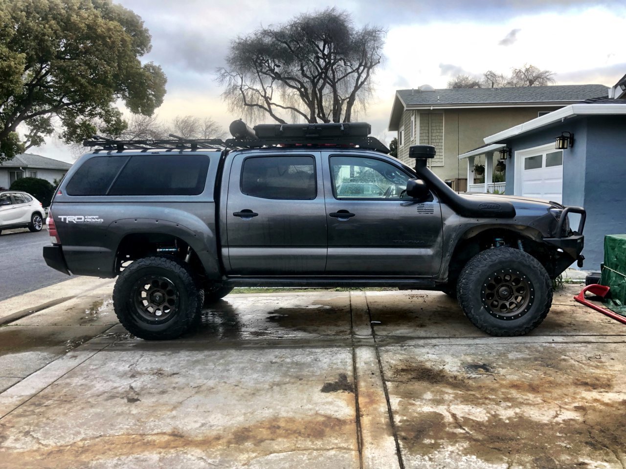

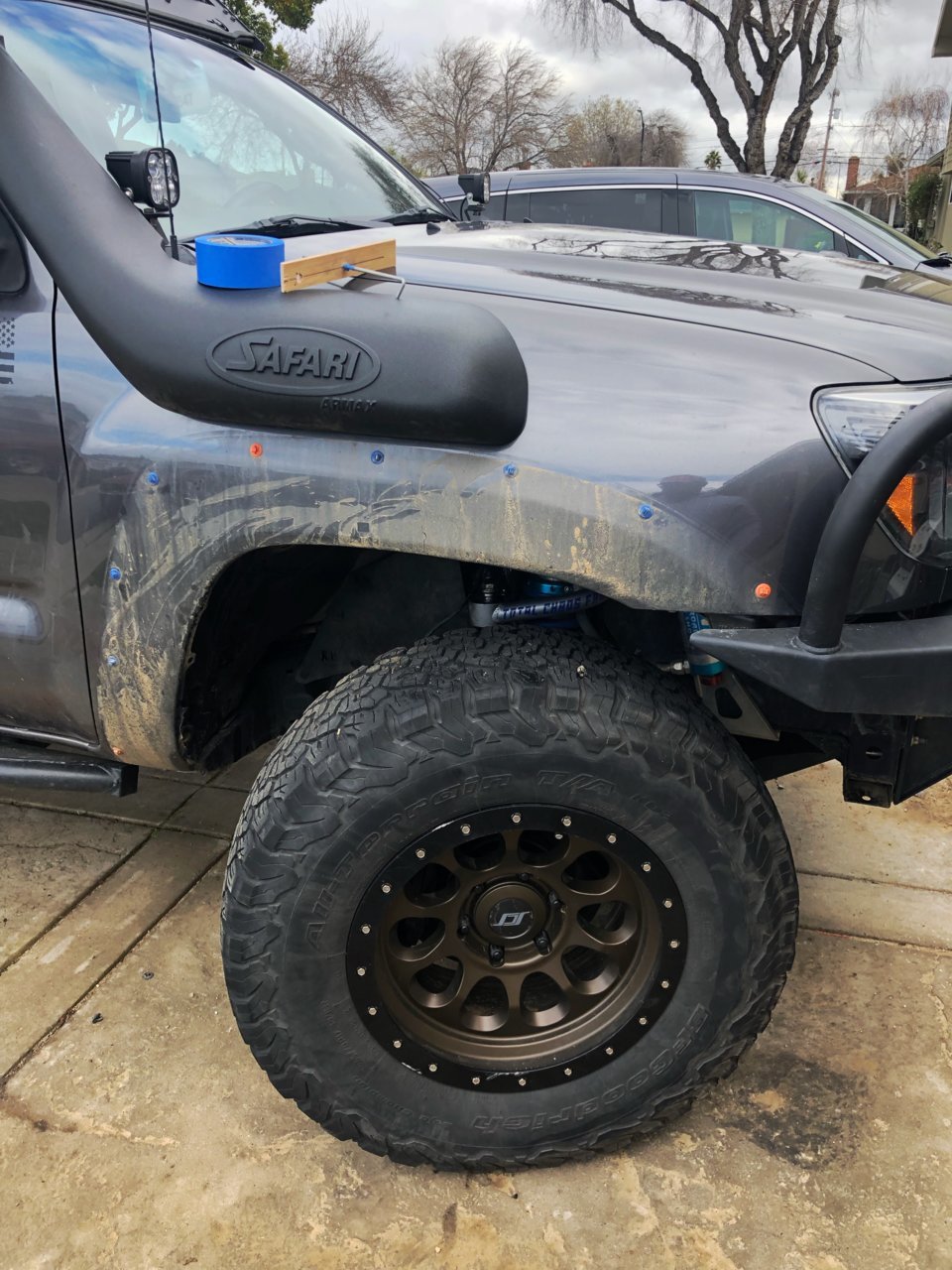

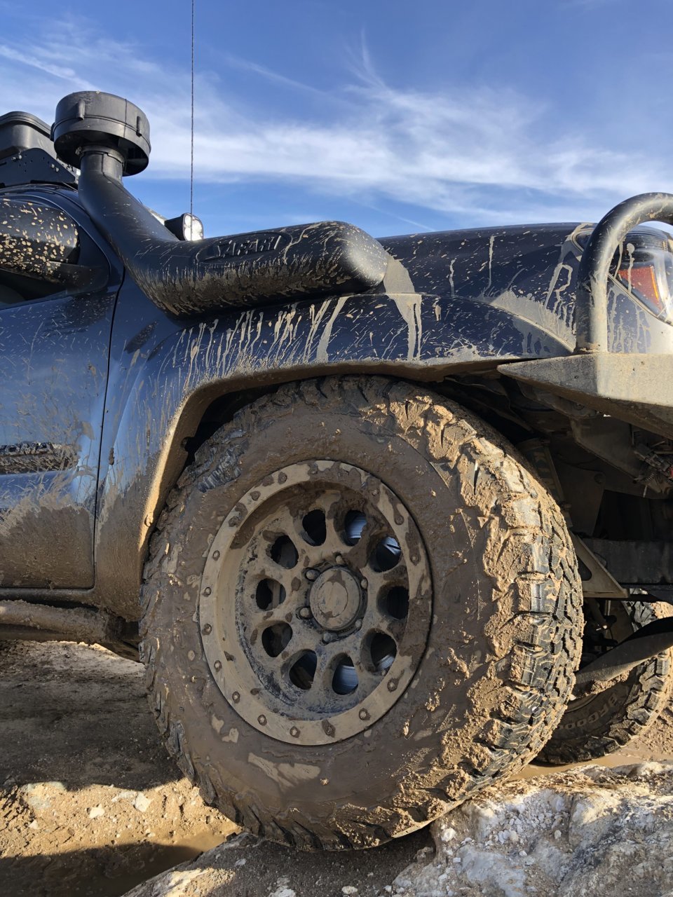

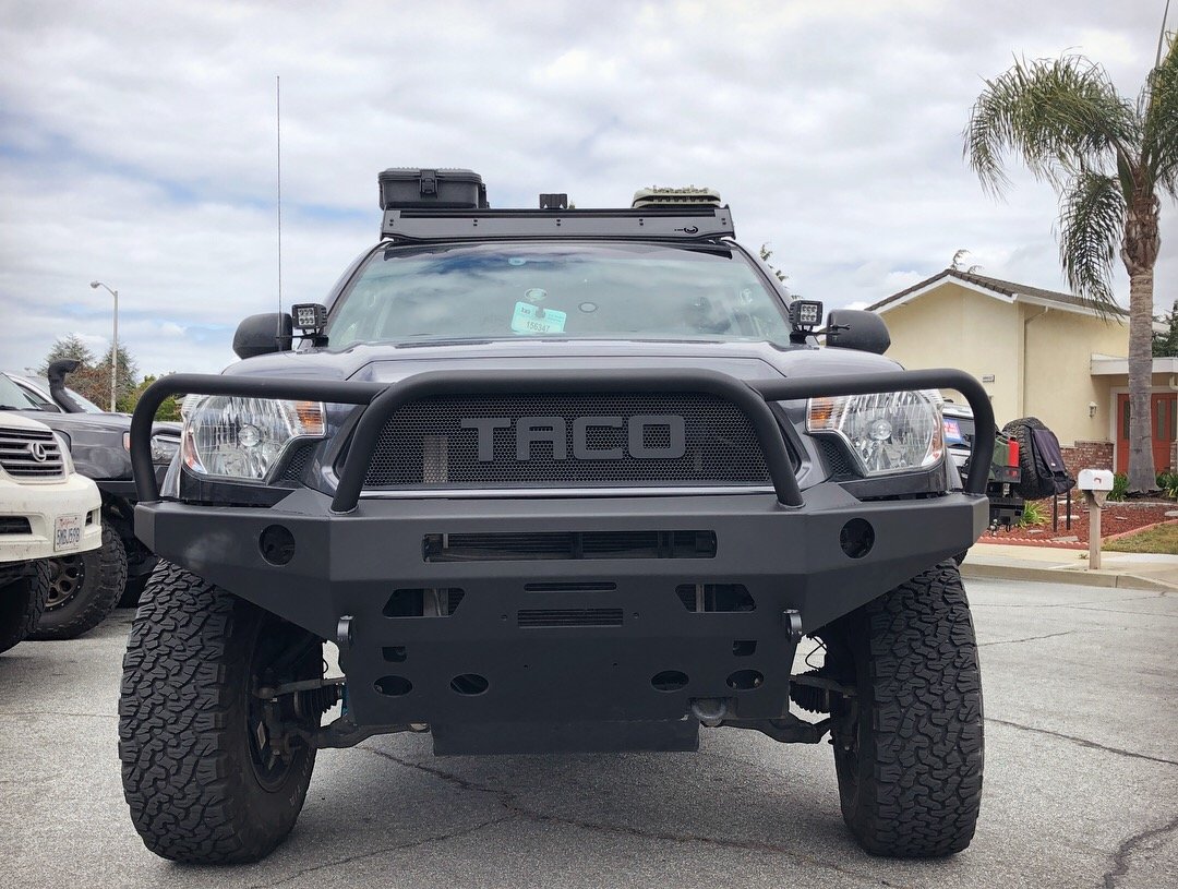

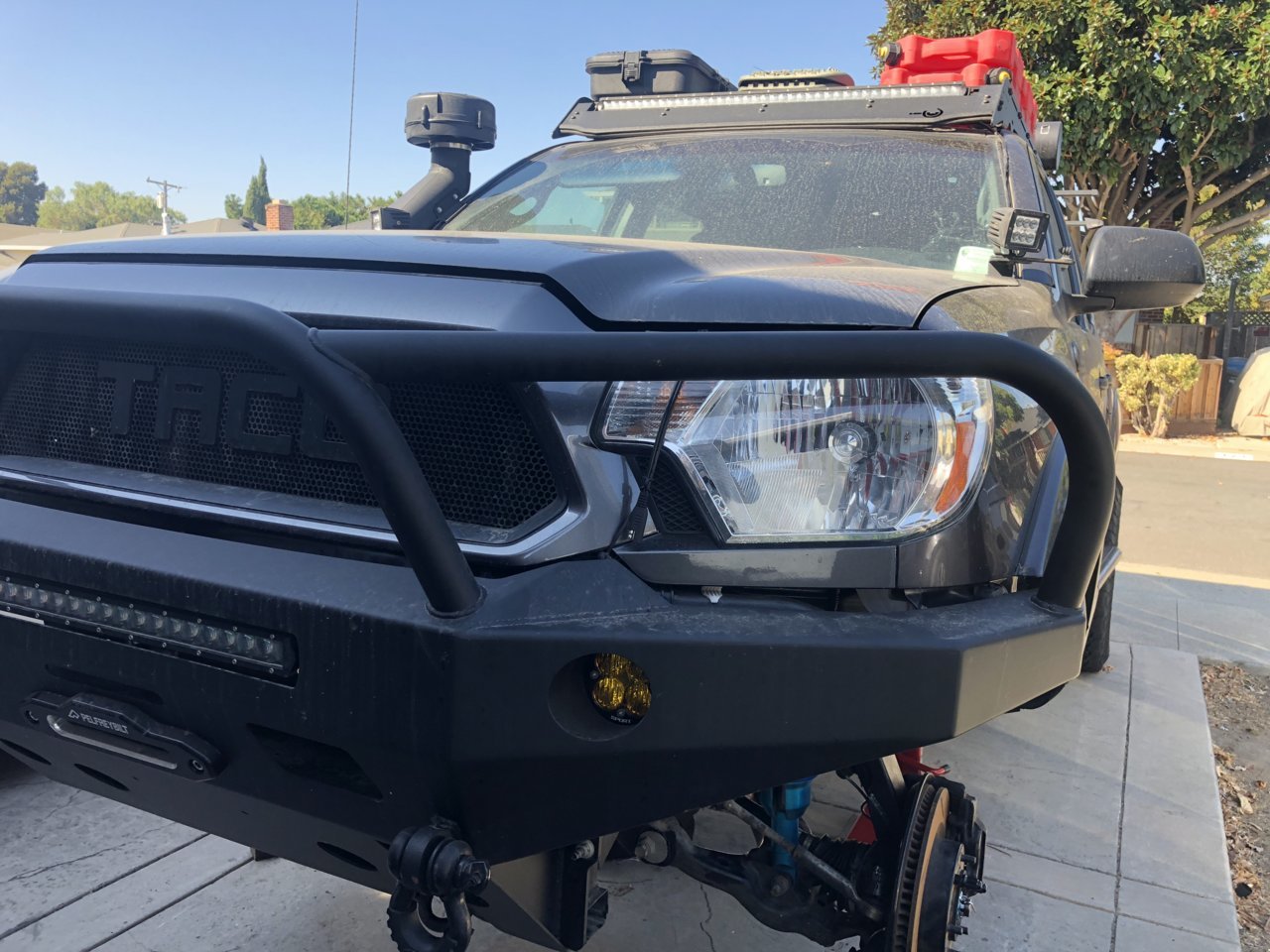

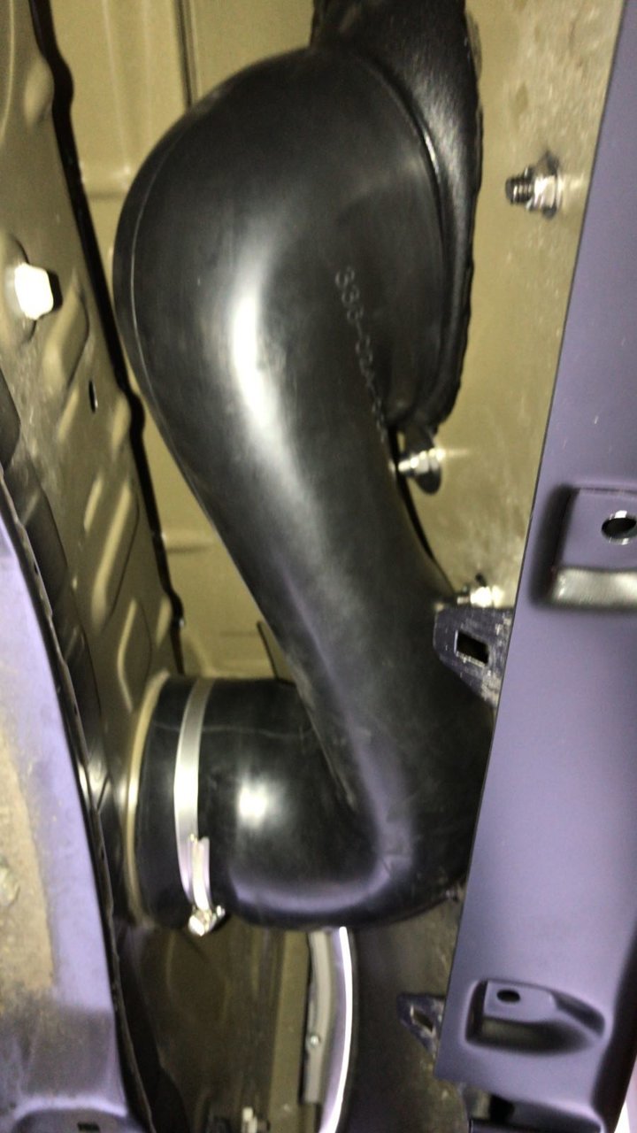

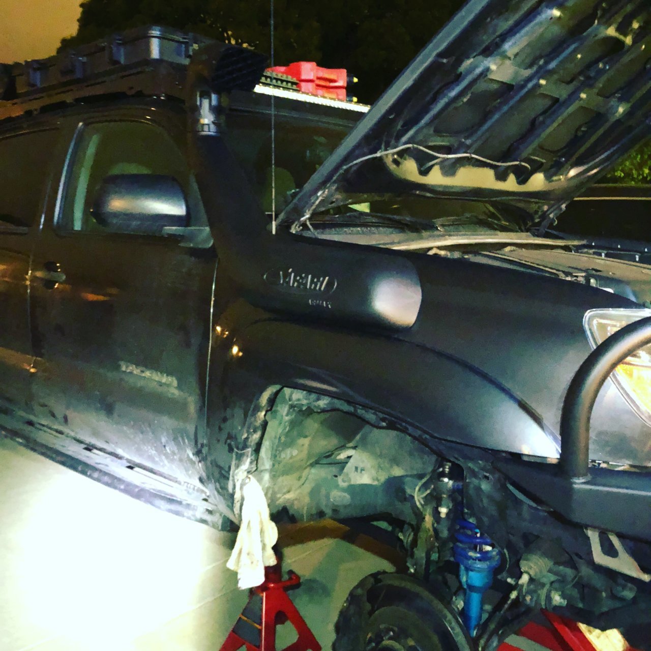

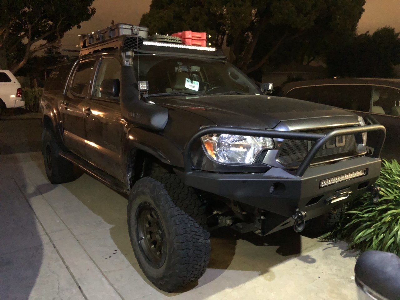

    Just in time and day before we take off Snorkel is going on! A bit of a pain. But overall not too bad. @alvinfromhawaii anf I had a taco cutting party!
    2AAE666E-3352-4E4D-AD7D-9B1A1EC06E8B.jpg DC72DB6C-3BAC-45D7-AAD2-9ED39F6839F4.jpg
    AB203D88-07E3-4D4D-BA00-9DEFC3B94B22.jpg 9017310B-1A56-44F6-89C0-7217D9B496C1.jpg
    DBF8DE73-3C4E-4D36-9AD6-48194AFB46BB.jpg 6F8A558C-E94B-4434-97FE-3CA6A8318273.jpg

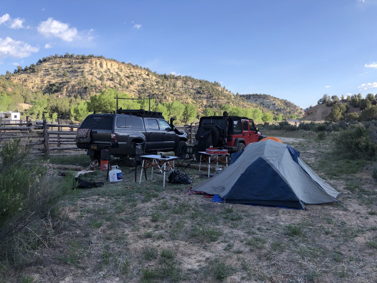

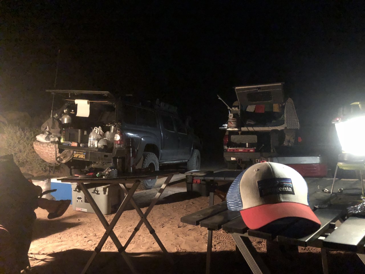

    Back in May a few of us hit up Utah. A few hit up Overland West but I was not able to make it so headed up with a buddy to meet up in Utah.
    We still need to pull the pictures off our DSLRs but here’s some form my phone. If you ever get a chance to make it to Canyonlands check out the Maze District. I can’t wait to explore the rest of the park.
    Stopped off in Mojave for our first stop. Didn’t get a chance to explore as we rolled in at almost 3 am.
    Quick drive through Zion National Park. Pretty epic but very yuppie in town. Need to go back and exploreFBF4B0E6-A417-496F-ACEB-1E92BBC59EA0.jpg
    BLM and disperses camping is everywhere. Found a nice spot in East Zion. At least 20 other people had the same idea. Another group of Tacoma drove in sometime after us.C06C1086-882E-4687-99A0-E76CB53A4D29.jpg
    I think we hit every season on this trip. 5623E71F-9447-48E2-B244-511A8EA83A91.jpg
    Playing around outside of Hanksville at another dispersed spot.12F703B0-5F54-421F-A8ED-7184F36C2BF2.jpg 05024053-1717-4712-AE96-EB11648D0C6E.jpg 3F82A64A-81FC-469C-A758-0F5CCF7B04F3.jpg 5B85EDF1-87A7-425A-8A15-B7ECBC256E19.jpg B21BDE41-2AB6-4B4D-BAB8-BC7625C0D301.jpg
    When the group rolls deep with CB you install one at the gas station. HAM was ready as well.136B46CC-D706-46FF-B94C-4BF6E2B1BDBC.jpg E1B2A836-AF6D-4965-8C43-17A4B2DA582D.jpg

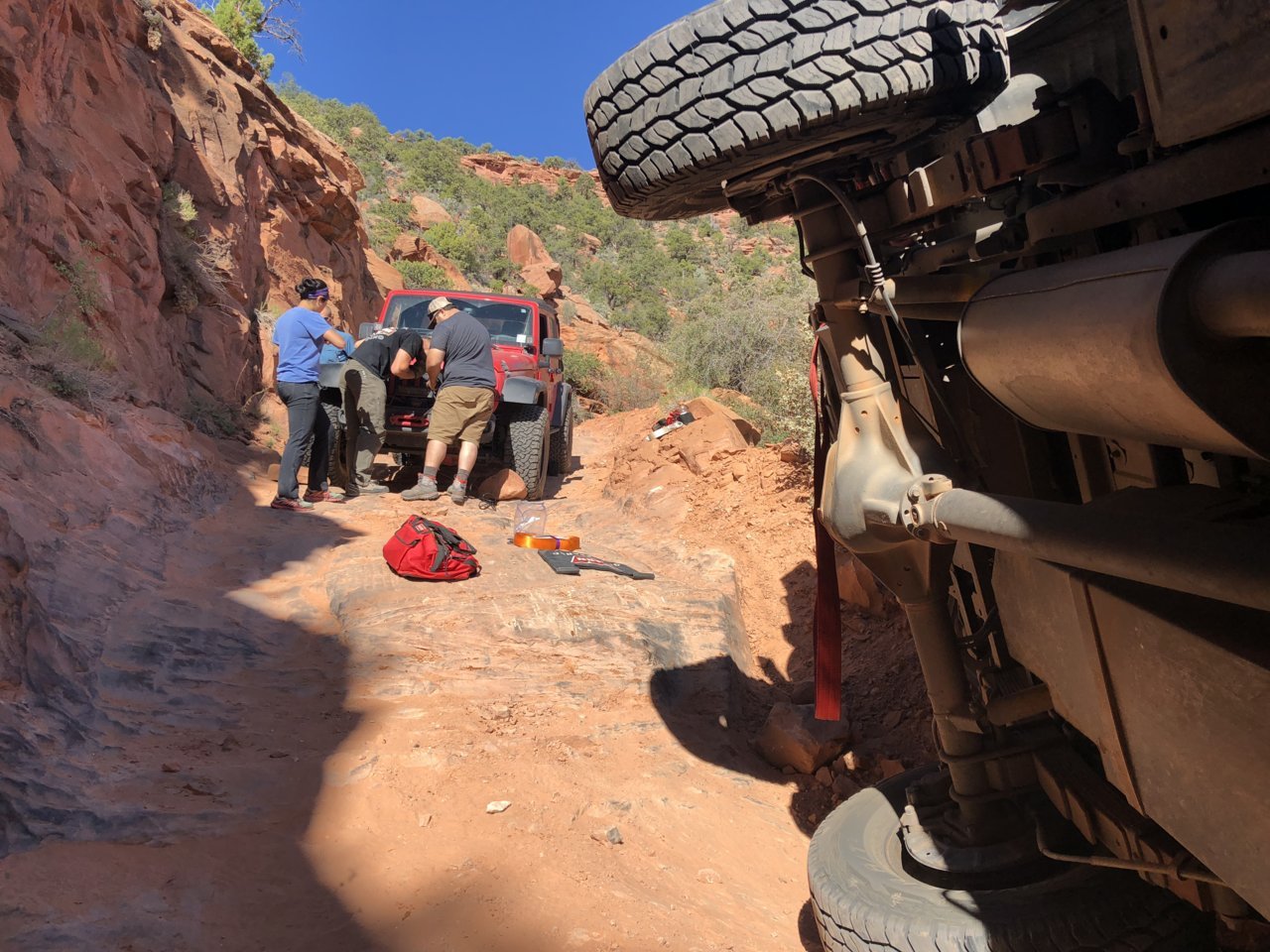

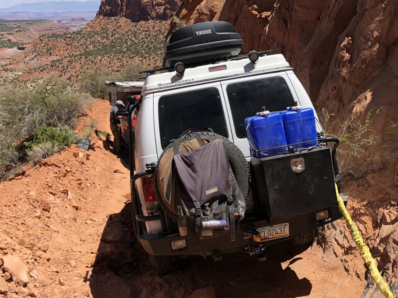

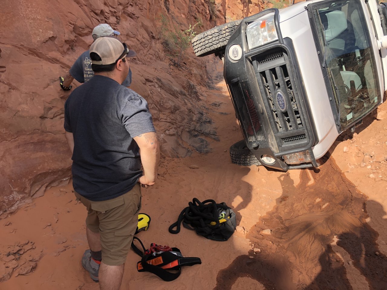

    We had a little mishap on the trial. After several hours of working together we had her upright with minimal damage and loss of fuel. No injuries.D9F9DC36-2946-4B09-A905-261B552C561E.jpg 31BE9872-C20D-4D5E-B86B-06516786A0A6.jpg
    Providing support as the anchor in the chain.4F1F98B0-8990-41D9-AC06-7A4CA639C0E0.jpg 2AAAFF8C-521C-4DB8-A26D-009316FE2C45.jpg 0E1A9385-243B-4684-B915-CE7117F5C16A.jpg 437D3626-12EB-4717-A906-D056DC330A5B.jpg 0886E11C-6FC9-4ADA-8171-17AB879C6209.jpg
    @Toynado showing off his solar setup8CD7E8DB-EEF8-4CFB-8C2B-079BFDF12EDC.jpg 44477588-1ADE-423B-B2D0-D9E746975E7D.jpg
    Last campsite sat above the Colorado river to say it was amazing is an understatement.973958FC-3B03-4315-9249-90D4AEA6D036.jpg DF57D936-EE4E-4C56-8BFE-EE998982A34E.jpg
    Tried to stop here on the way in but it was pouring rain. Butch Cassidy’s child hood home.D50F08D4-79EE-4D20-BF62-FD0966746F6B.jpg

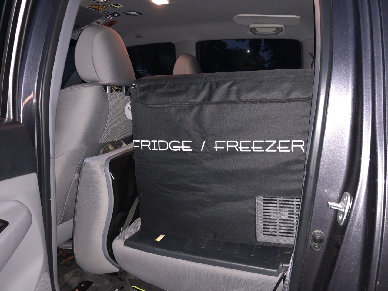

    After Utah that was enough with depending on ice and coolers. I’ll pack a cooler but having a fridge is clutch. No more soggy meat at camp!
    Grabbed the CSI 52 qt fridge from @Mike's Custom Toys and set it up temporarilly in the back seat. I plan to move to the bed when the fridge slide arrived.
    67597DC6-3A88-467E-9539-6570A11ECE35.jpg C5EC33B3-4119-4646-97E9-33A2913A0927.jpg 54DEB1B3-7E39-456A-8B6D-56CAA371AE87.jpg

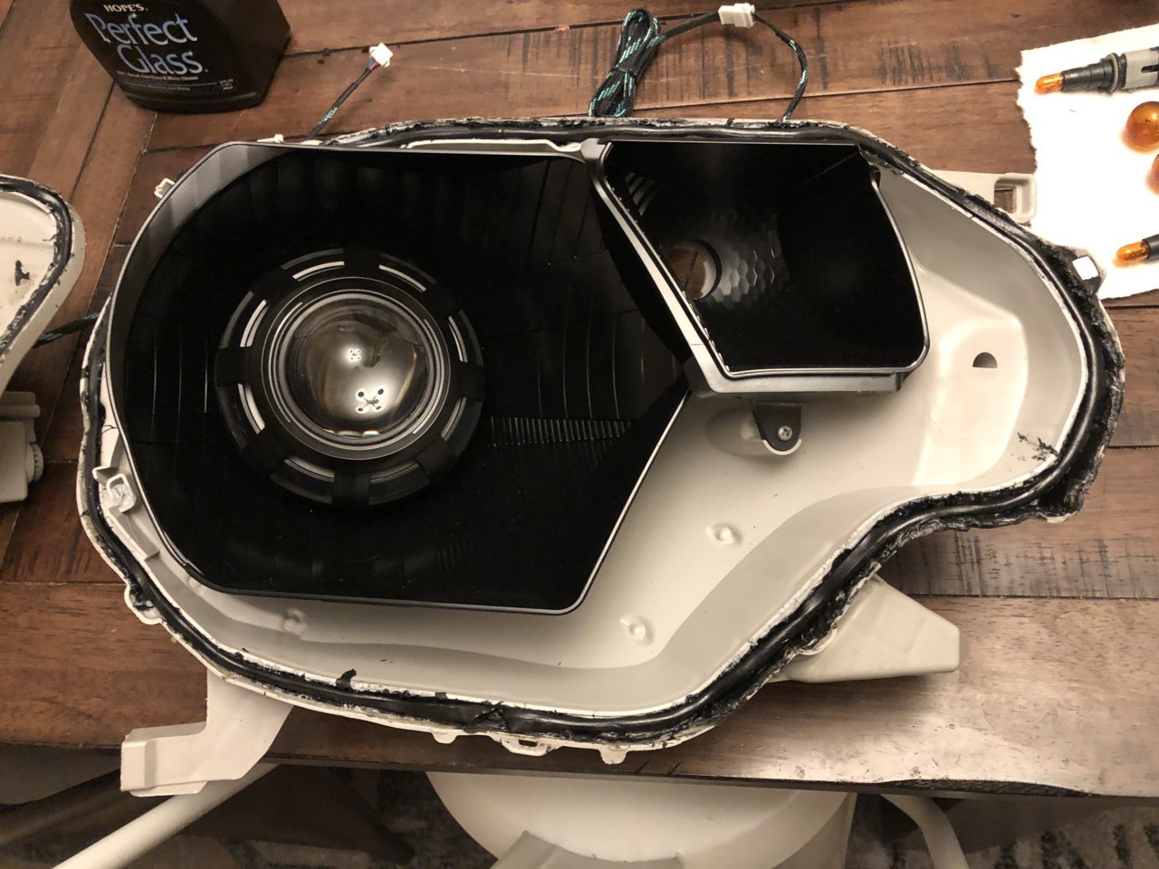

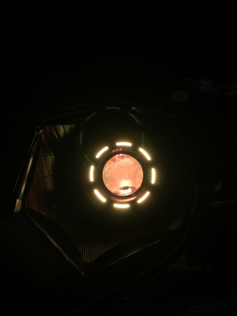

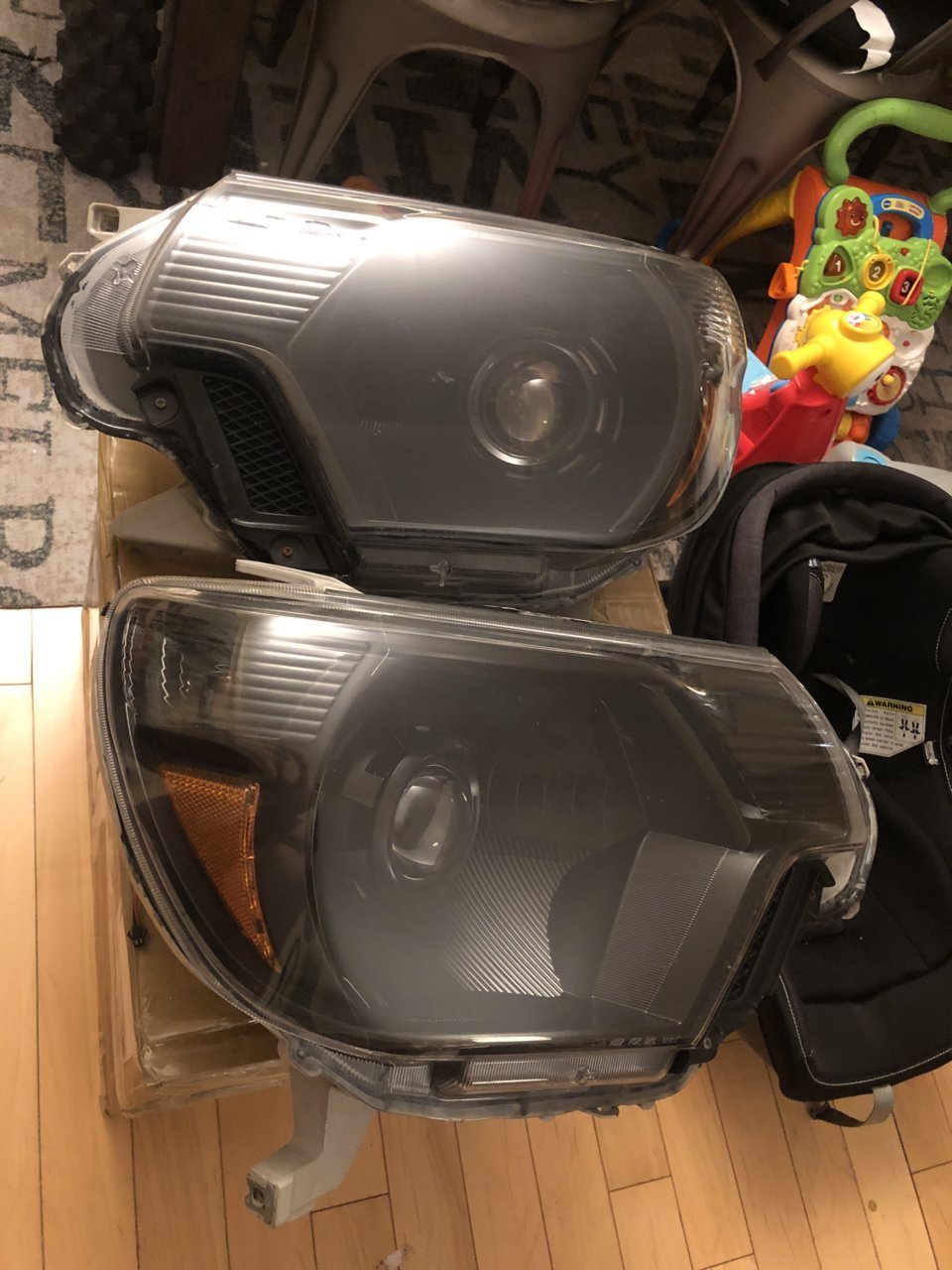

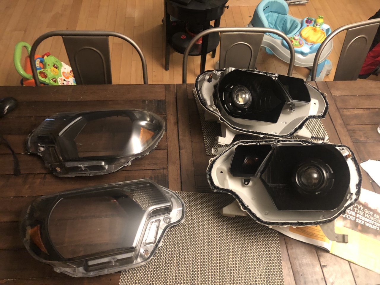

    Been slacking on updates but here you go @TRlPPlN.Still need to adjust the headlights some more and possibly reseal one. I fixed the shroud, added new prism halos and prism Daemon eyes. Output is not bad much better than before but not as bright as some other retros I have seen. Started out as a $200 TLC project not bad.
    E87688D8-E40C-483D-B131-1AB769EC6B6B.jpg A5B5AED3-EF7A-4DBF-A5E4-256B2A6E7A5A.jpg 077CDDF4-A1CC-4571-A1DC-099CB6DBBD62.jpg D37BEF31-2B7A-41B1-9C6C-87B7F46A38B6.jpg 70ACA224-CE29-41D2-9F23-3CE22A37AF2A.jpg FF9ACAB8-FEFE-4074-AFBF-32D9504BD9B4.jpg 1A48C00E-353F-48F5-8692-30239C77BFA3.jpg 464065F3-E6A1-4ECF-8AF7-1AE613871FB2.jpg 7C750B3E-0A40-4EA3-8494-93C74FBD6C14.jpg 8A54B099-51E9-45A0-B518-0FEAEE5E936F.jpg A6D2689B-029C-4948-8C71-0983678FE18D.jpg 8FFD5062-F8AD-480C-89E8-A23D60901801.jpg

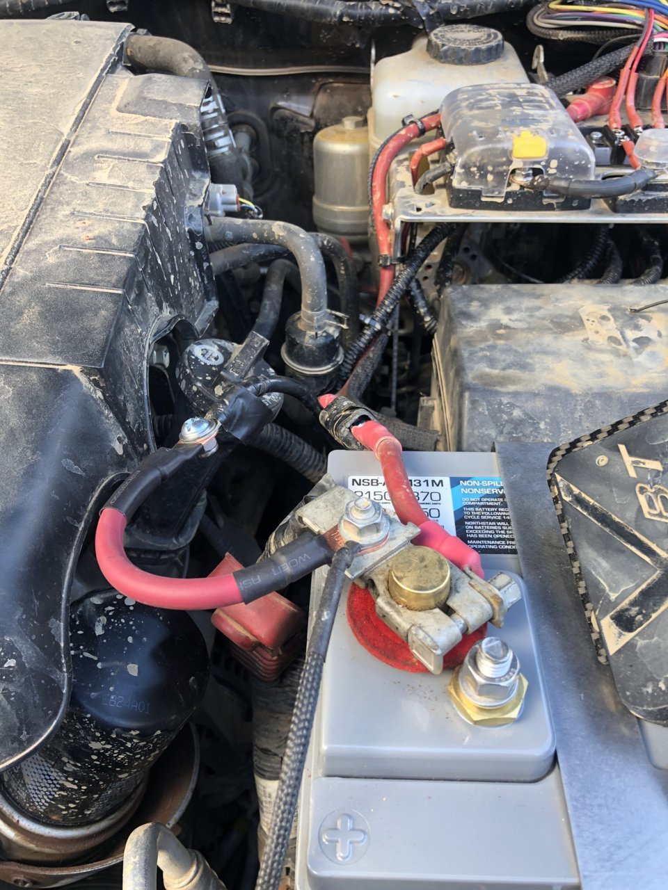

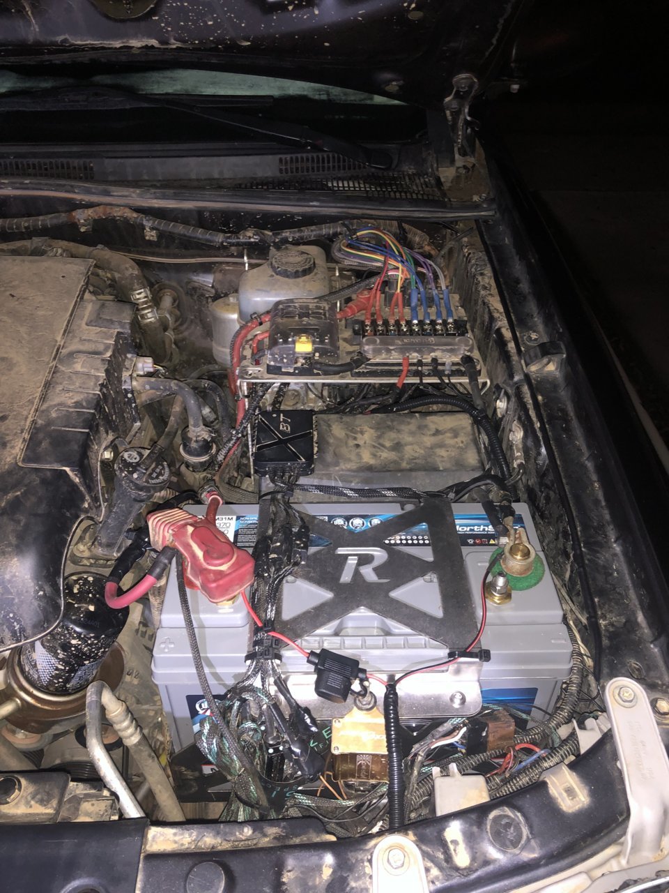

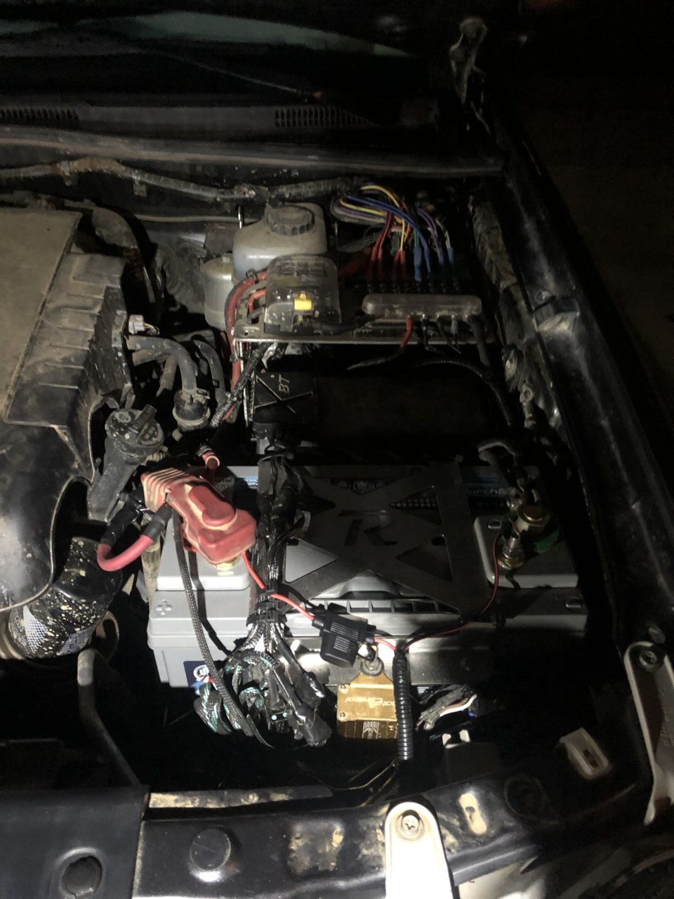

    Have not updated this in a bit. Rigs been busy with updates but not much action. Some fun stuff planned this year and more to come.

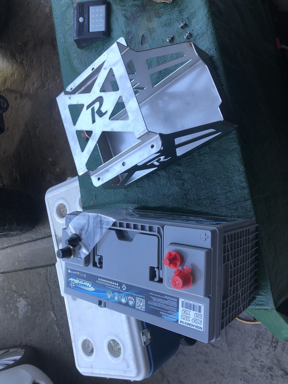

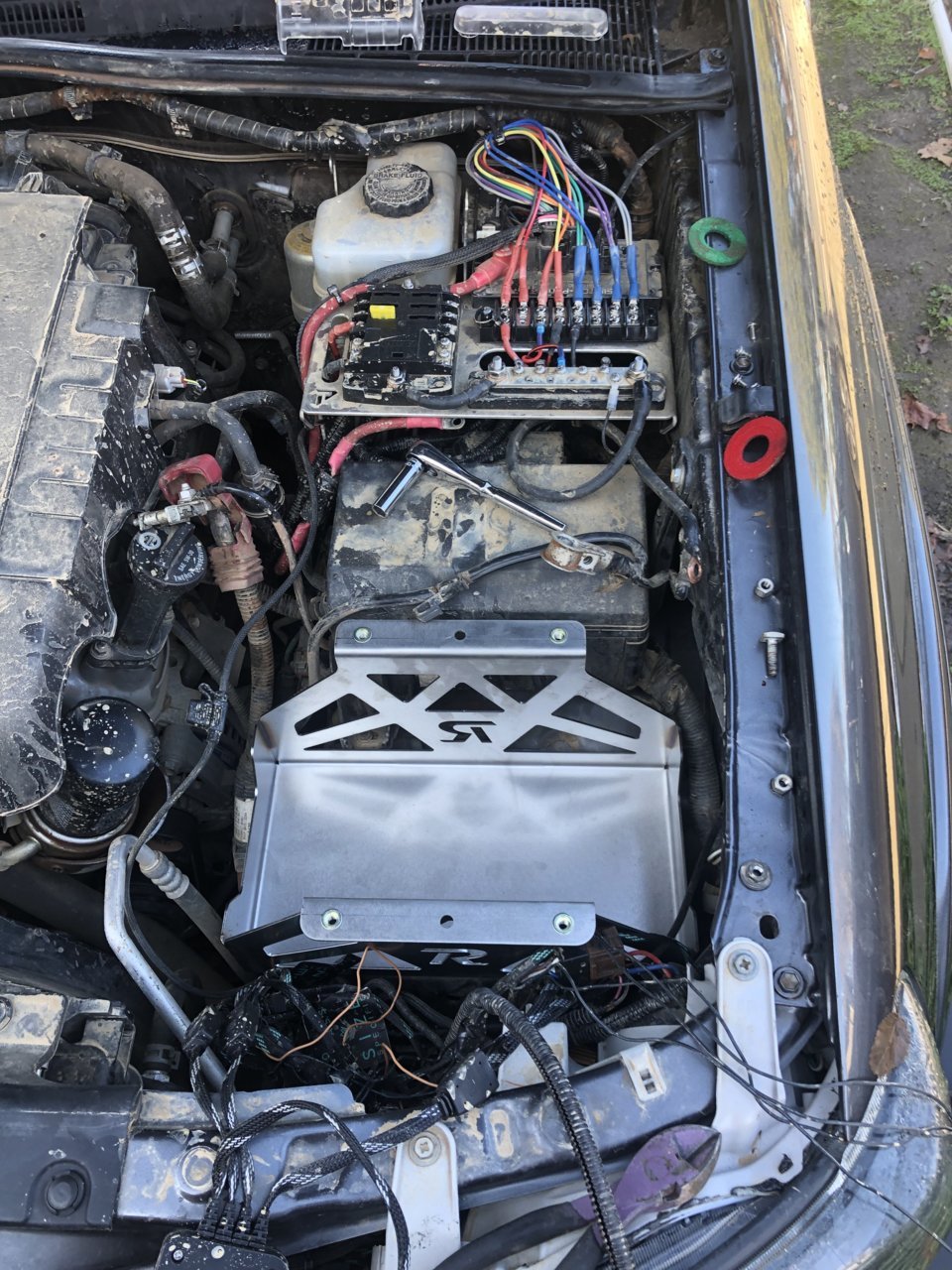

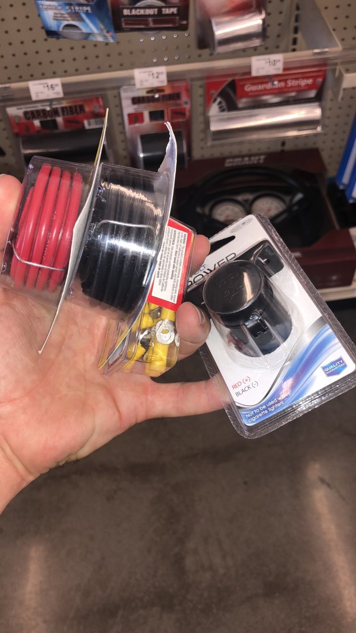

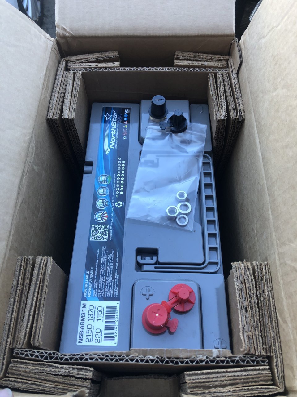

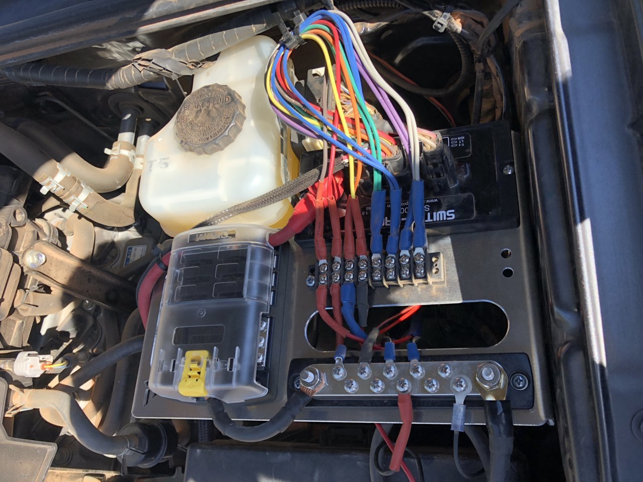

    With all the added accessories, fridge etc needed some upgrades to the power source. Hopped on the Northstar Group by and paired it with a @ragofabrication battery cage.
    Stupid 2nd gens have really short battery cables so had to improvise. Temporary extension until I get to the big 3 wire swap.
    I need to pull out the wires and and rewire but this will do for now.

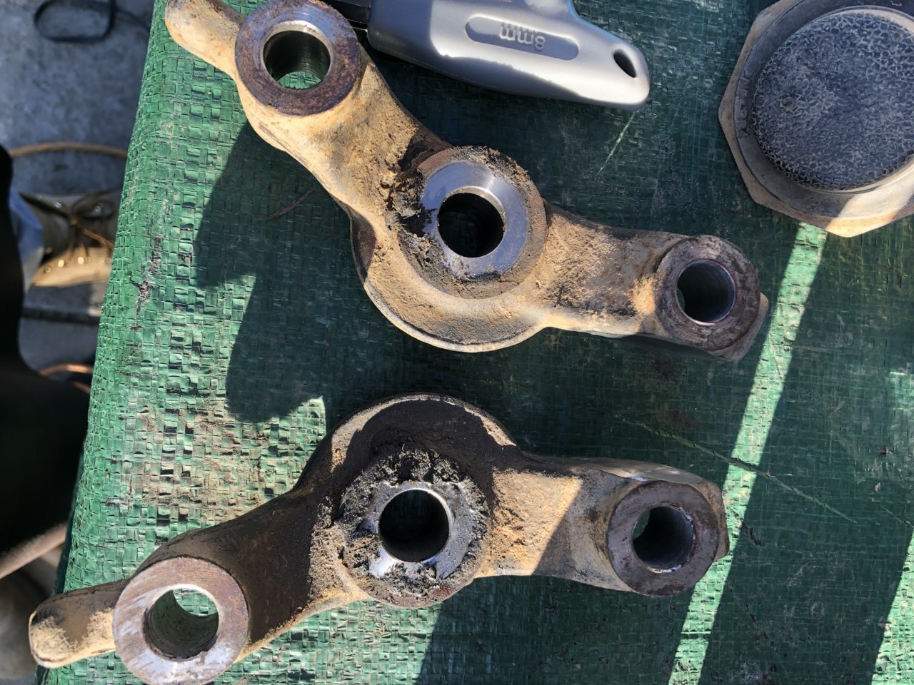

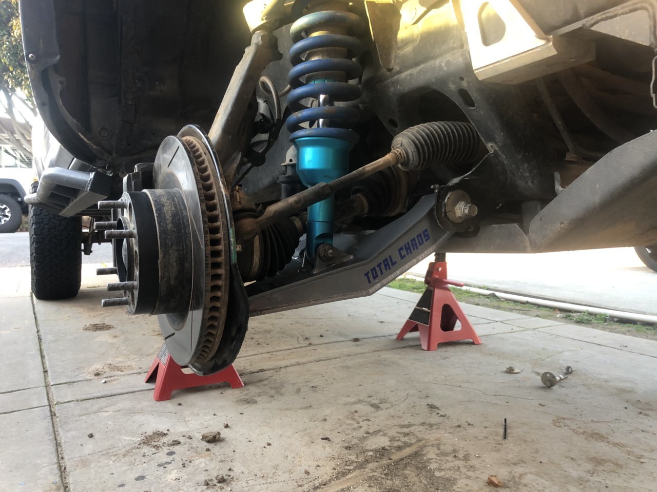

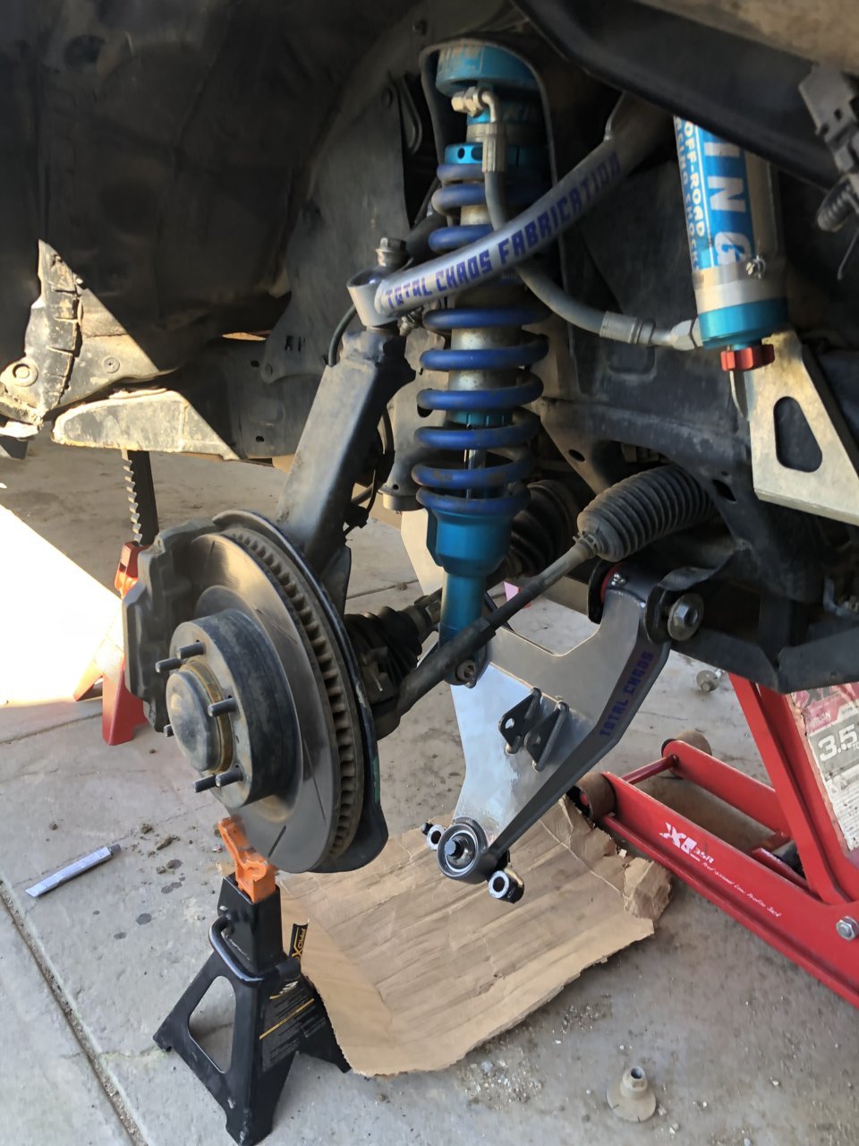

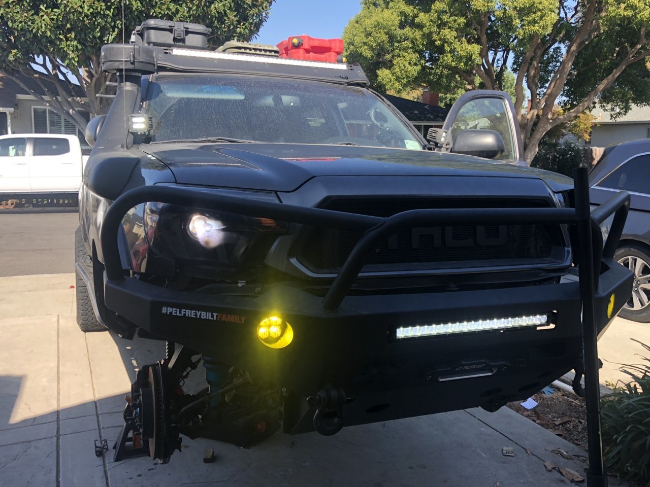

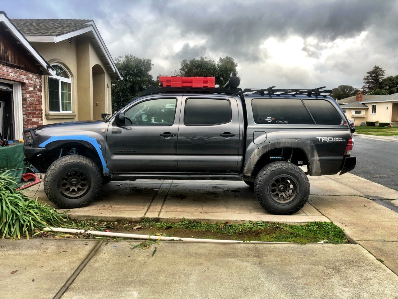

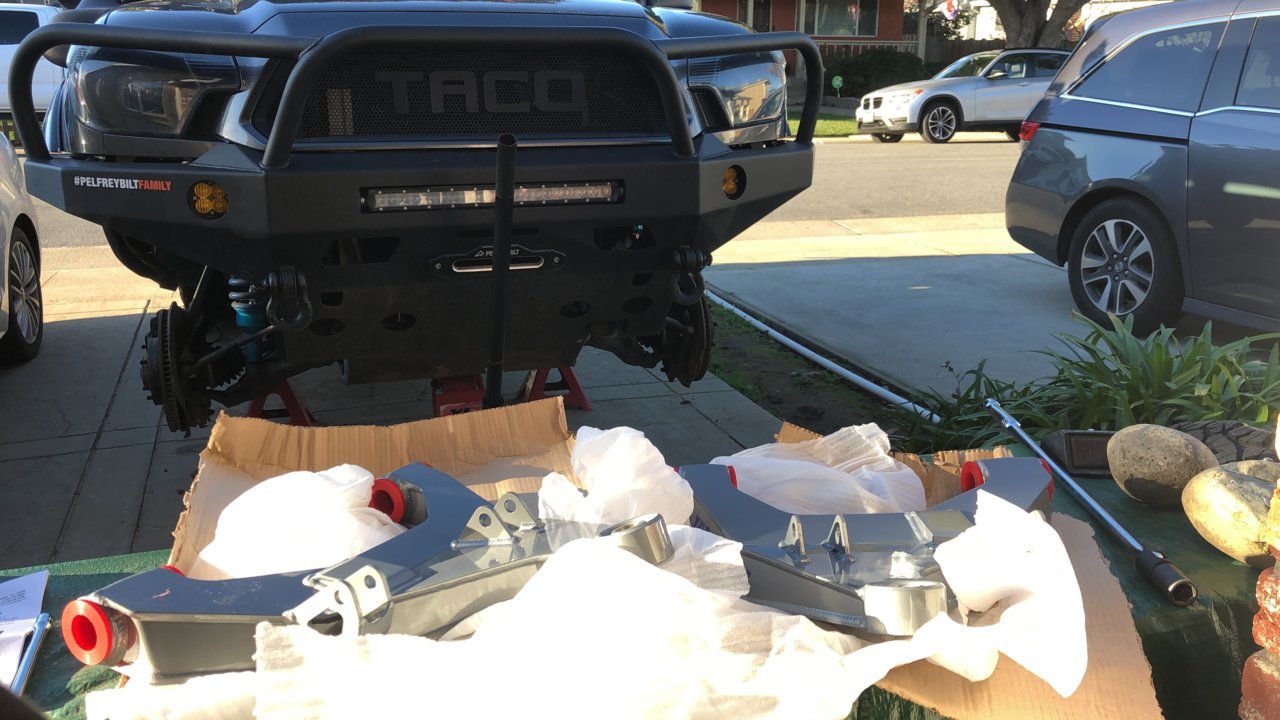

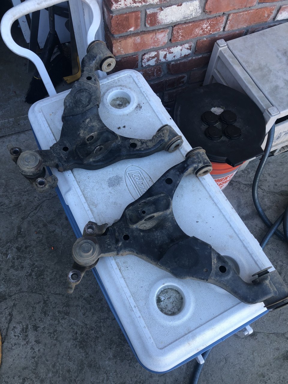

    Stock Lowers had to go as the first step of some upcoming suspension upgrades. Thanks to josh @Wheeler's Off-Road Inc and @TOTAL CHAOS for these beefy AF Total Chaos Stock Race dual shock lowers. All in all a pretty straight forward upgrade. Hardest part was cutting the steering stops off. Getting pretty used to pulling this rig apart.
    Photo Feb 21, 10 13 00 AM.jpg Photo Feb 18, 4 39 08 PM.jpg Photo Feb 21, 4 12 41 PM.jpg Photo Feb 21, 4 31 46 PM.jpg Photo Feb 22, 12 51 17 PM.jpg Photo Feb 22, 5 30 23 PM.jpg Photo Feb 23, 11 43 10 AM.jpg

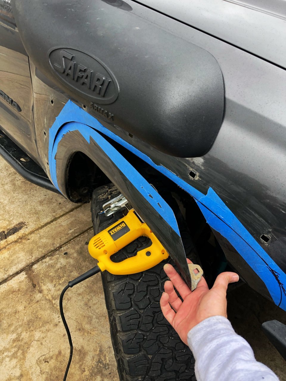

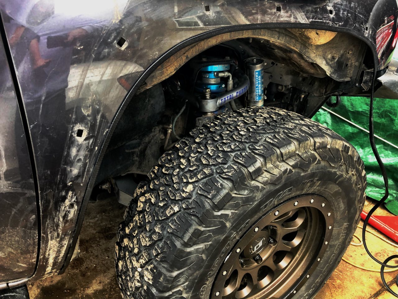

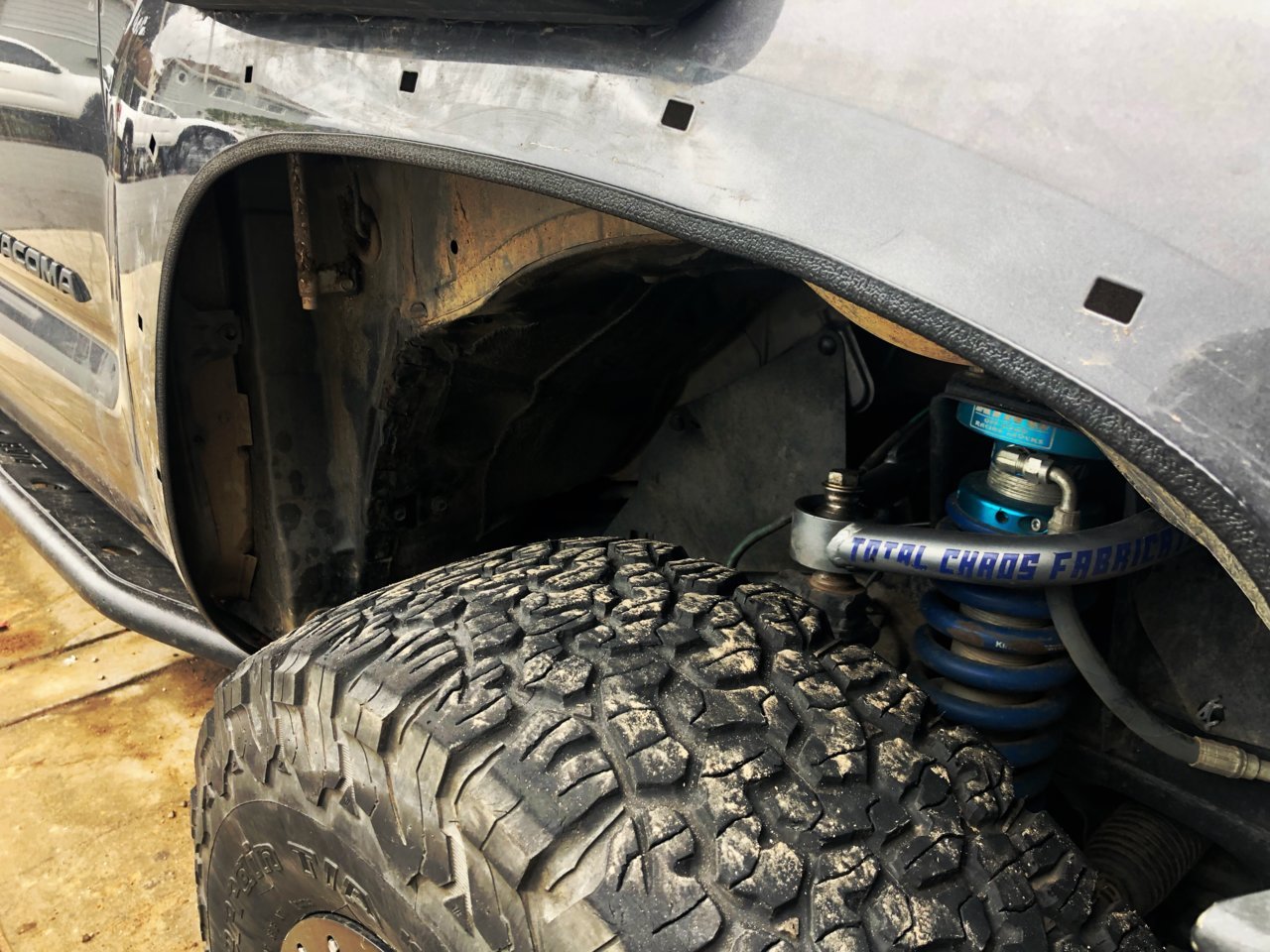

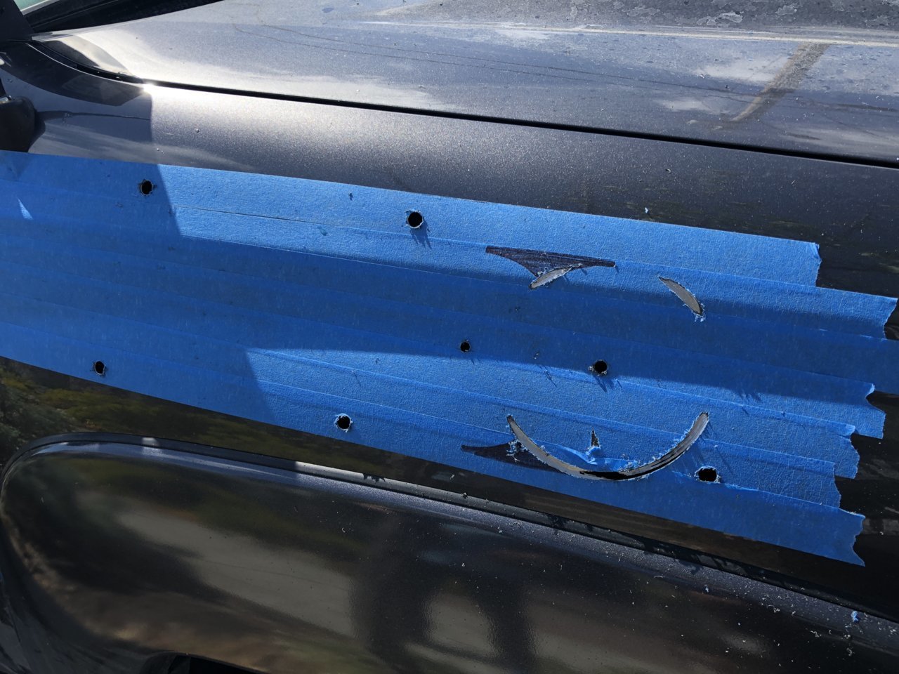

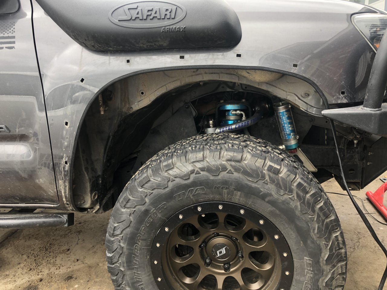

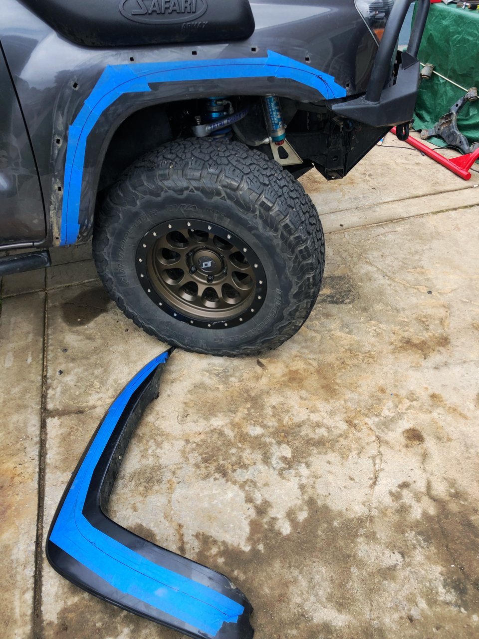

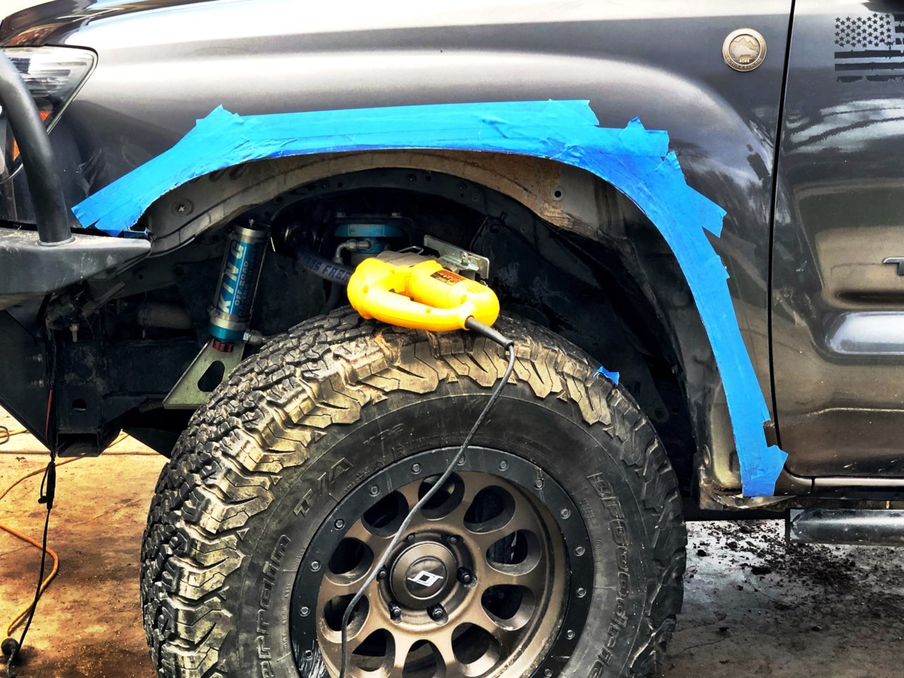

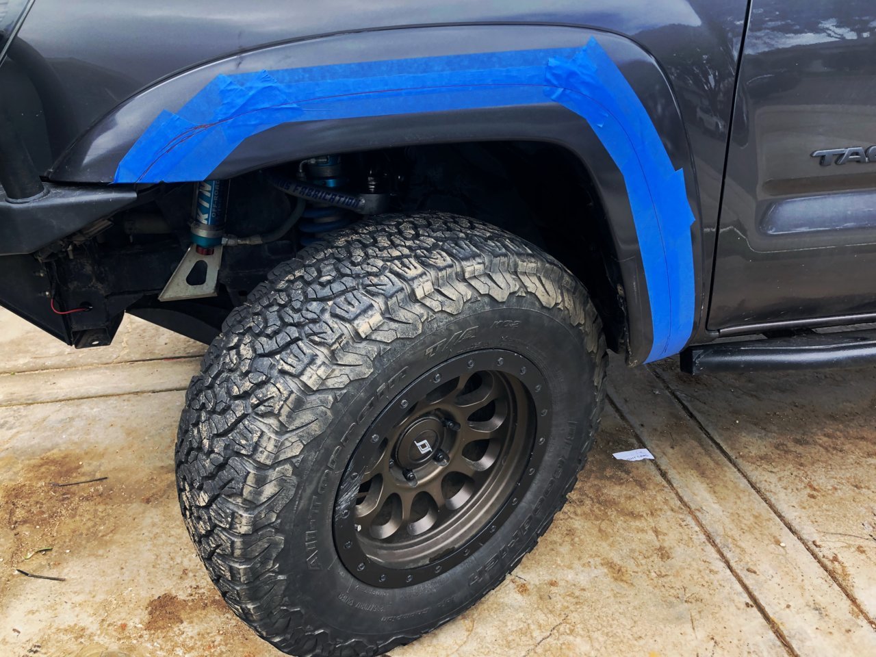

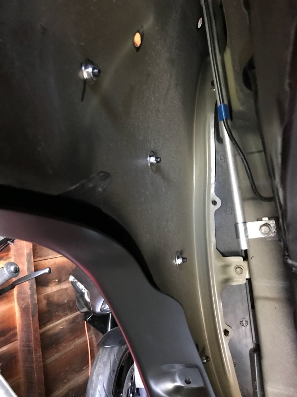

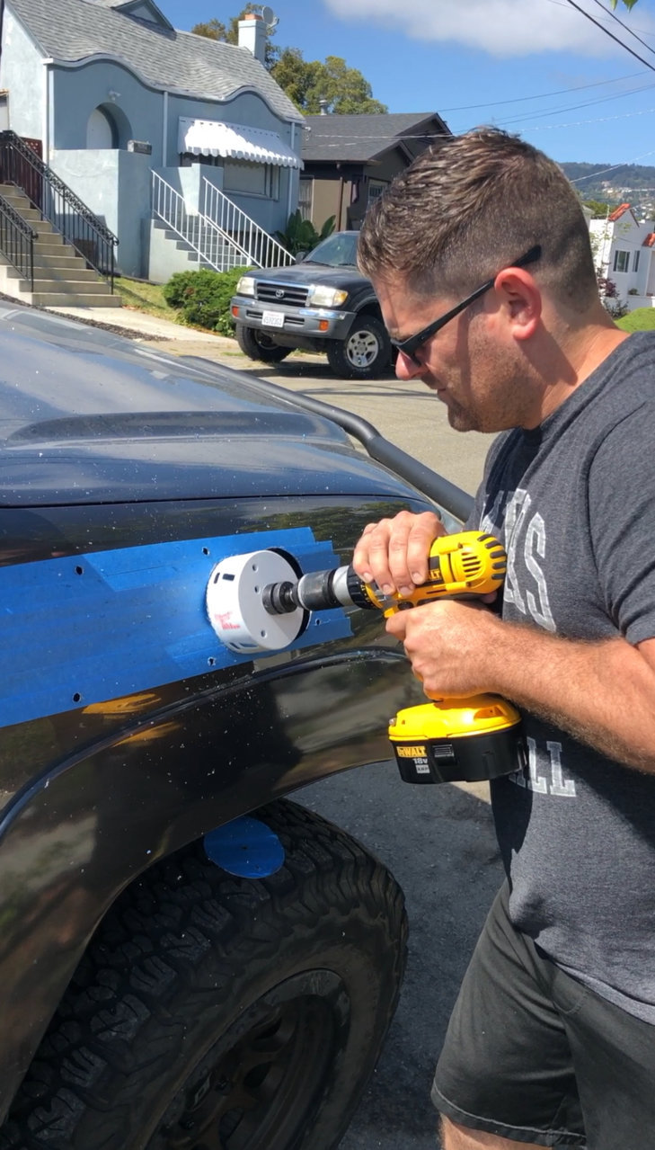

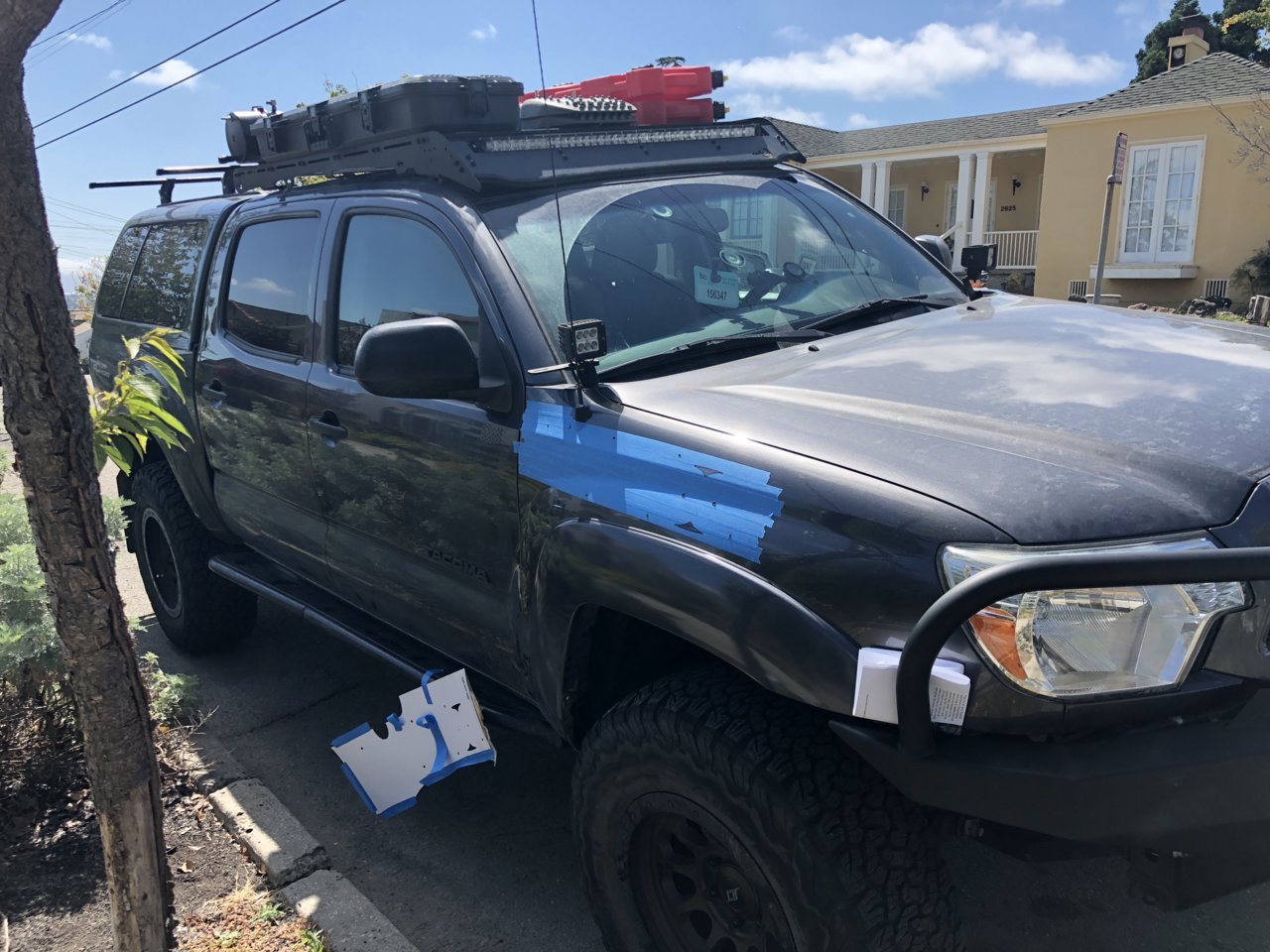

    So I started a thing this week... I wonder whats next... Front fenders complete. Still need to trim the flares. Took a good 3.25" off the fenders. Taking 3" off the flares. Still need to take the BFH to the wheel wells and redo the CMC. Edged up the fenders with some trim from Nathan (@SMKYTXN) over at Trail Toys. Picked up 20 feet for front and rear but not sure thats going to cut it. Was hoping to have some left over for a HC cut down the line. Finished off some of the corner areas with the angle grinder. Just be careful if you use this as it cuts fast.
    Quick setup for lining up the fenders. A few parts were tricky due to missing section of the fender that were either beat in with a hammer or cut on the trail.
    Photo Mar 03, 12 23 36 PM.jpg Photo Mar 03, 10 30 57 AM (1).jpg Photo Mar 03, 10 40 59 AM.jpg Photo Mar 03, 10 30 50 AM (1).jpg Photo Mar 03, 11 51 37 AM (1).jpg
    No turning back now..... the variable speed jigsaw was money. Get the right blade and it cut with ease and was easy to control. Will probably use a Dremel or similar for the flares.
    Photo Mar 03, 12 27 46 PM.jpg Photo Mar 03, 4 20 27 PM.jpg Photo Mar 03, 1 15 41 PM.jpg Photo Mar 03, 4 33 07 PM.jpg Photo Mar 03, 4 33 07 PM.jpg Photo Mar 03, 4 48 08 PM.jpg
    Holy Gap batman! Need to get these filled up pronto...

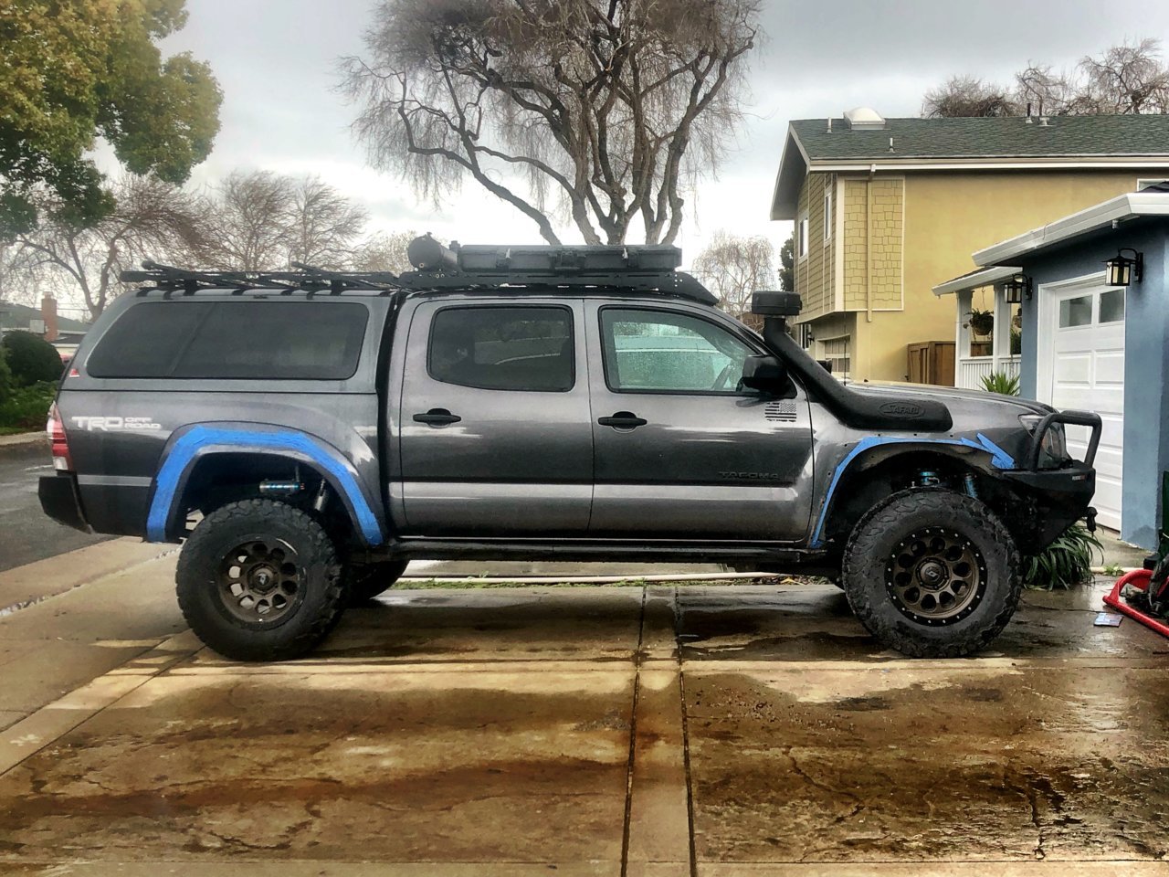

    End result was awesome! They are all right the first cut is the hardest after then you cut away. Just make sure to measure 1000x's before you cut. I had a couple minor spots on the front of the drivers side that were a bit off but covered by the trim. The front part of the cut did not run perfect that I could trace so had to go at it freehand.
    SMKYTXN and HIghlande2 like this.

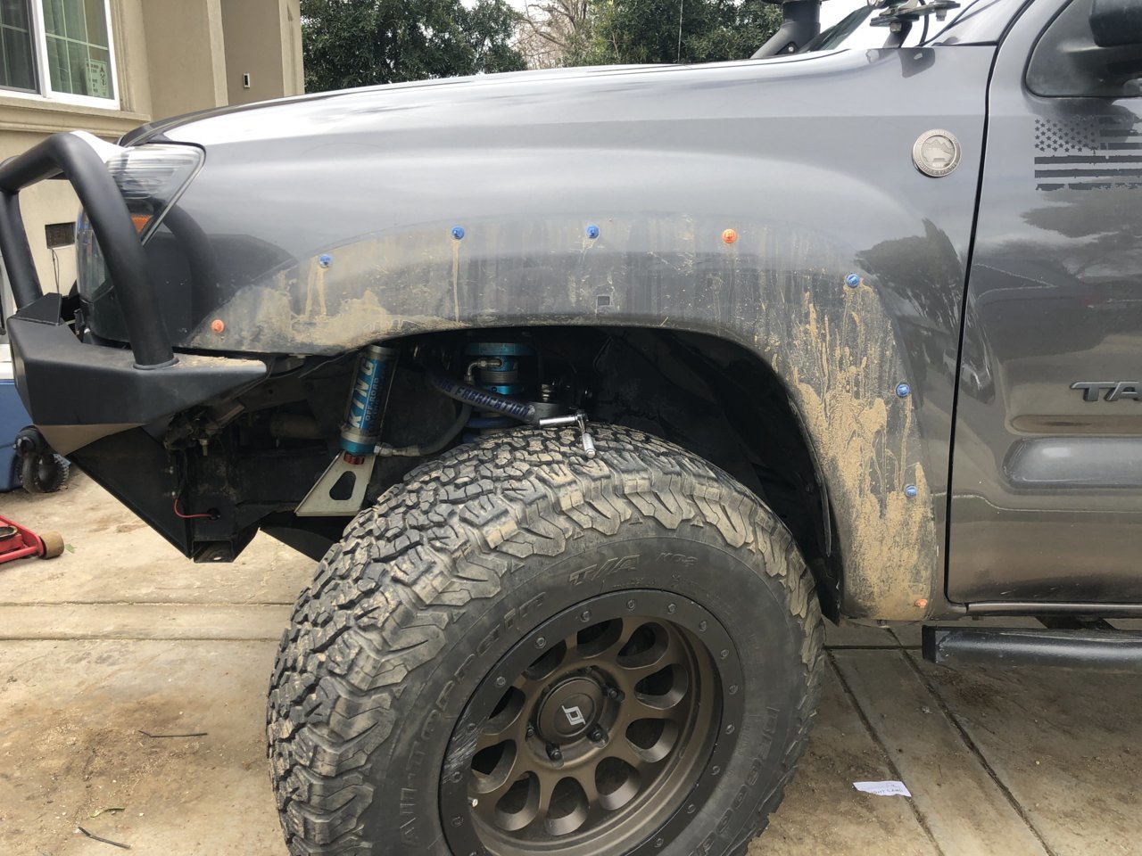

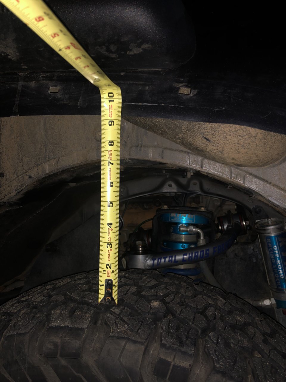

    This photo told me on a recent trip wheeling that the fenders needed to go. With 285/70/17's tires the fenders are maxed out here. Imagine if I had 35's or yet even 34's on the rig.
