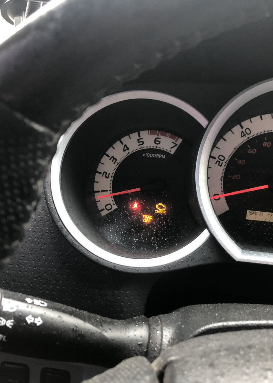

    Whelp. 'Check Engine' and 'Trac Off' lights popped on this morning. No symptoms while driving.
    Plan on checking the gas cap and disconnecting the battery for a few minutes after work. Will head to Autozone to check codes if it's still there. Only thing done recently was an oil change on Sat.
    Any 3rd gen'rs been through this already? Possibly a loose connection? I'm past my initial warranty.

    Have the codes scanned before you disconnect the battery. If it's an EVAP code, probably the gas cap. Looks like you got gas recently.

    Lol. It’s a google image. But, I did get gas this weekend. Thanks for the heads up on the battery. I’ll try the gas cap and then head over to get the codes checked.
    You know if yours happened to fall within the CA emissions warranty (seven years / 70K)?
    dilbert[QUOTED] likes this.

    I was going to ask where you were that was 71 degrees. It isn't even that warm in my office!

    Lol. Was wondering who would notice that first. : D

    My suspicion is either gas cap, or maybe a sensor or wire was knocked loose during the oil change.

    Came out after work: Gas cap was loose, and that’s the code that popped up. Cap tightened up properly. Should go away in 24hrs? If not, I’ll need to get it reset?

    If that was it, it'll go away in a few drive cycles.
