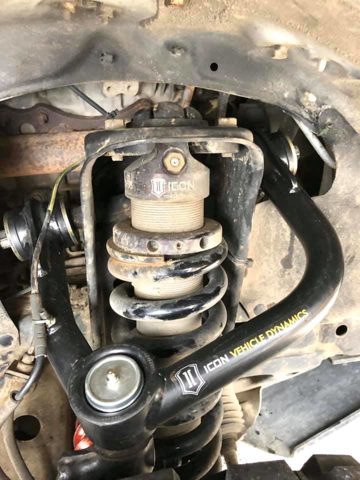

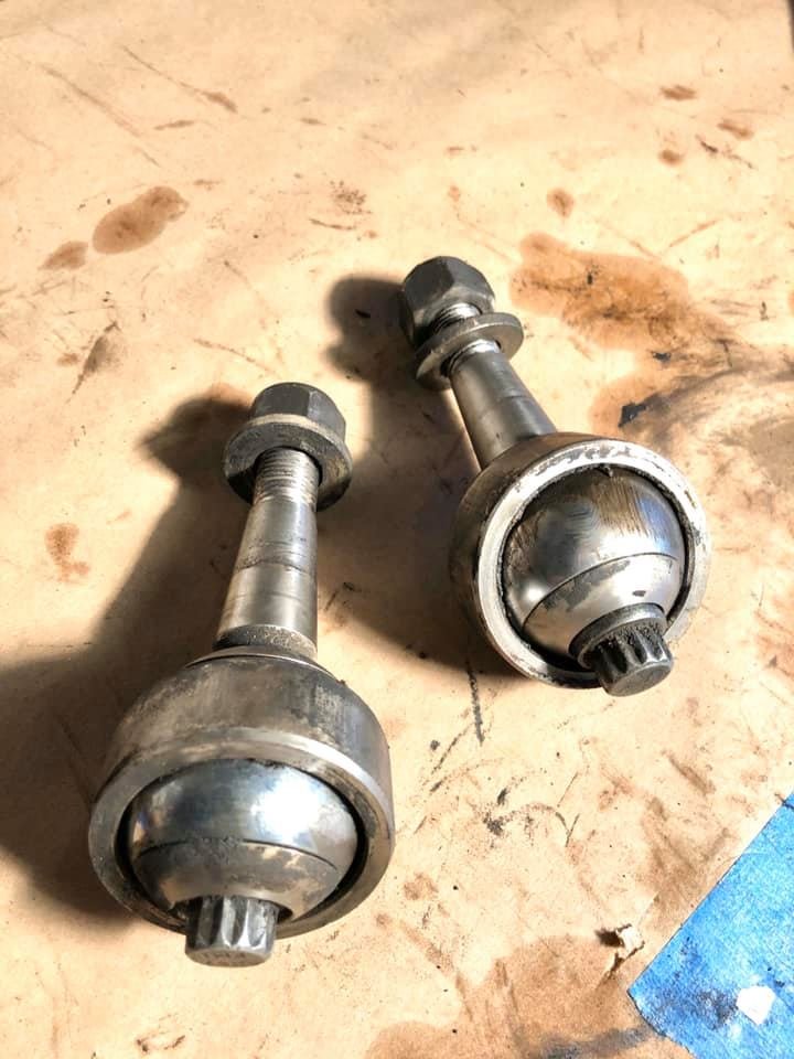

    I just replaced my Icon Uniballs, with the new delta joints. You need a 20 ton press for sure, I had to run to Jim house to press them out. We actually didnt need a press to put the new ones in just a hammer, vice and the special install too. Good Luck! :thumbsup:
