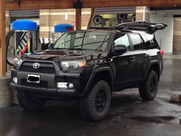

    NW4RUNNER, what lift is that? My parents picked up a trail tonight and the dealer said there was no lift available due to the electronic suspension. Did you have any issues installing it? Thanks hogdoc
    BTW, looks BAD ASS!
  3. Dec 18, 2013 at 9:16 PM
    #23
    NW4RUNNER
    NW4RUNNER [OP] Well-Known Member
    Oct 23, 2012
    #89657
    1,450
    4 runner trail
    I had no problem with any electronics. The dealer was wrong obviously. It amazes me how they can let people so ignorant try and sell things they know very little about. Our lift is the Old Man Emu 3" full lift kit. Comes with front coilovers that you swap out and rear spings and shocks. I bought the lift for about 1K from the Toytec website. I installed it in my garage with BensonX. The rear end was harder than the front. It took about a full days work. Love it so far. The kits have special components for KDSS. Just look into what is needed if yours has KDSS and other features. Surprisingly I was able to run 33" BFG KM2s on the stock suspension for a year before getting the lift with slight rub. Thanks for noticing the truck. I love this thing to death.

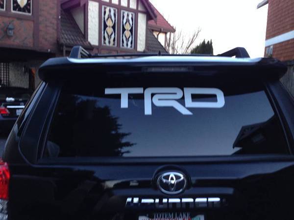

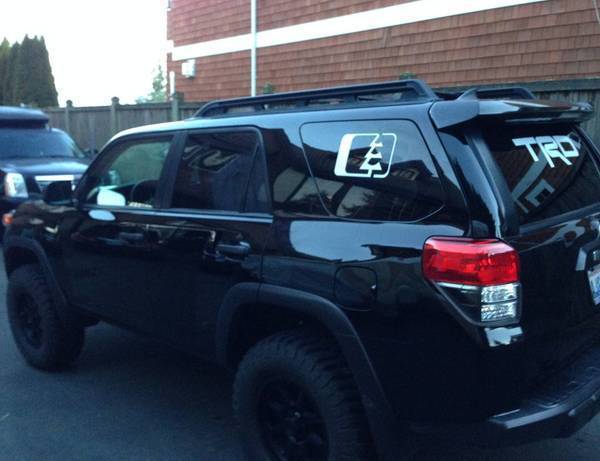

    Thanks RuggedT for the TRD decal. Pretty happy with how it turned out.

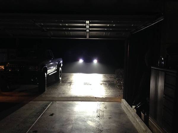

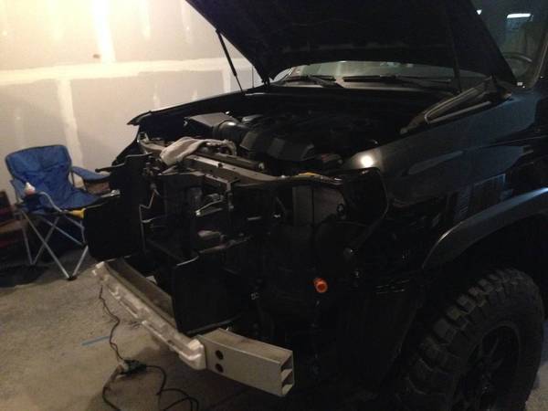

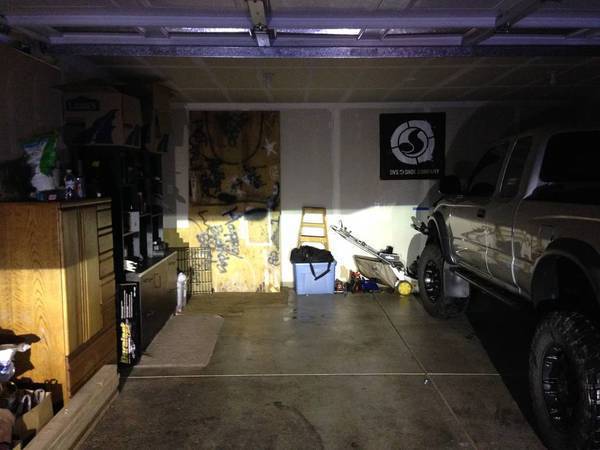

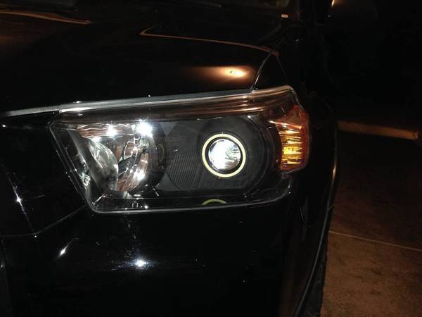

    So I spent the past 2 days instlling my HIDs. TRS says 3 hours of install time. All I can say is absolute BS. I would love to see what these things look like after a 3 hour install. I spent a total of $500 on all the lights, equipment, extra tools, etc and it took about 19 hours of solid work. Here is some outline.
    Step one: Bumper off. This hella sucked.
    Next, Baked lights, took them completely apart, Sanded bowl of lights, cleaned and painted bowls black, assembled Angel eye Halos, assembled shrouds, hooked up wire harness, Relay, Mounted both ballasts under hood, Tested lights, Sealed shrouds, Baked lights again, reassembled lights, Installed lights, Installed bumper, Adjusted aiming of lights. Some results:
    The project sucked. Super stressful and I don't know how long until there is a problem with them. As far as performance, they work amazing and look great.
