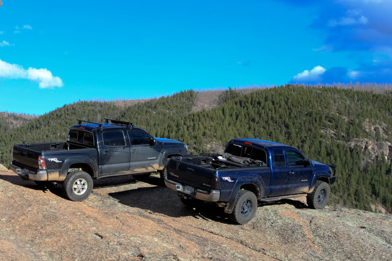

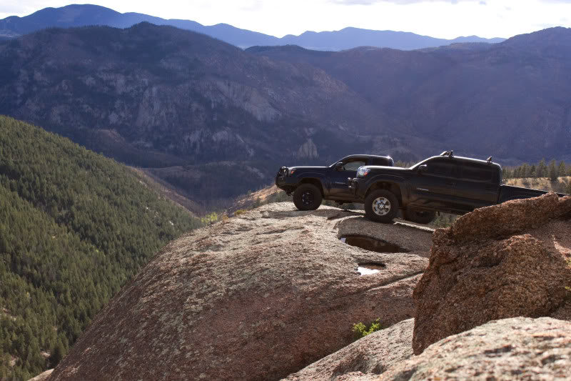

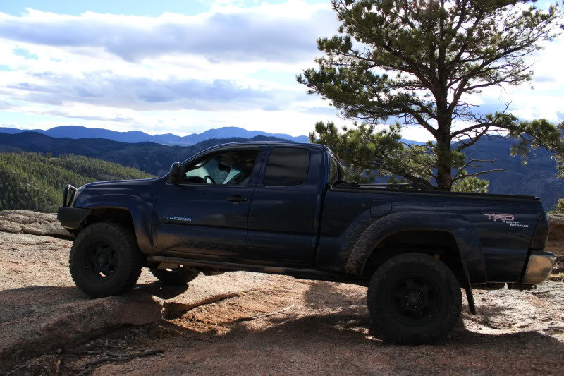

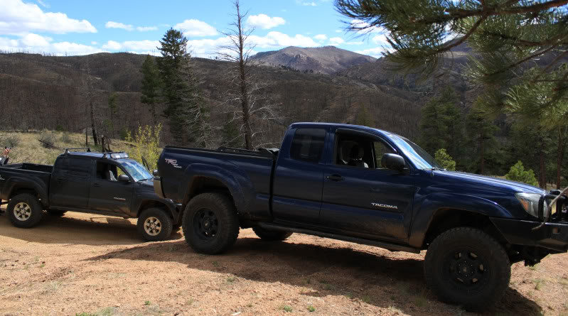

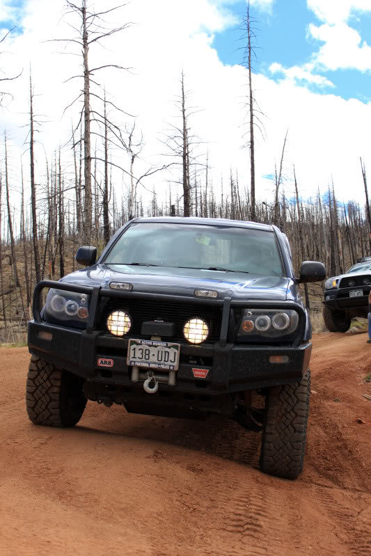

    some highlights from the gulches run
    checking out the new flex without the swaybar (better pics to come when eric gets his shit uploaded)

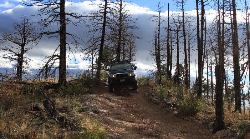

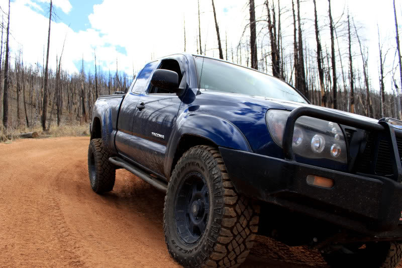

    other pics i took of the truck (eric has all my action shots on his camera)

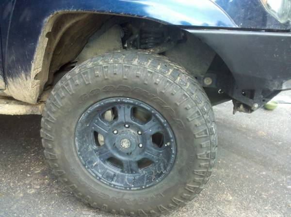

    ARB Bumper cut project
    The goal:
    to cut my damn ARB bumper back so i am not shredding my damn tires on every large compression
    The plan:
    using a cutting wheel, cut along the white line to create ample space for my tire to travel
    with the help of my buddy jace, we marked in from the bottom as far as the bumper structure would allow us (if you have an ARB look behind the bumper on the bottom and you will see additional structuring at a certain point that would be hard to cut through and keep the integrity of the bumper).
    Then using a small metal ruler, i place the ruler within the fender flare near the bumper to mimic the curve of the fender to make a smooth transition (important to have a ruler that can bend and use your best judgment to continue the arc down to the bumper). this established the upper cutting point.
    then to connect the dots, i took a metal coat hanger and (while still in one piece) used the long straight bottom part of the hanger to make a curve mimicking the curve of the tire. This served as a template for the desired arc.
    use a paint pen and there ya go, a line to follow when trimming your bumper....
    after pics to follow, cutting expected to go down this afternoon after work
  15. May 26, 2011 at 4:04 PM
    #35
    NYCO
    NYCO [OP] go explore...
    Jul 27, 2010
    #40842
    19,121
    bOb
    Colorado
    Blue Betty - '06 TRD OR
    dents & scratches

    ^ I really like the bumper mod. It looks really good!

    Thanks! Very satisfied with how it turned out...just got some filing to do and hit it with some paint

    dents & scratches
    Filed down and painted

    looka good Bob, hopefully you wont trash your tires anymore....PS i HATE PhotoBucket.....wont accept raw files. looks like its gonna be next week before i get something going.
