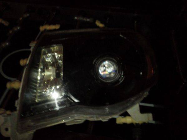

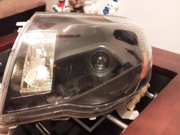

    HID Retro-fit complete..just need to align..
    Bi-Xenon Morimoto Stage II D2S kit
    Apollo shroud
    35w 5000k D2S
    BHLM including bowl
    after re-sealing...inside with lights off
    lights on
    installed..
