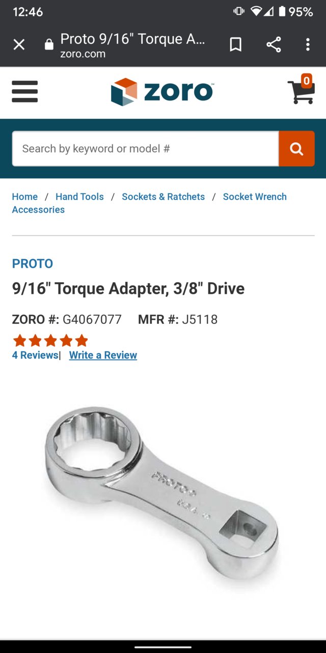

    I haven't touched my air/fuel sensors with over 300k on the odo. I did swap the O2 sensors chasing down a P0420 code.
    I just went out and looked. Oh boy, aren't they in a suck location.
    Something like this with a short extension might work. Just a quick Google search and this was the first image I found... Just an example.
  11. Apr 1, 2020 at 10:06 AM
    recalcitrant
    recalcitrant [OP] Active Member
    Apr 7, 2019
    #289358
    27
    2013 4x4
    YES!! thats the tool i need so i can come at it from reverse. You da man! Thanks.

    a box end/open end would be my first choice

    I didn't think the box wrench would fit over the plug. I tried after my purpose designed socket failed.
    Live and learn...
