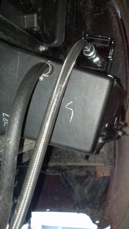

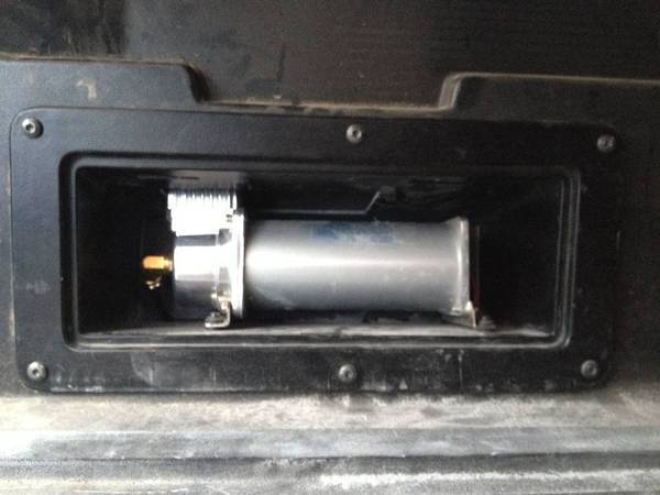

    No go on mounting the Air zenith on the taillight bulkhead. She's too big. The only easy solution that keeps the compressor out of direct exposure is the cubby.
    Going to finish up mounting the tank and compressor tomorrow. Probably won't have time to wire it or plumb the Airline tomorrow.

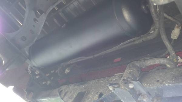

    Took far longer then it should of, impossible to get to half the damn bolts for the stupid compressor because its cramped in the cubby. 5 gallon tank is a nice fit too. Tucked up high enough even for a high clearance rear bumper.

    I went with an aluminum tank, so its super light. Two 1 x 3/8" grade 8 bolts to the bed floor. I had to persuade the spare tire xmember with a 5lb sledge so it wouldn't rub the tank. Also threw some split fuel line over the edge to avoid metal on metal during flex.
    The compressor, I would have mounted vertical behind the tail light but I went with the overkill beast of a compressor and it barely even fits in the cubby. I had to use magnets and spend forever to get the inside bolts on the feet of the compressor in and tightened. Was not fun by any means.

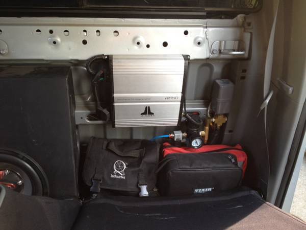

    Thought I'd update my set up
    Viair 450 in bed storage bin
    Glow Shift air pressure gauge in Lo-Tek a-pilar gauge pod
    Air couplers on front and rear bumpers
    Pressure switch (on at 90, off at 120)
    online pressure regulator and ARB locker solenoid
