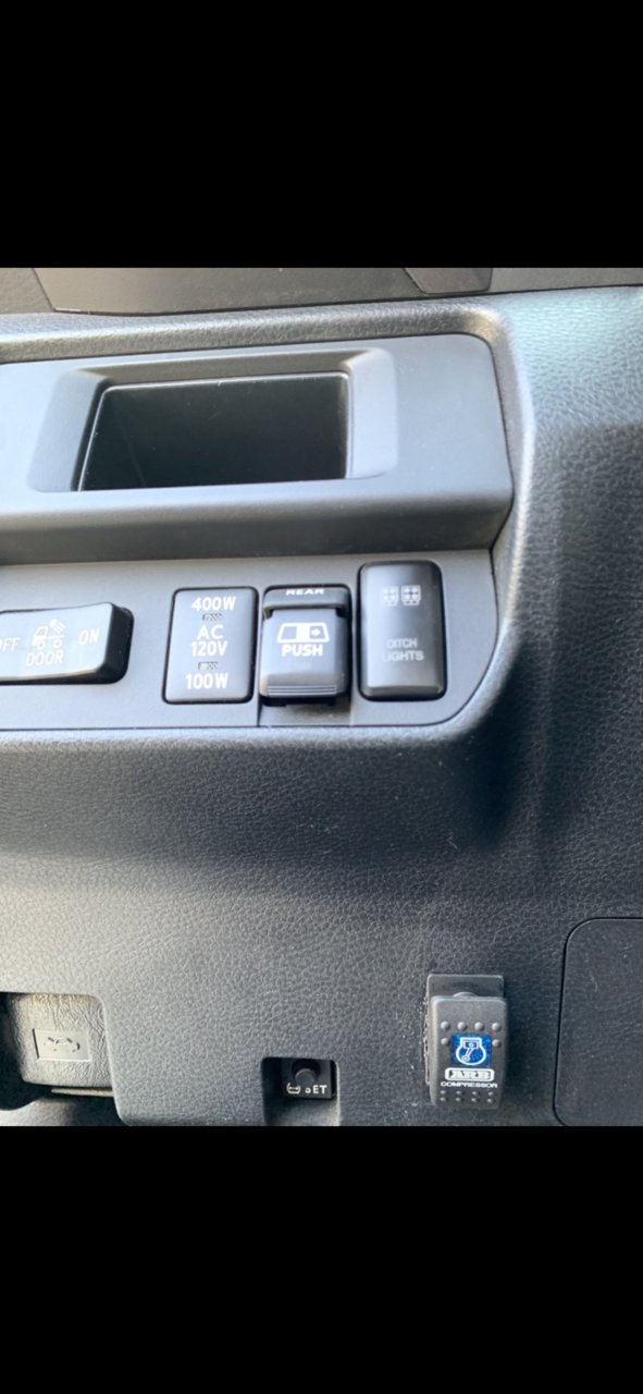

    Has anyone repurposed the locker wiring for other switches? Don't plan on using lockers and would be a lot easier to put my train horn switch right next to the compressor switch

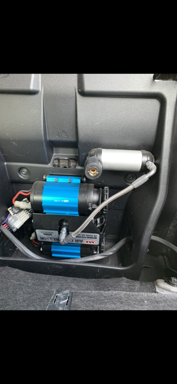

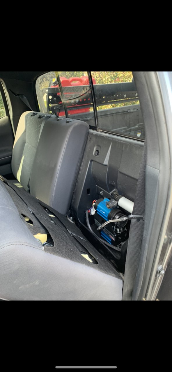

    This is how I set up my compressor. Did it a while back ago actually, but just thought of sharing it
    ThePlumber likes this.
