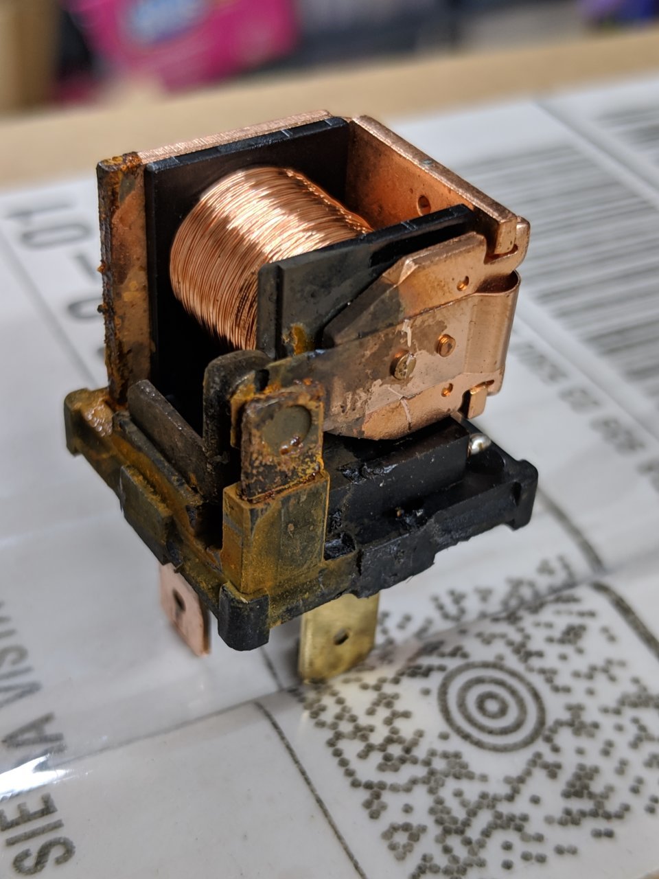

    3,261
    Open it up and make sure the relays aren't corroded.
    They aren't water proof relays and both of mine got water in them and it just stopped working.
    This is what the inside of one of them looked like.
