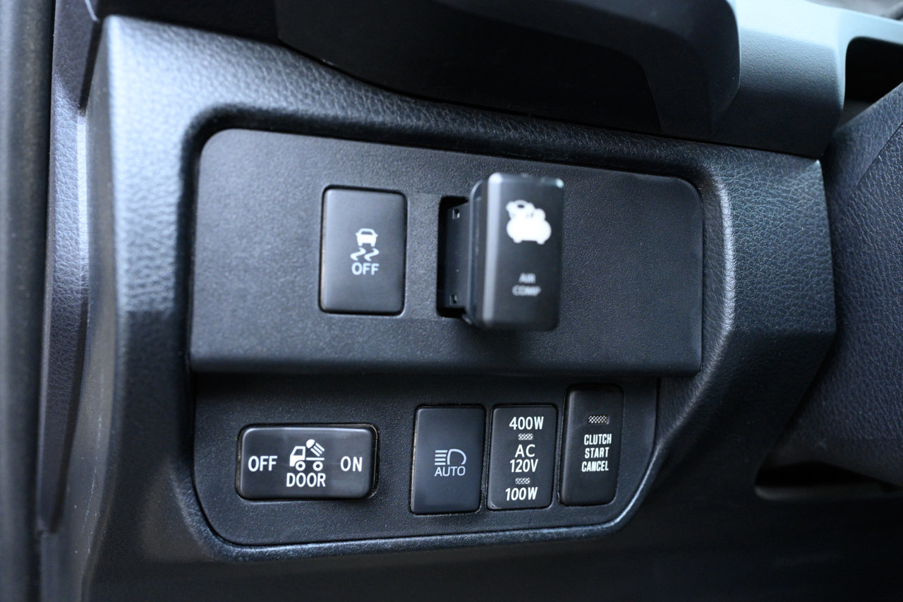

    What companies make panel switches for ARB compressors? I need a left side for a 3rd gen MT, and oops ...LeftPanel.jpg

    ch4x4 makes a bunch of different switches. they'll probably have one that fits. I have a 2nd gen so it's slightly different. I used a dremel to widen the slot so the ARB one would fit b/c I wanted the flip portion of the switch.

    An ARB switch came with the compressor, and it is too large for the stock left side (3rd gen). How are folks mounting the ARB switch? Dremel? I couldn't find any other ARB switches.

    I used a dremel on mine and basically cut out some plastic from the interior from the panel. I just did this on Sunday b/c it had been sticking out like your pic for the last month lol (post #12 in this other thread -- https://www.tacomaworld.com/threads...ash-diff-lock-indicator.718479/#post-25694904). My switch and panel is slightly different but the dremel would work.

    They have other switches. I just installed a heated mirror switch on the left side. It’s the same style as CH4X4 and the knock offs but better quality. You must not have seen this site.
