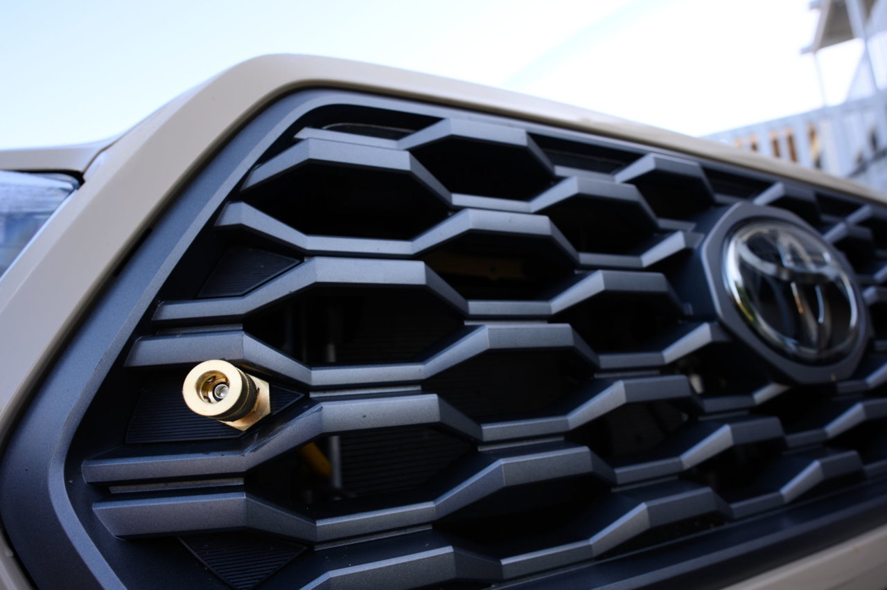

    Haven't come across anyone mounting the chuck in a refreshed 3rd gen grill, so decided to see if it is robust enough. So far so good, but time will tell.

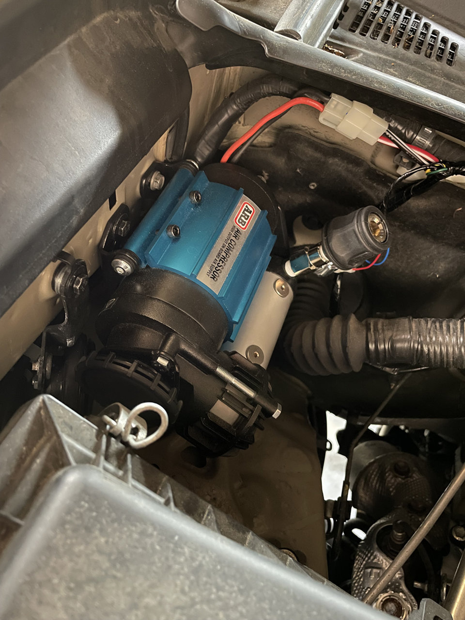

    Got my ARB single mounted this past weekend. Took forever to get delivered. Seems to be on backorder everywhere I looked. Current set up is using the bracket it came with mounted to existing mount holes under the hood of my 3rd gen. We'll see how this goes but thinking i'll eventually move it to a bed cubby down the road.

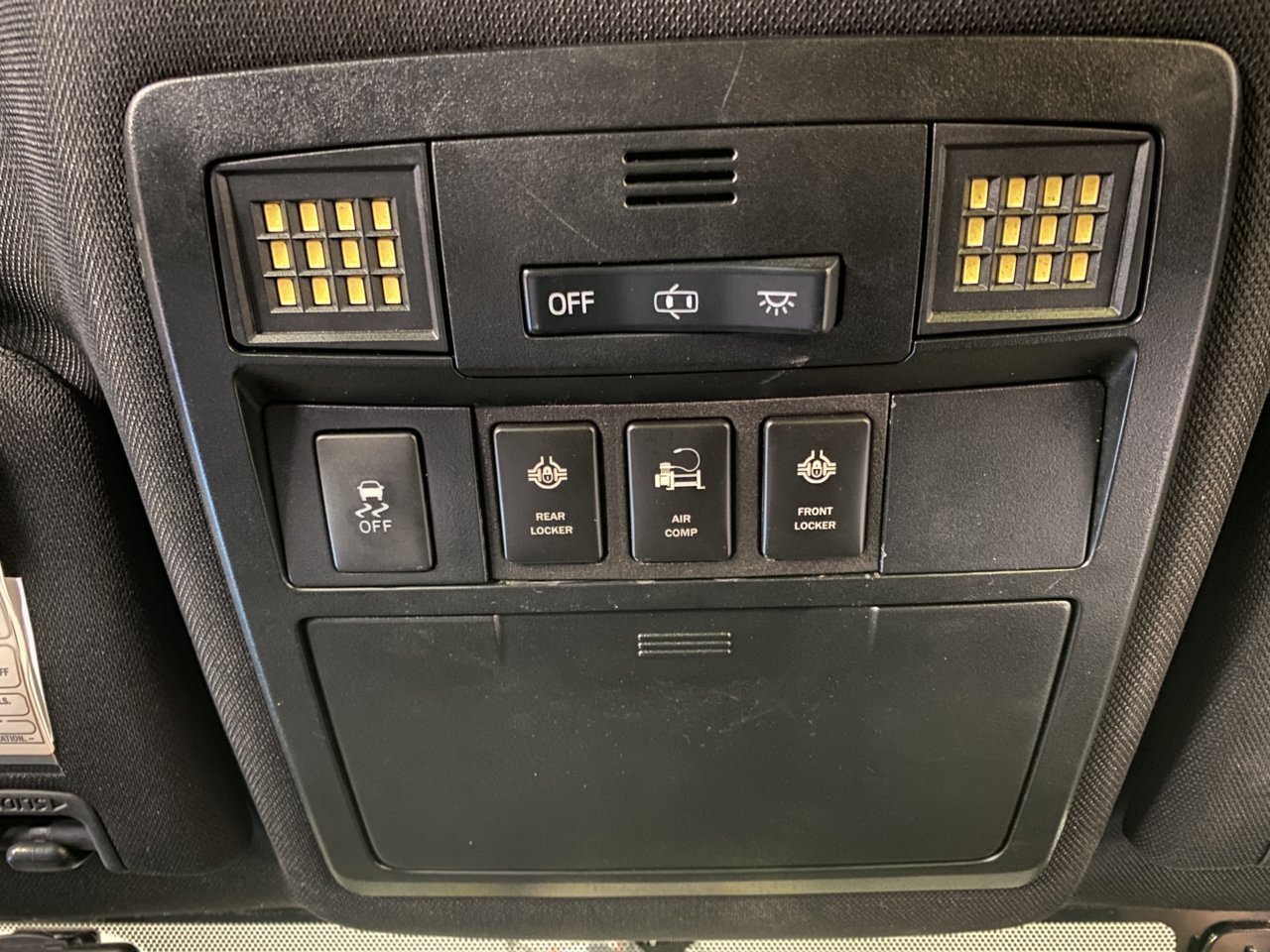

    I've never seen this done on here so I figured I'd post the pic. If anyone is interested in how I got it to work.

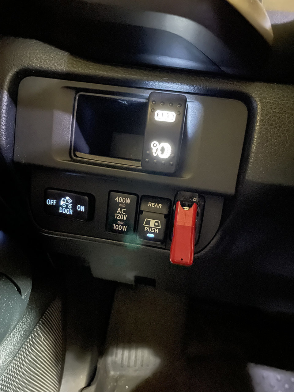

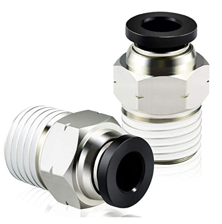

    I use Push-to-Connect fittings.

    I did too. I find that compression fittings are much more reliable and disassemble without scratching/scuffing the tubing but that said it’s the tapered thread fittings that seem more prone to leaking. In some cases I’ve found FIP threads seriously messed up or not cut deep enough to have sufficient overlap so I picked up a 1/4 npt tap. I have probably more than the usual uses for OBA. I also grabbed a 1/8” and a 3/8” tap. A light touch with a triangular file and get the worst burrs on male threads.
