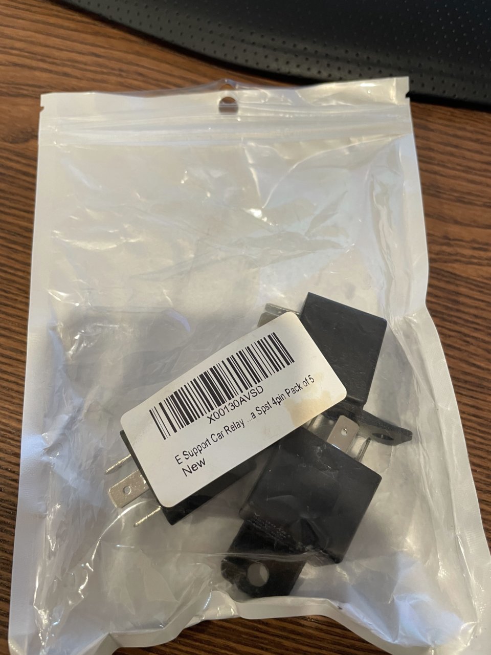

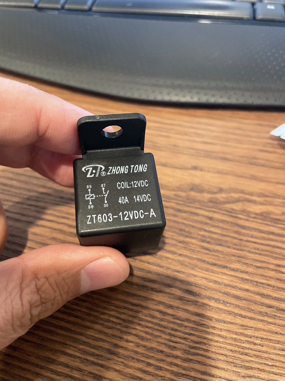

    Nothing special about the relays. Since they aren't sealed/weather proof relays they can fairly easily get water in them and rust causing them to stick open or closed.
    These are leftovers from when I replaced mine.
    Gunshot-6A[OP] likes this.
