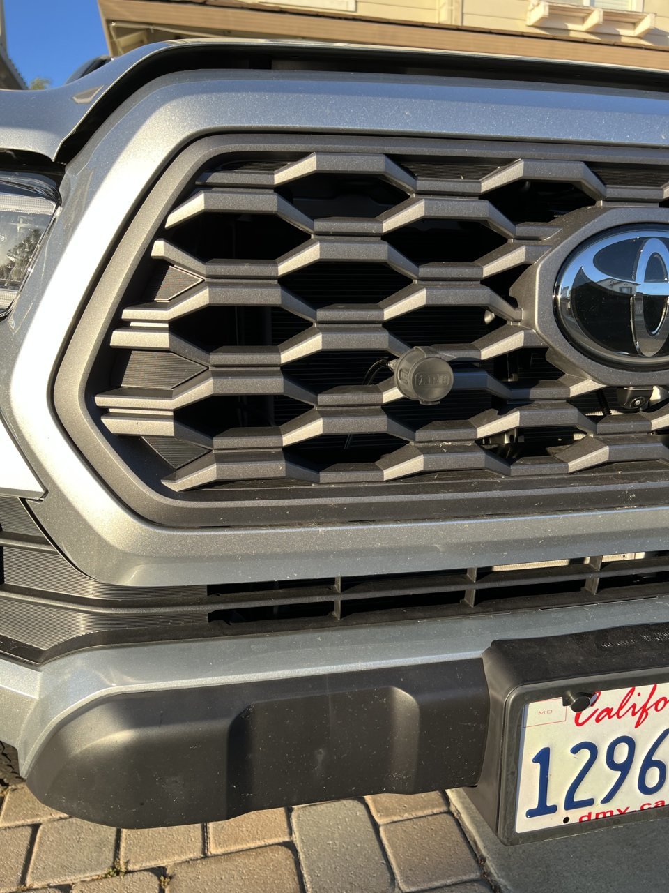

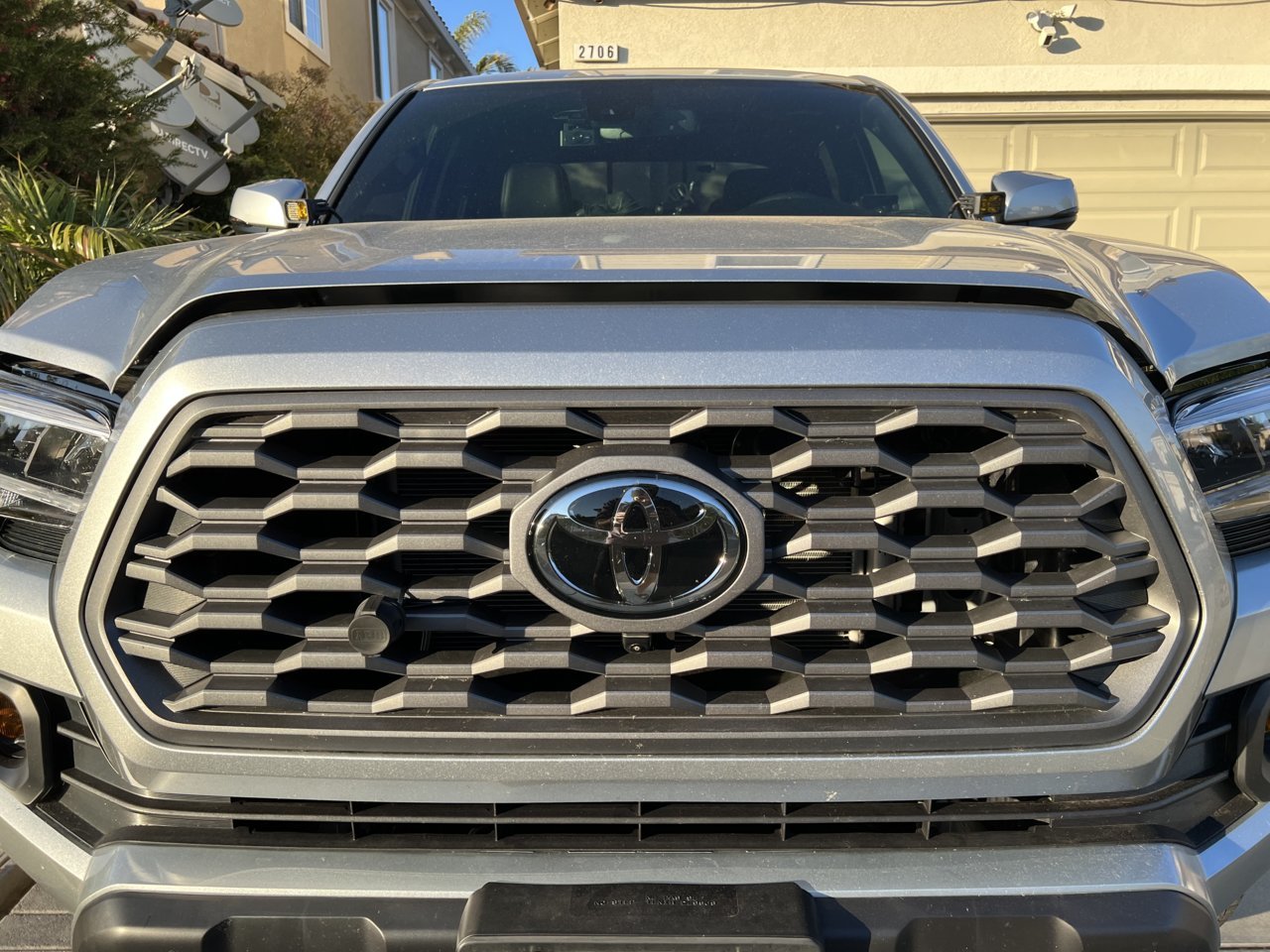

    I mounted mine, temporarily, by zip-tying it to the grille. I’m awaiting my BAMF hybrid bumper and once I get that installed, I’m going to drill a hole and mount it slightly offset to the right from the center within the high hoop.
    For now the grille location works great to run my MORRFlate kit but in order to mount it to the bumper, you’ll need to purchase the ARB coupler mounting kit which includes the metal bracket, which I won’t use, but also the large metal bolt to hold the coupler to the location.

    Yeah I wanted to stick with the grille position and planned to do a more permanent solution using the 3-way bracket. However, after using my MORRFlate, the manifold is so heavy that it puts a lot of pressure on the coupler and I could see it causing future failure. Hence, I plan on attaching the coupler to the rigid metal of the bumper.

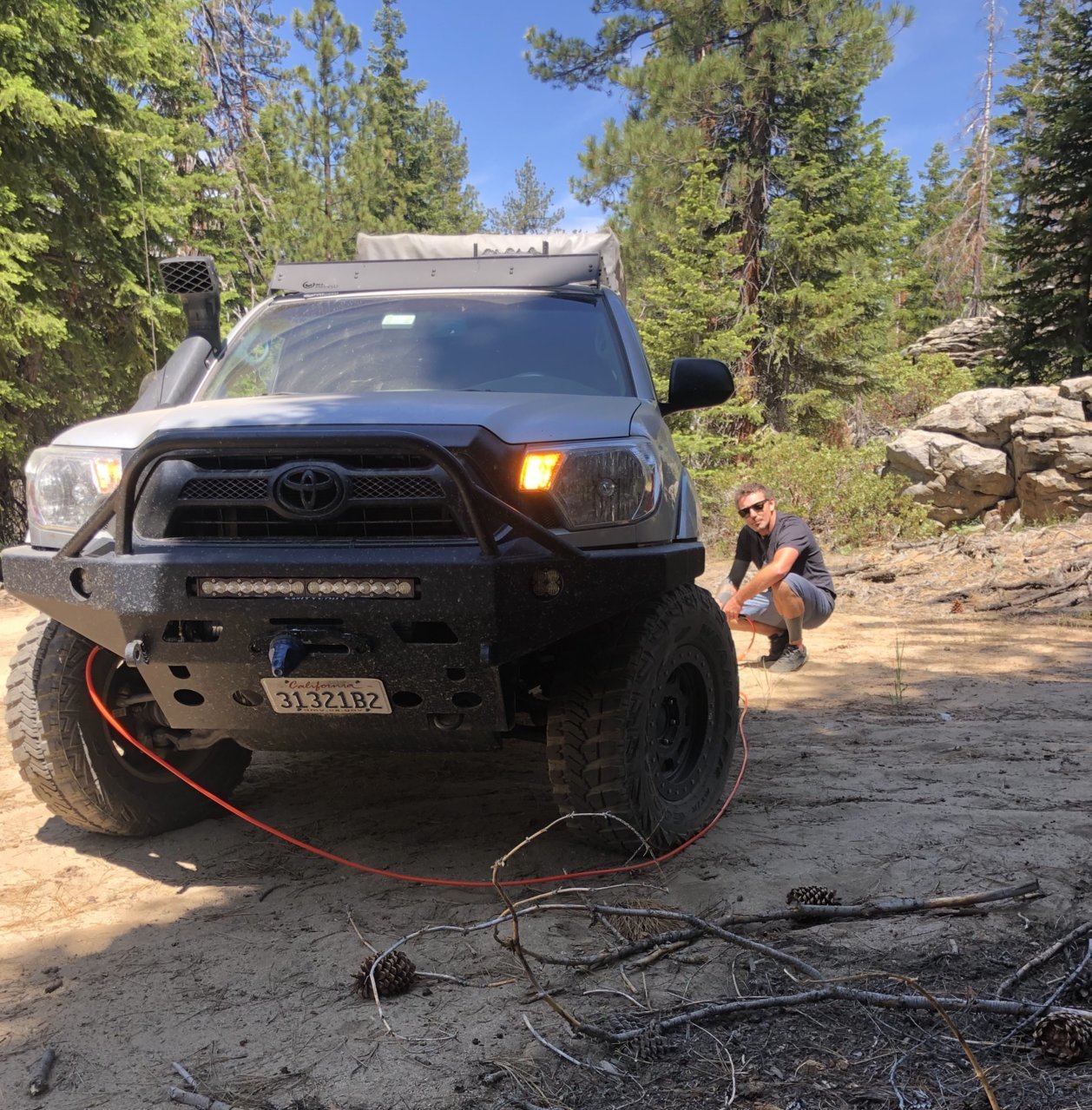

    I have mine coming out the side of the bumper, so it internal enough to be a bit less exposed , but I def need the cover to keep dirt / dust out
