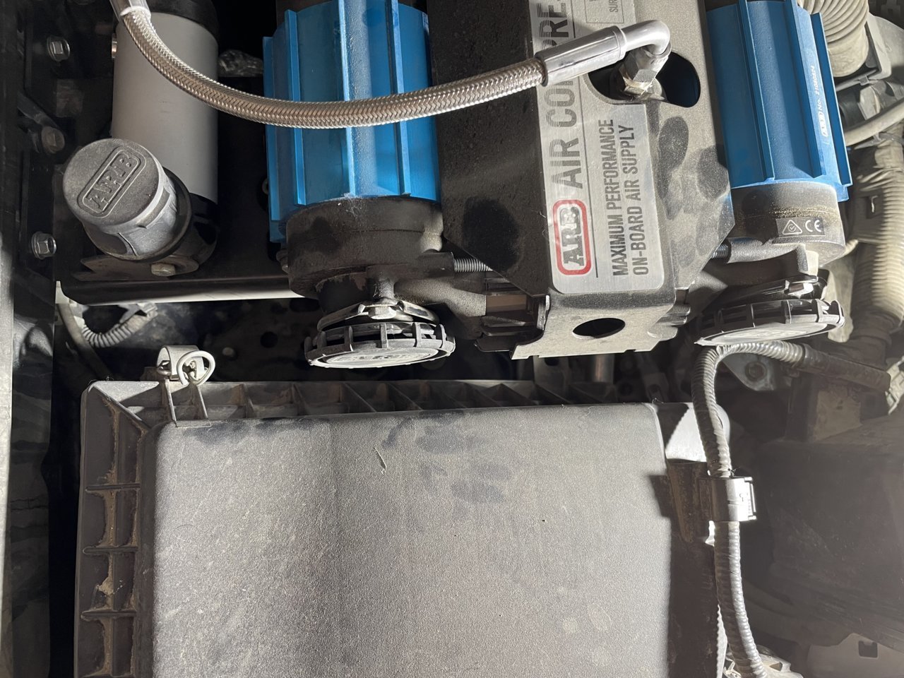

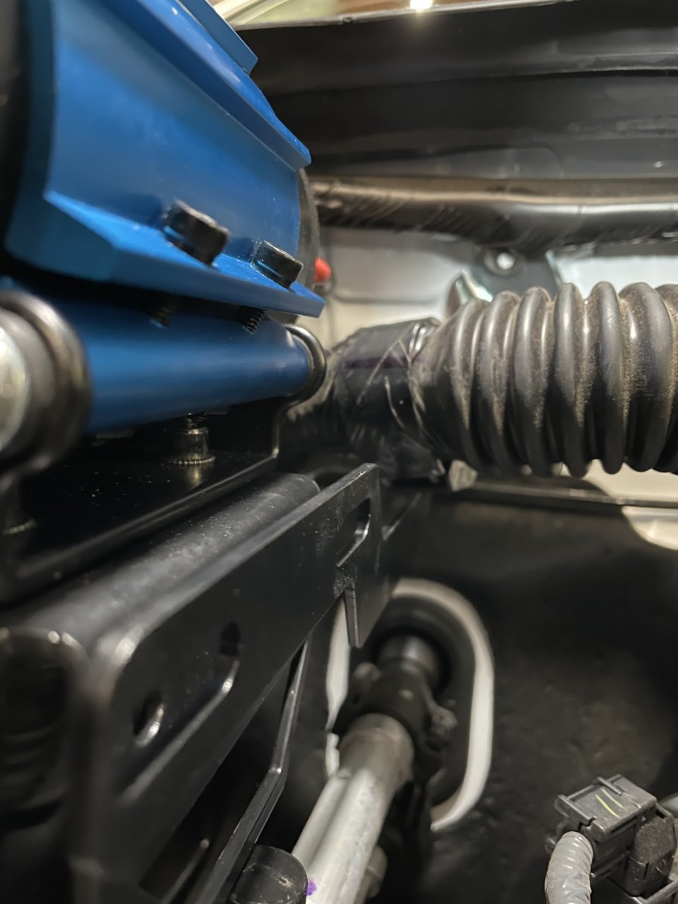

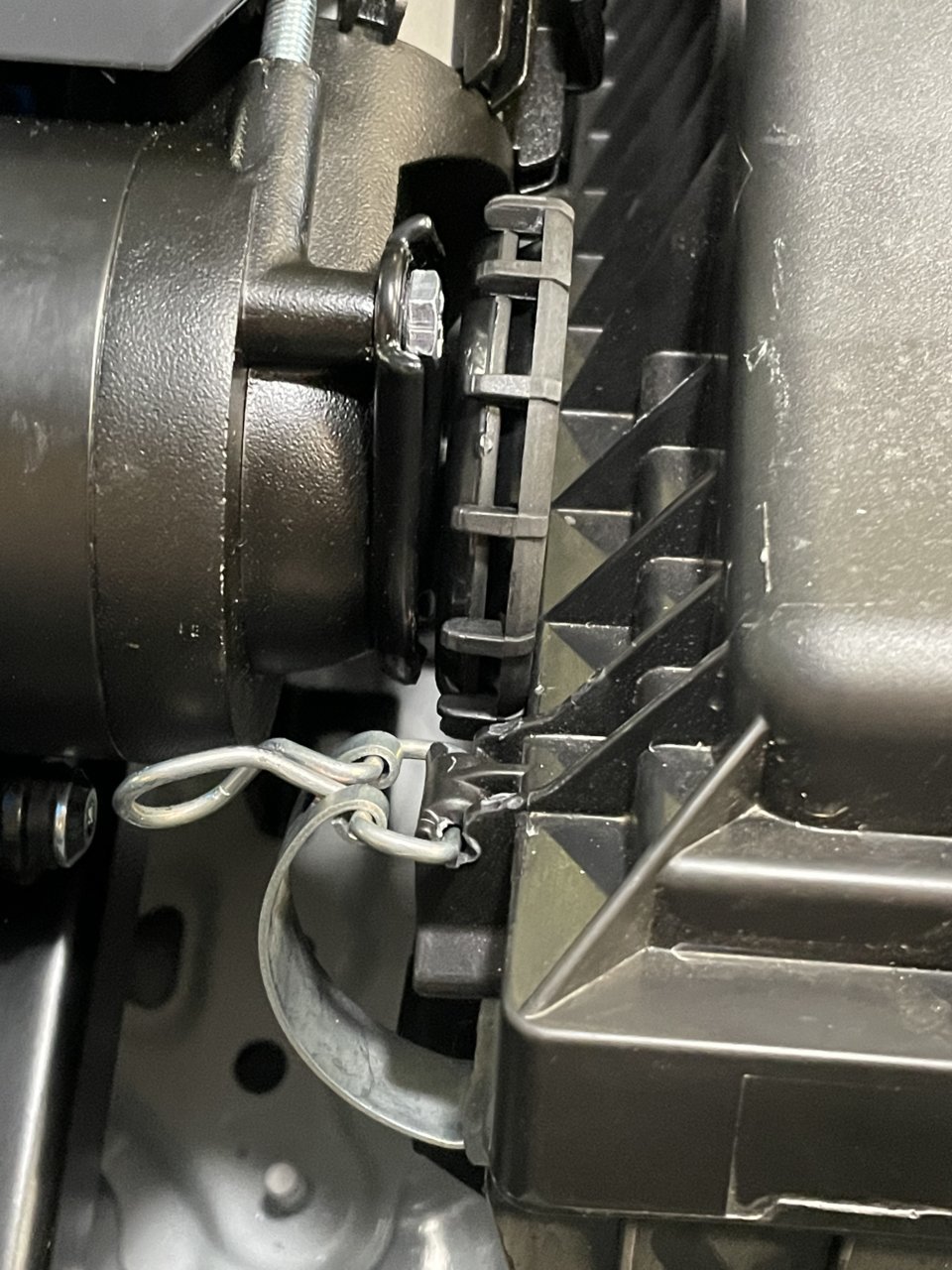

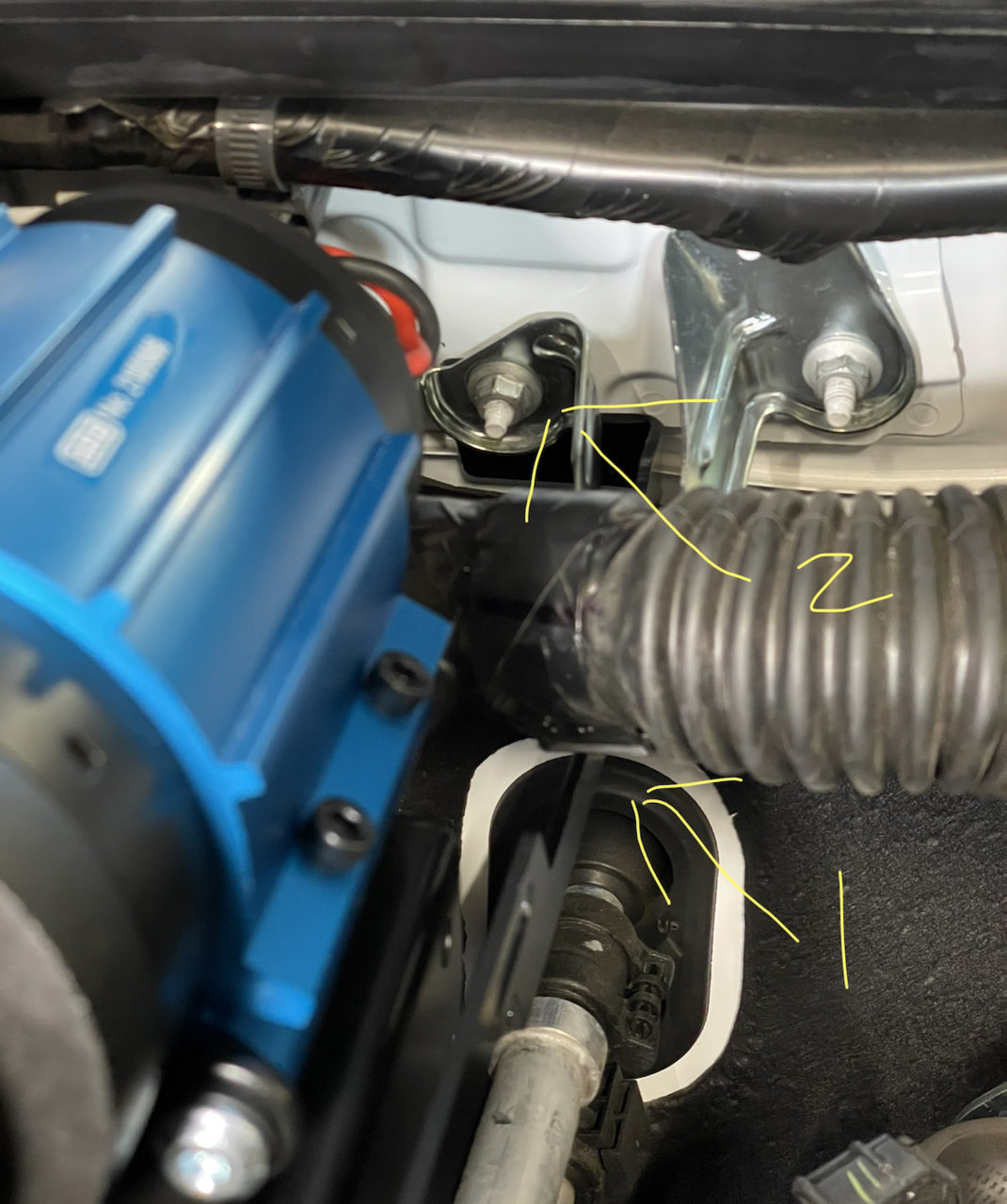

    Can anyone recommend an arb twin compressor mounting solution for a 22? Engine bay passenger side preferred, if any. I’ve tried Rogue’s GTFO and the firewall support bracket doesn’t clear the tubing. 31DB418D-B555-482A-84FE-391F3211CA58.jpg And when you bend it enough, it pushes the entire platform towards the intake which prevents mounting the compressor filters.C183577C-F640-484A-8C00-1343BA0CB86D.jpg It looks like SLEE doesn’t work as well. TIA.

    Yeah, get the M.O.R.E. bracket. It fits fine and the most you may need to do is bend the A/C line slightly towards the engine. I’m talking literally less than 1/2 inch, if that. The tube is aluminum with a rubber hose and it’ll stay at whatever angle you bend it. The bracket is top notch and the ability to mount a tank is hard to beat!

    No difference. There is a slight manufacturing tolerance in the A/C line over on the right side of the engine and on some vehicles it contacts the side of the M.O.R.E. bracket slightly. I’m sure it’s not exclusive to the 2022 trucks and some people are risk averse to slightly pushing it out of the way. IMO if that is something you aren’t comfortable doing, you probably shouldn’t mod your truck at all. Just my 2 cents.

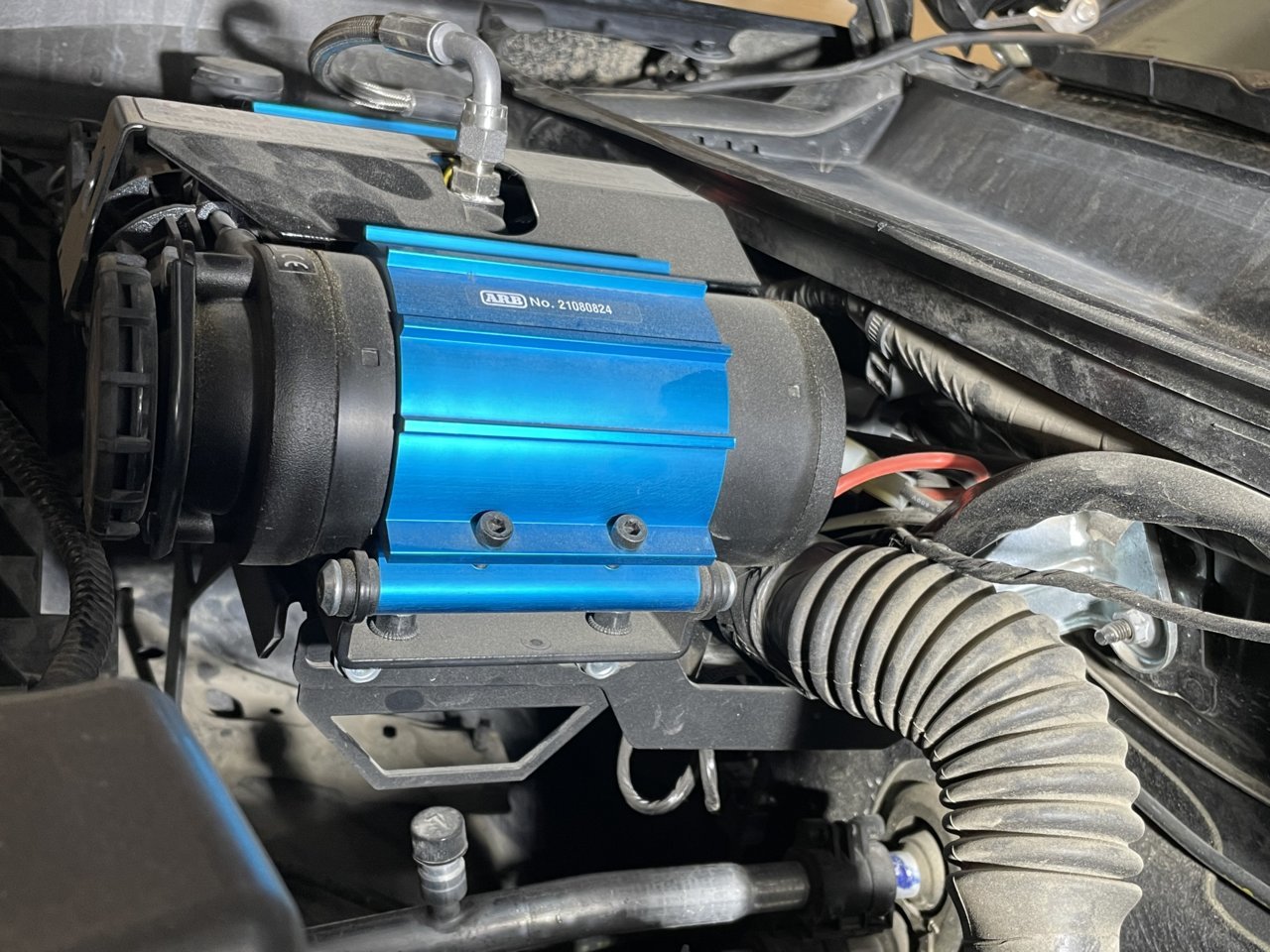

    Late to the party but with the GTFO mount you have to shift the compressor farther to the driver side on the mount, it will overhang a little bit but still secures using the same 4 bolts but using different locations on the mount but it definitely fits no issues. You will likely have to remove the mount/compressor entirely, slide the compressor towards driver side a little more then reinstall.

    Awesome. I kind of put it on hold until I saw this or before I started buying more mounts . I did this and it fits! I still had to bend the firewall support bracket. Thank you!

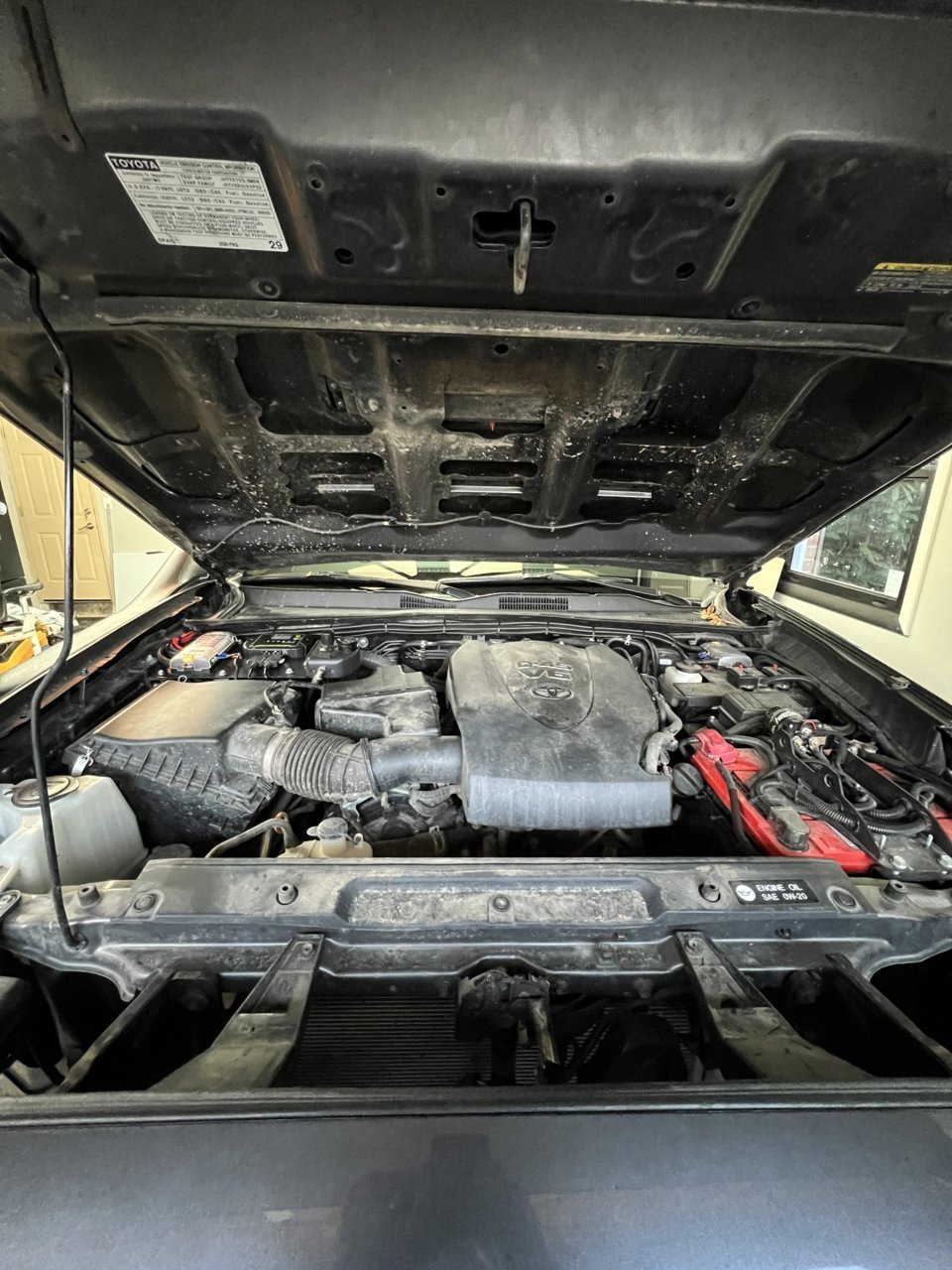

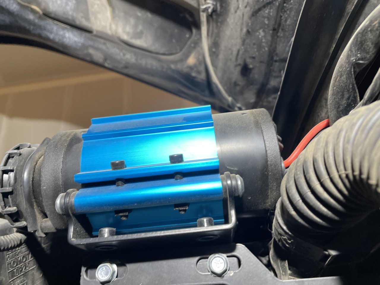

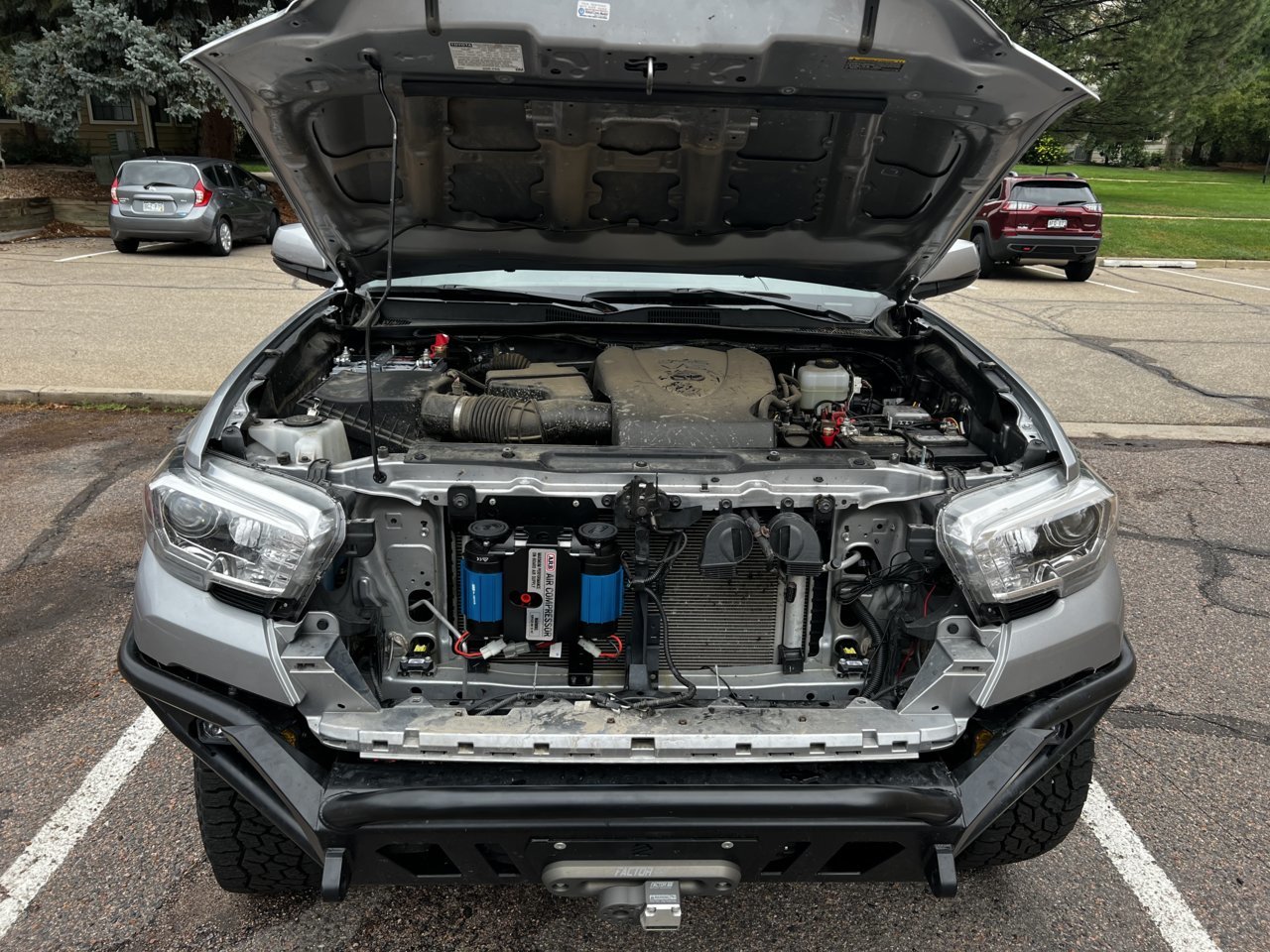

    After weighing the benefits and hindrances of each set up I narrowed it down to three options. I didn’t want to put it in my cab, and I have a dual battery taking up the passenger space.
    1) Expedition Essentials Bedside
    2) Rago Fab over fuse box
    3) Runin4Tacos behind the grill
    I always thought I was going to go with the expedition, but the added cost of the extra wiring, the dirt factor (cut fenders), kept me from going that route. I also don’t think it will be as easy to access as I would like as my spare time is in that general area.
    I was very interested in the Rago option, but ultimately I didn’t want to cover my fuse box.
    I like so much about the R4T setup, but I was hung up on the fact that it was “covering the radiator” like so many others. Ultimately I decided to go for it. I still can’t find a single person that says it has created cooling issues for them. I’m really happy that I did because there’s a lot more airflow behind there than I expected and it checks all the other boxes.

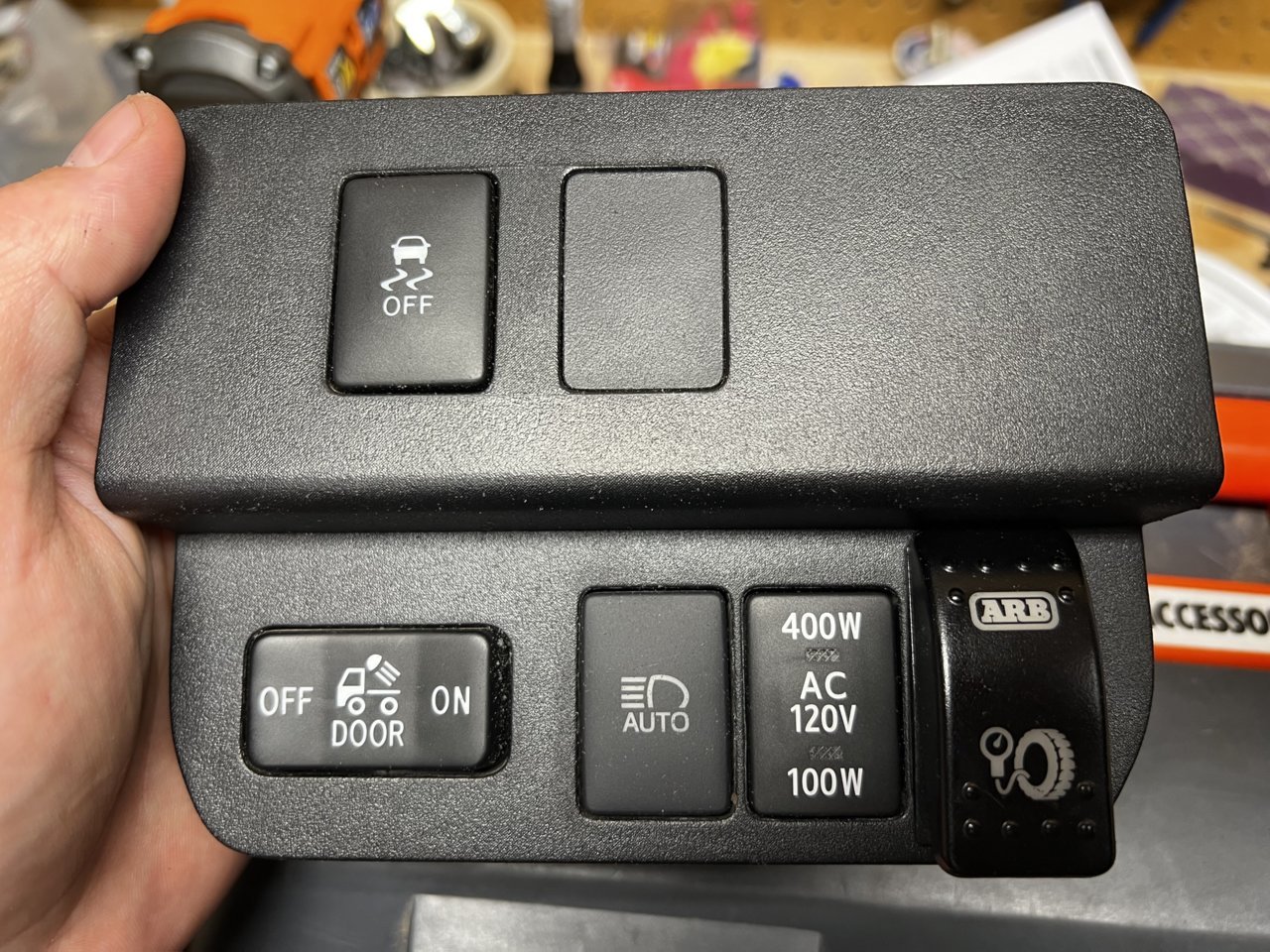

    I also spent some time going to town on the switch panel with the Dremel this evening to make the ARB rocker switch fit and I’m very happy with the results.
    I how to find some add a fuse minis tomorrow to finish the job. I guess I still need to mount the remote quick connect to my bumper as well…

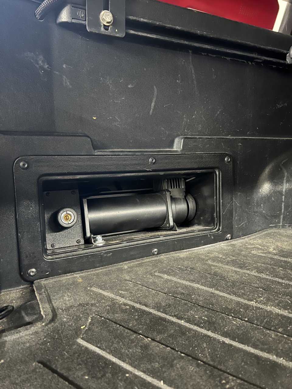

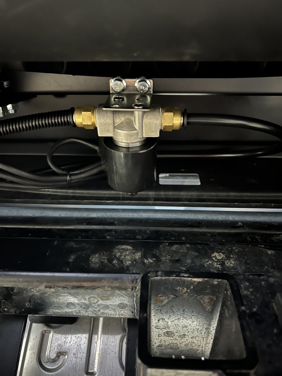

    A27BBB9B-49A5-4348-9914-371954E96943.jpg 23CC5508-5370-4E3E-B623-CCA95C820CED.jpg 71A78E42-2618-4145-8B2E-79CB2F80DC00.jpg CB9F32DB-58A8-4914-A3F1-0AAA0870471F.jpg 02781805-160B-4E54-82C4-C8C1480D3578.jpg 23CC5508-5370-4E3E-B623-CCA95C820CED.jpg Been putting mine together for a while now. Almost done but it’s up and functional.
    Using a Viair compressor with a 3 gallon tank which runs to an ARB outlet in the cubby. I also have a switched valve to run air up to my Up/down air manifold for airing up after a day on the trails.
