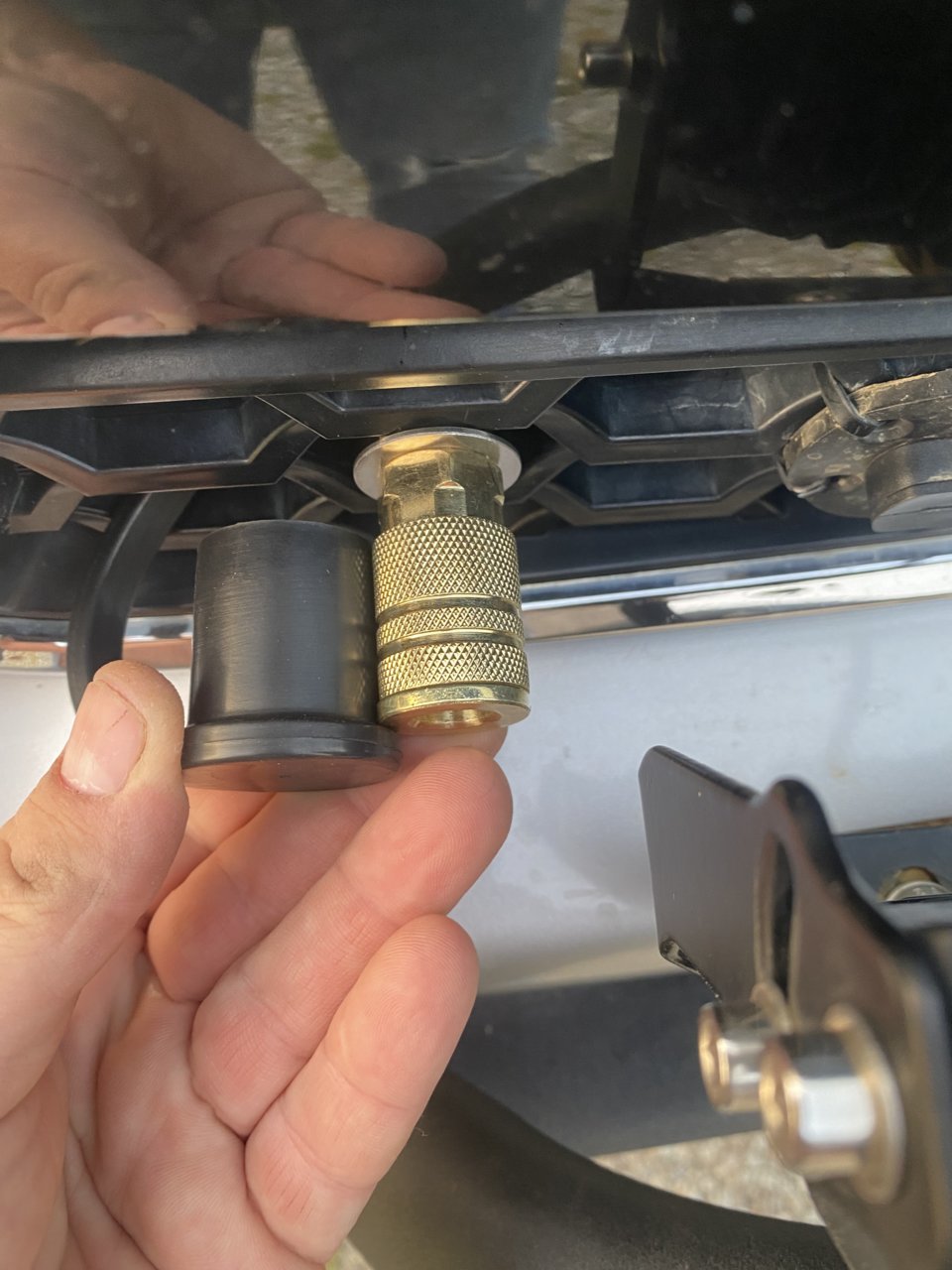

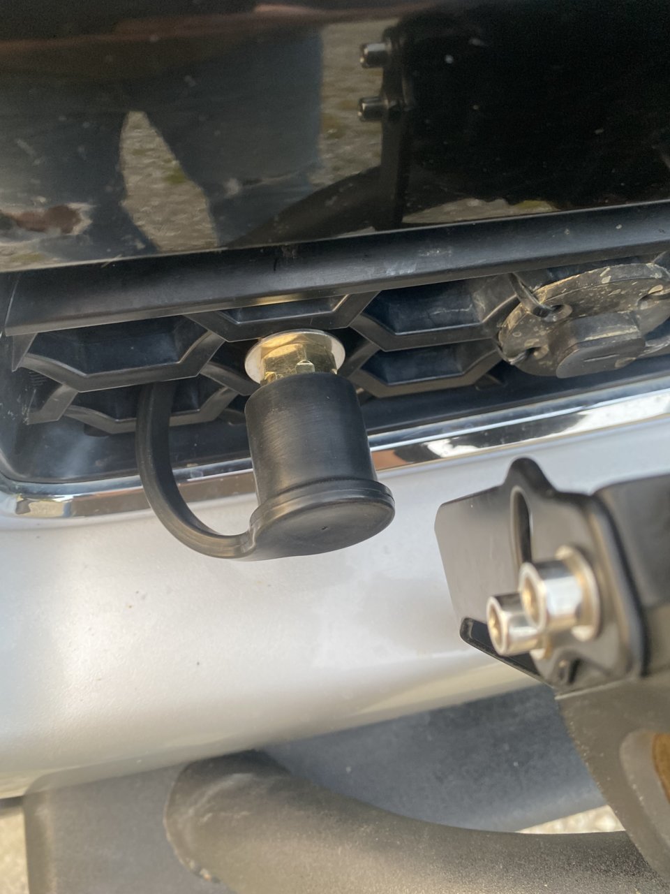

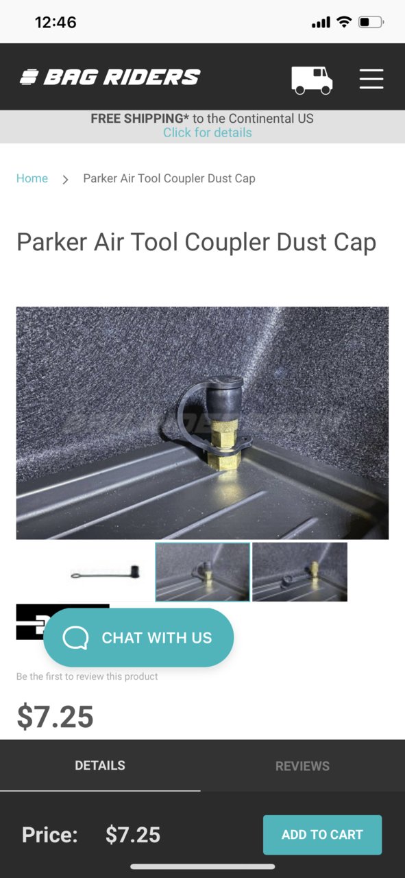

    What’s everyone using as dust/mud caps for the female quick connects?
    I’ve seen chair leg tips and other random stuff being used.
    Looking for something that’ll cover the whole fitting and has a tether on it.
    These Parker caps seem like they’ll almost do the job, but I wish they were about 1/2” long so they’d cover a little more.

    I went down this rabbit hole with my ARB single. I ended up with a piece of 1/8" steel sheet from the scrap bin, drilling some holes for the fender dong bolts and compressor bolts and making it work that way. It was pretty tight with a single, so a double would be tricky.

    Add a chair leg cap with the end cut off

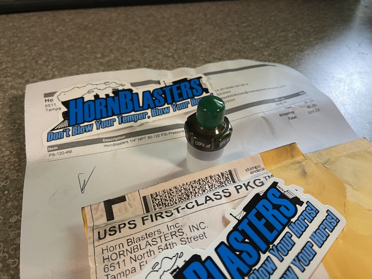

    Pressure switches are interchangeable, and I thought ARB’s 70-100 was a little low, so I found a 90-120psi switch and installed it into my new compressor.
    Should still be plenty for lockers and tires, but also help with the pump’s longevity.

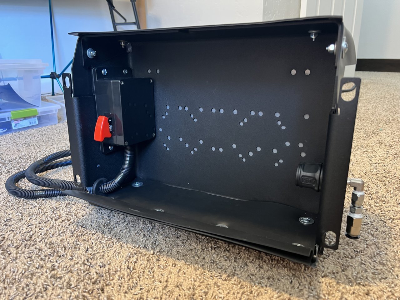

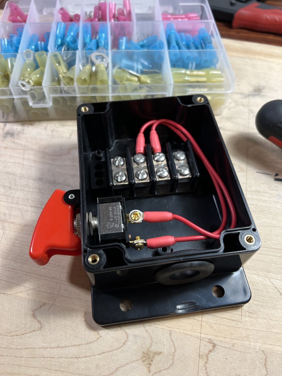

    Here’s my version. I used the All-Pro Off-Road bed box, and modified it to be much more weather-proof. The box is designed to mount the compressor inside, but I chose to mount the compressor up front, and use the box for the switch, air coupler, and storage. The switch housing was built into a generic weatherproof junction box with a distribution block for the switch wiring and an extra 10awg power wire.
    The switch wiring loom and a 3/8” DOT air line run up the frame into the engine compartment. I’m using the ARB single mounted on the SLEE mount. A 4-way fitting accommodates the pressure switch, additional air coupler, and an 18” braided SS leader hose.
    The ARB main wiring loom was simplified and connects directly to my custom AUX fuse panel. You can also turn the compressor on from the engine compartment by jumping the switch circuit with a standard 10amp fuse. The switch in the bed box is tied directly to the battery so you can use the compressor with the engine off (briefly) for airing up bike tires.
