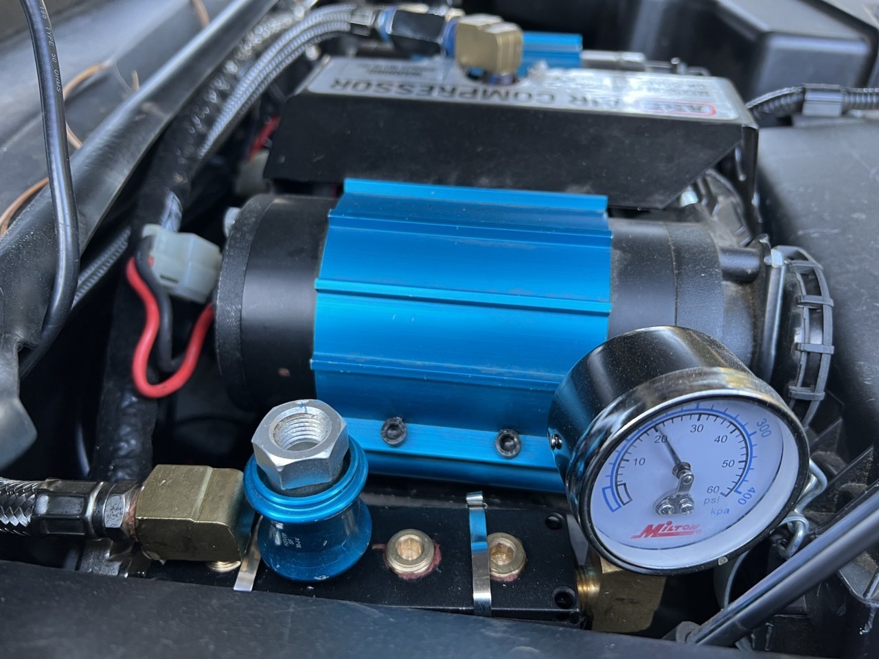

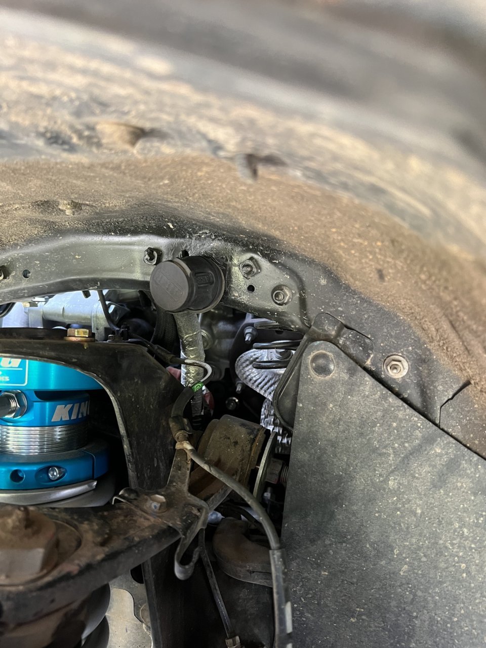

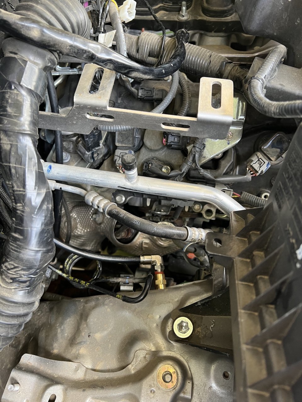

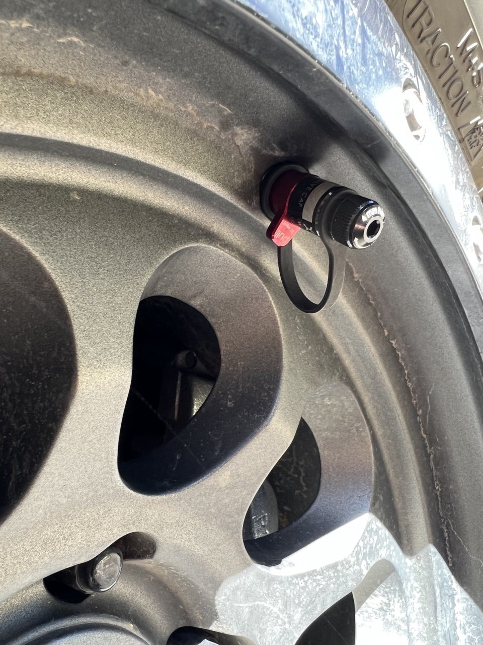

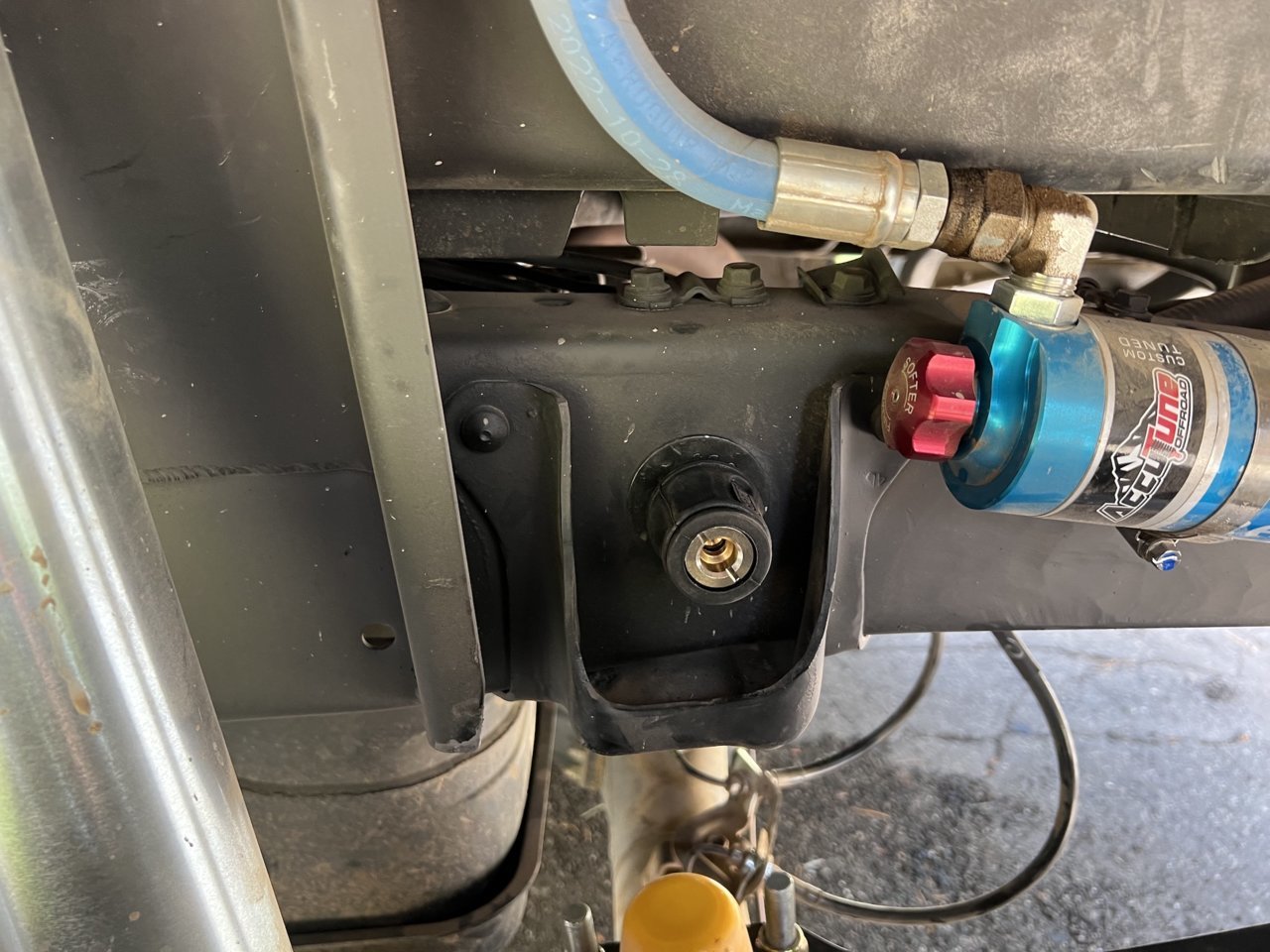

    Finally got around to unfucking and finishing up my OBA setup and I'm pretty pleased. If anyone is considering the Rago Wifey system.. just.. don't. The parts are cheaper to get individually and you'll get better quality ones. The hose they use isn't rated for heat and saved them like $4 on a $300 kit or whatever. I grabbed some DoT rated airline tubing and some DoT rated Viair push connect fittings and wrapped it up with some Design Engineer fire sleeves.
    ARB quick connects to all four wheels. APEX rapid deflate valves in all four wheels. The tail hoses use the Apex rapid inflation valve on one side with a Viair quick connect on the other. Pop'em in, crack a beer.
