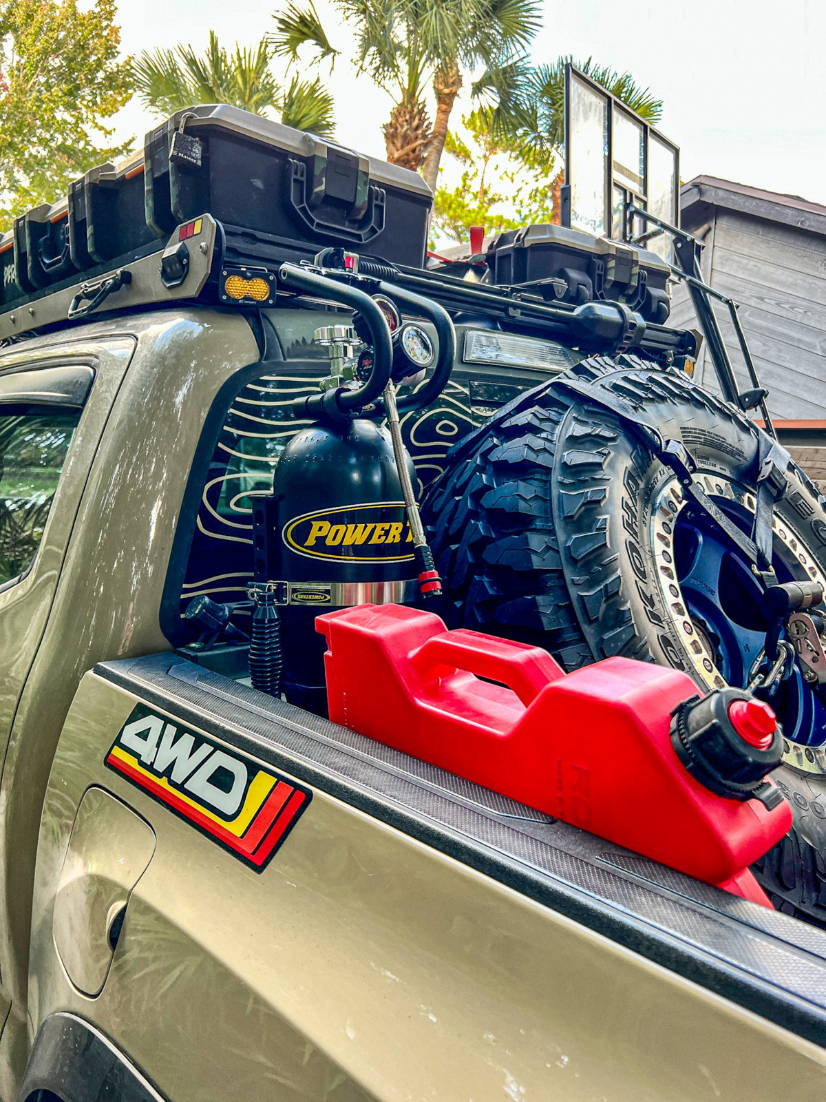

    Recently tested a 4 lbs tank in the bed to see if it would help filling the tires quicker. It did not. Ended up with a power tank for quicker fill ups.
    After this last wheeling trip it was worth the expense and trip to get it filled. It's so much faster.
    Pics for fun.
