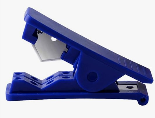

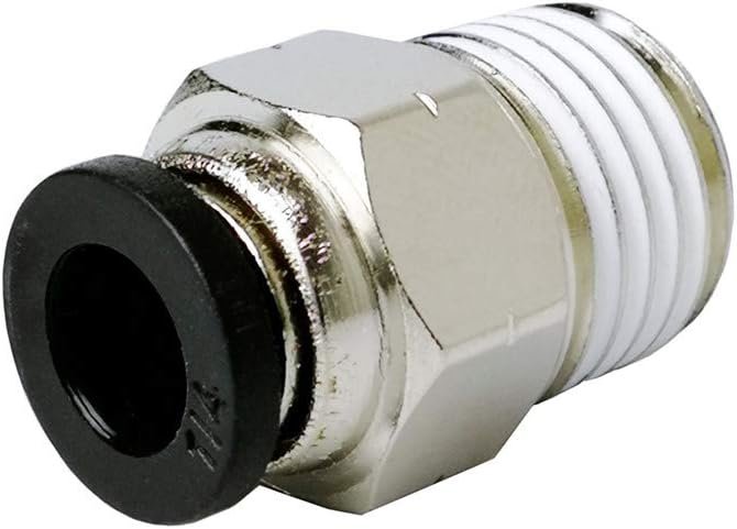

    Why can I not get these things to work? No matter what I do, they leak.
    The threaded part is OK; I can get it to seal with the adjacent fitting.
    It's when I push air tubing that's the problem. No matter how hard push the tubing in, it won't seal and continues to leak.
    It seems simple enough, but could I be doing something wrong?

    I switched to compression fittings. With the plastic air lines you have to use nylon ferrules and brass inserts but they are much more reliable while also able to R&R whenever necessary.

    I switched because I had the same issues and gave up. Apparently they are sensitive to how they are cut but I stopped experimenting when my lines were about to get so short I’d have to run new ones to keep trimming.

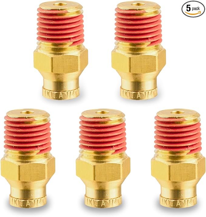

    You could try using genuine DOT fittings instead but I reasoned if I’m switching fittings then fuck it, I’m switching type as well.

    They MUST be cut cleanly, and at a 100% right angle.
    I've got a few to seal over the years. 50/50 shot.

    I have since seen something about DOT fittings that are supposed to be better.

    Getting a perfect cut proved beyond me so I switched to something more reliable and less finicky. Correction, not finicky at all.

    I've got too much $$$ invested in PTC. I really don't to throw that all out and spend more $$$ to go the compression route.

    OK. As suggested, I decided to invest in some DOT fittings and, so far, they are working.
