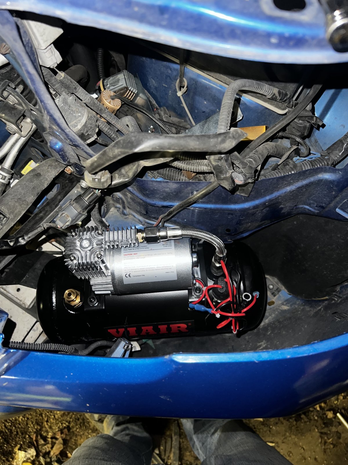

    Idk if anyone has done this with the small compressor tank off Amazon. But I put it in the bumper corner just to run my fire truck horn lol

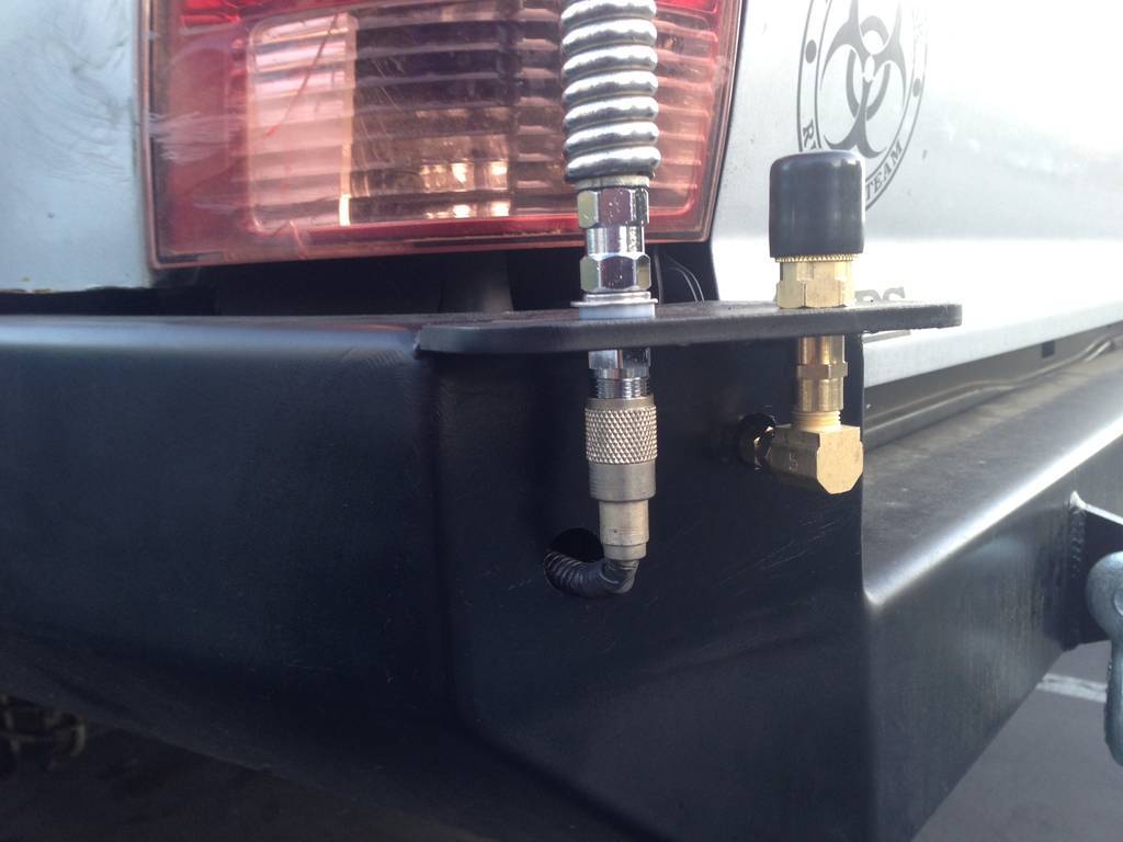

    Finally got around to plumbing my ARB Twin out of the engine bay and into the front bumper, although I still need to get a dust cover for the quick connect. I'll probably relocate the air filters to the cowl at some point, too.

  10. Aug 5, 2024 at 10:48 PM
    #2510
    bagleboy
    bagleboy Well-Known Member
    Aug 5, 2017
    #226018
    7,272
    Scott
    Norcal, Santa Rosa
    2014 5-lug AC 2.7L VVTI
    Snug top Rebel, Thule tracks, ditch tracks, Bagged rear suspension, F/R anytime camera, intermittent wiper switch...
    A rubber chair foot works well

  11. Aug 5, 2024 at 11:15 PM
    #2511
    essjay
    essjay Part-Time Lurker
    Nov 29, 2018
    #274276
    3,321
    Concord, CA
    2011 Tacoma SR5 (V6/AC/4WD)
    Already ordered a four pack and will probably try and make some sort of tether for it with thin wire. That being said, it's odd that nobody seems to make a tethered cap that locks into I/M-type couplers, considering how common they are for A and KV-type couplers.
  12. Aug 5, 2024 at 11:18 PM
    #2512
    bagleboy
    Aug 5, 2017
    #226018
    7,272
    Scott
    Norcal, Santa Rosa
    I thought there was one many pages back but too spendy for me when a diy is so easy.
