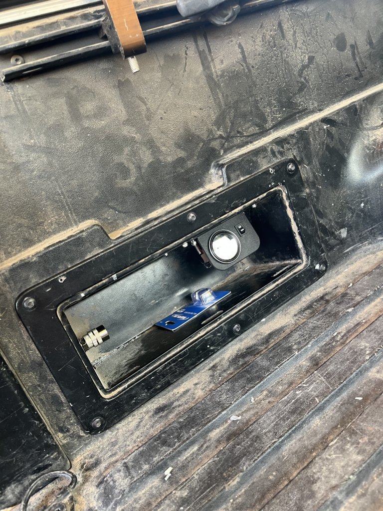

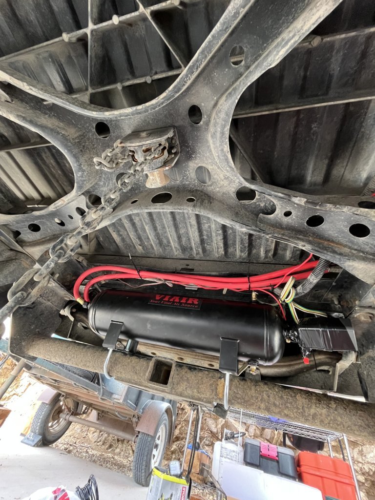

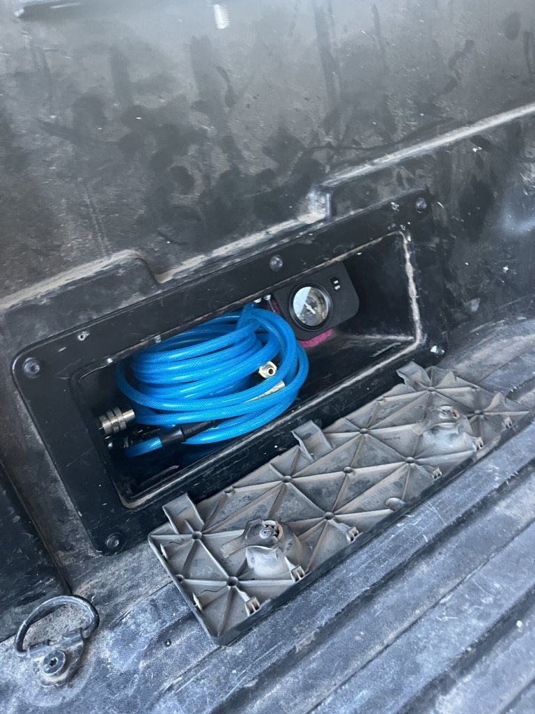

    Just installed an OBA setup, pretty happy with how it turned out. 2.5g tank is sitting on top of my hitch bar fastened with U-bolts, the stock spare still fits in just barely. Have the compressor (Viair 325c) mounted on top of the driver bed cubby so it's hidden out of the way. Have the air lines and wiring running through the tailight area, then mounted a quick connect and the gauge/switch inside the bed cubby. Pretty stoked that everything fit where I wanted it, though the compressor was a pain to get mounted on top of the bed cubby.
