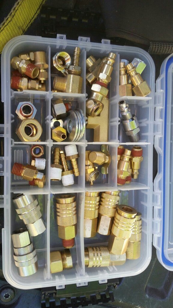

    Been considering getting all stainless braided lines for the setup. There are kits already made for the arb setup for the Jeep plarform. If I could get a 15' 3/8" line, I would be in business. Or hardlines...
    Got a bin like this yet?

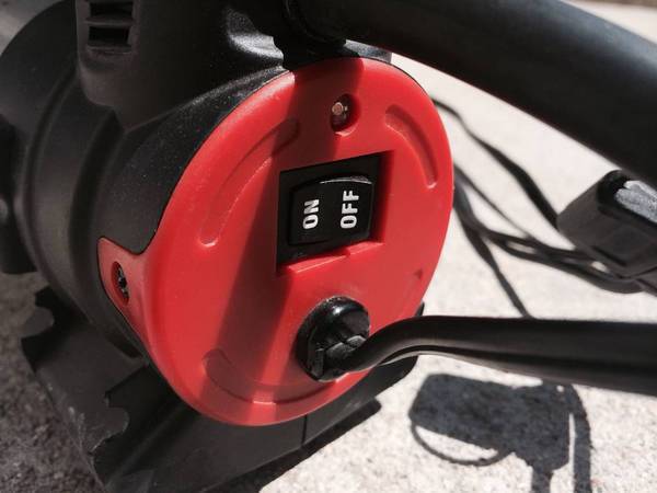

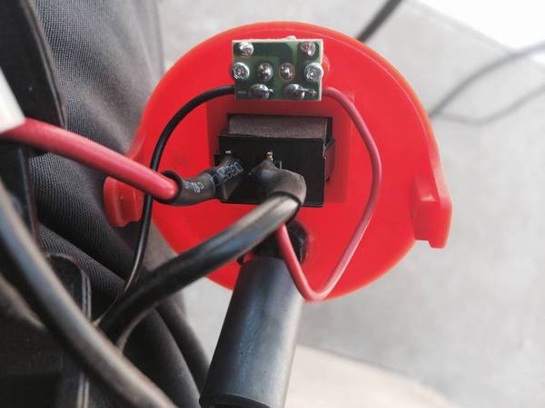

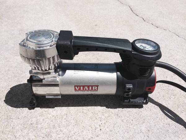

    Ya, you should be able to just add a new switch. If you can bring that one to radio shack they may be able to tell you exactly which one you need. Or if you know the size and specs (may be on the switch) you could just order one online. I doubt Radio Shack would have the exact size and spec switch you would need but you can try or modify to fit the new one.
  15. Jun 18, 2014 at 11:43 AM
    #295
    ian408
    ian408 Well-Known Member
    Nov 8, 2009
    #25619
    19,662
    Ian
    Santa Clara, CA
    09 Tacoma
    Absolutely just get one from Radio Shack.
  16. Jun 18, 2014 at 11:48 AM
    #296
    adriancast
    adriancast Well-Known Member
    May 20, 2013
    #104544
    2,310
    Adrian
    Ontario, Ca
    2005 Tacoma 4x4 TRD Off-Road
    -2.5 Donahoe Coilovers -All Pro Standard Leaf Pack -All Pro U Bolt Flip Kit -Front/RearWheeler Super Bumps -Extended rear Bilstein 5100s -Flowmaster 40 Series -All Pro IFS Skid -All Pro Transmission Skid -Bruteforce Hybrid Bumper -30" Double Row LED bar -400 Watt Anytime -TRD Seat Covers -ABS Kill Switch -Locking Center Console Mod -Rear Differential Breather -BHLM -Anytime Fog Light Mod -Toyota Hilux Snorkel
    thanks guys. weird how the switch just went out. never dropped it. ill just take with me when i go to radio shack.
  17. Jun 18, 2014 at 11:54 AM
    #297
    ian408
    Nov 8, 2009
    #25619
    19,662
    Ian
    Santa Clara, CA
    09 Tacoma
    It happens. They're spring loaded and the spring might just have let go.
  18. Jun 18, 2014 at 11:55 AM
    #298
    adriancast
    May 20, 2013
    #104544
    2,310
    Adrian
    Ontario, Ca
    :mad:
  19. Jun 18, 2014 at 11:59 AM
    #299
    skygear
    skygear                    
    Nov 6, 2011
    #66558
    8,414
    ALso. Contact Viair. They would most likely just send you another switch, OR the whole compressor..
    Any switch would work for sure. Your local auto parts store might even have the same one.
    One last thing. You can OPEN the switch using a sharp knife or small screwdriver and see whats going on in there. Lots of times the small plate that the switch pivots on will come out of place. You simply move the piece back where it was supposed to go and reassemble. The plate in those is normally V shaped. Might want to do that first. Just so you are not wasting money on other things.
  20. Jun 18, 2014 at 12:09 PM
    #300
    adriancast
    May 20, 2013
    #104544
    2,310
    Adrian
    Ontario, Ca
    i did contact. responded once and waiting for another. i told them the same story and they asked when i purchased it. so waiting for reply. just cant stand it not working correctly and want to fix right away even though i don't need it working right this second. haha also, ill open the switch and see what happens.
