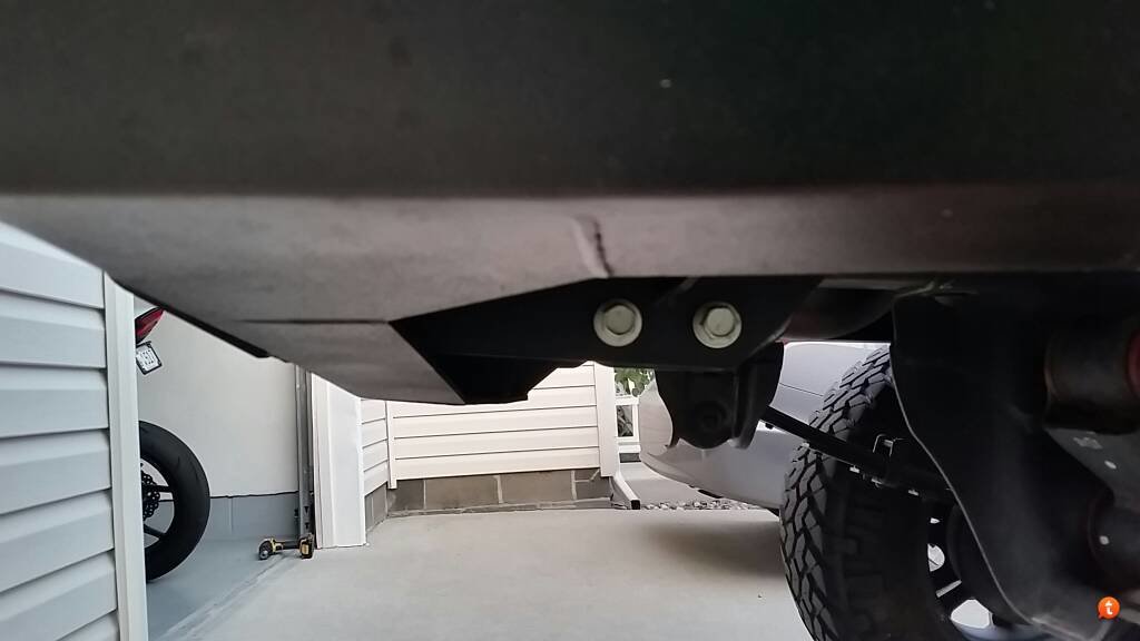

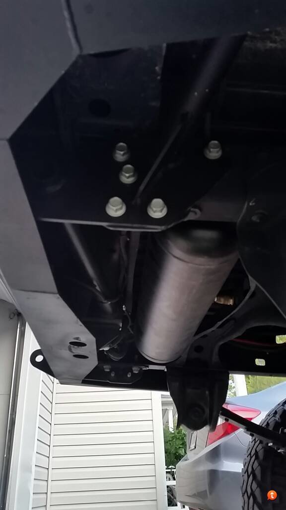

    Just to confirm you can fit a 5 gallon tank under the bed side with a high clearance bumper without any loss of approach angle. :woot:

    I was looking at mounting my tank in that position too. Did you run the bolts through the bed?

    yup bolts are through the bed, easy install for the most part

    Thanks! I was going to use carriage bolts and try to put them in the recessed parts.
