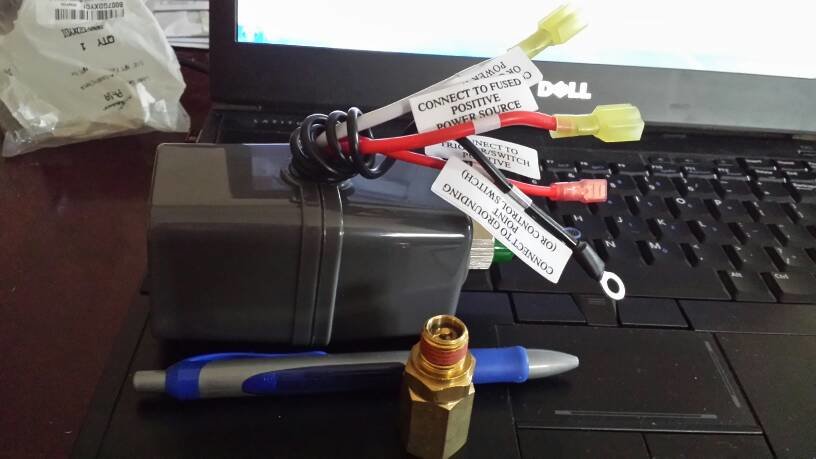

    Which pressure switch should I get. I think I remember reading ARB lockers liked the 85psi one. I don't have lockers yet but want one later. Right now Tire fills is all I will be doing.

    Don't worry about low psi switches. That's what regulators and solenoids are for. Get something similar to what your pump or rated at.

    I wasn't expecting it to be that big

    I cut mine open and disassembled the whole thing. Took the Relay out, and removed the pressure switch.
    Ran wire up to the engine bay to my RFRM, have it relayed and fused in there. Grounded near the compressors.

    I'll probably leave it for now. It Just surprised me.
