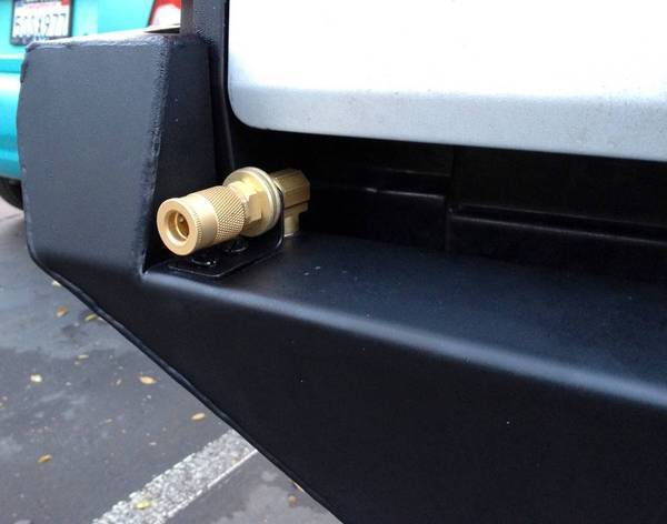

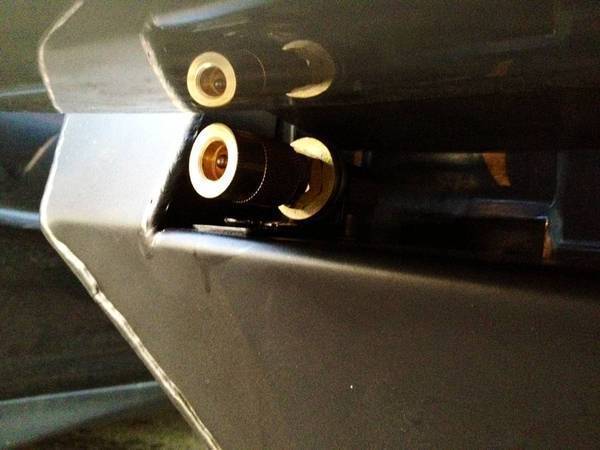

    Just an update on my set up. Switched to a high clearance rear bumper by ATO, so I made a new bracket for the rear coupler and CB antenna mount
    And added another 450c compressor.
    I put it in the tool box, but wanted a breathable barrier for it so I cut up a milk crate and fit it in the space.

    I mounted a coupler on my front All Pro bumper with a home made bracket. Also mounted a coupler on my old AP rear bumper and my current ATO HC bumper (see above)

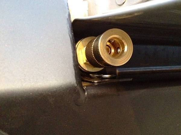

    Sorry BruteForce Fab Plate rear, will come out near licence plate, wanted way to bolt it secure

    My first mount was on top of the AP bumper using a simple L bracket out of aluminum. See below:

    OK think i get it, the washers used as spacers to keep snug?

    Yea exactly
