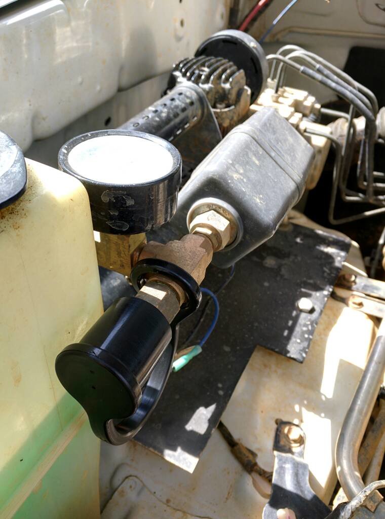

    Does anyone have good leads on a small, 1-2 gallon, air tank? Everything I am seeing starts at $50ish
  18. Aug 14, 2015 at 10:00 AM
    #498
    tan4x4
    tan4x4 Well-Known Member
    Nov 30, 2011
    #67982
    3,807
    Rick
    Folsom, CA
    99 Tacoma EC 4x4 2.7L Auto
    Bilsteins, OME 881's, 3-leaf AAL, Detroit TruTrac, Tundra brake swap, Michelin LTX AT2, Tranny skidplate, TC skidplate, CBI rear bumper, TG sliders, UltraGauge, PowerTank, Reverse Camera
    Need to spend money to get a tank.
    You could make your own smaller tank, using sched-40 PVC. That stuff is supposedly rated to 300psi.
    For the supplies and necessary tools, you'll still be spending at least $30.
    I used PVC for a quart-size tank for my home-made substitute for an ARB compressor.
